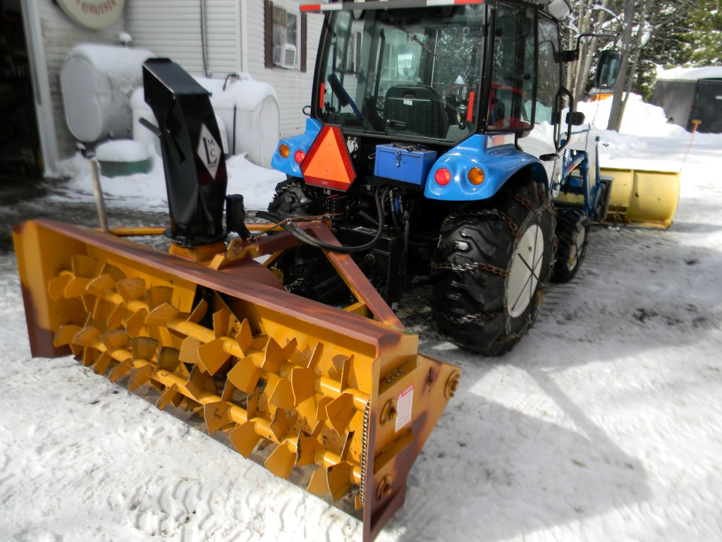

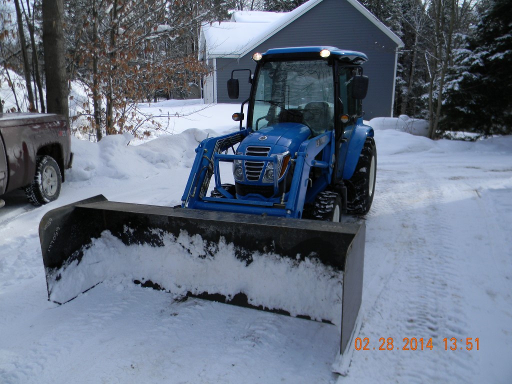

That's what I have now. A 7 1/2' front plow and 7' rear blower.
I had a 7' pusher box and sold it after first few uses. When the pusher box is full of snow I could no longer steer unless I used the steering brakes or raise the loader arms slightly. It always wanted to go straight if the pusher is on the ground.
This is the setup I use, but a little less wide. 7' SSQA blade up front and a 6' blower on the rear. We don't see nearly the amount of snow that the op does. I simply cannot be without my loader bucket being immediately available. Cabs aren't cheap, but plowing / blowing 4+ times a week would make it a requirement imho.

My opinion is to go with a rear blower, and keep your loader of some sort on the front. You get way more lake effect than we do here, so everything is different. Pushing snow leads to piles, and banks on either side of the drive, which leads to drifting closed quickly if you are in the open at all. With a blower you get less banking along driveway edge, thus less drifting closed. And I have a huge shovel on the front of the tractor to scrape, stack, push, or break. That's how it works in my yard.

Thanks for all the replies. While *I* want to go the blade route, based on replies here and my wife (who basically insists on a snow blower), I think I'm going to start out with a snowblower. If budget allows and it seems useful after finishing this winter, I may add a front angle blade for next winter.
As far as traction, I'm getting R1 tires, and having experience with both those and R4's at my last farm, the R1s seem to have good snow traction. The dealer can install carbide studs on the treads if necessary, which they routinely do on R4s but not so much on R1s.
I'm looking at a Woods SB64S since that's what my dealer carries and Woods seems to generally have a great reputation. Any reasons for concern with that model?
