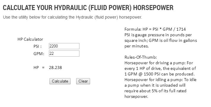

I don't quite understand why he is only getting 25 hp at the blower pto.

Because he is converting rotational energy into hydraulic power, and hasn't sized it all very well.
At 2:40 in the video he gives the specs as: 22GPM @ 2200PSI, using the formula HP = PSI * GPM / 1714 we get ~28hp, minus losses for hoses, heat etc, he's probably right on the mony at 25hp:
He would have been better off to do a "power pac" or "motor on blower" style, and hook the detroit right up to the blower (but then a clutch system would need to be employed, personally I'd use a torque converter in the bellhousing hooked up to a sizeable PTO shaft and call it good):
Here's a handy link for anyone looking to do oil motor powered PTO applications: Horsepower Calculator - Metaris Hydraulics

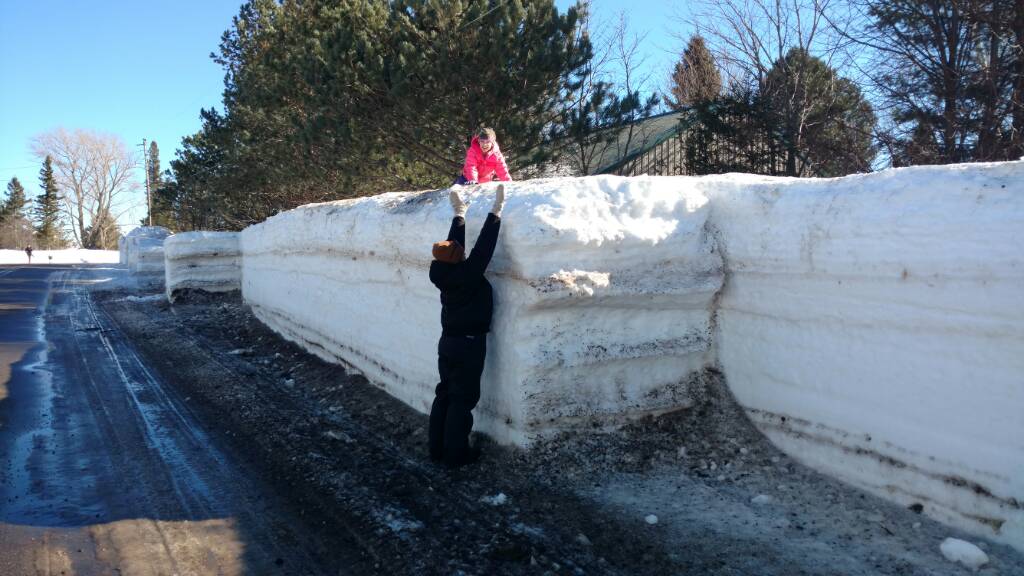

My in-laws driveway. Pushing the snow is not really an option
You can see the different layers of beach sand blown in with the snow. Also, this is a second /vacation home, they are here every weekend, but it gives a week of wind to fill the driveway tunnel.

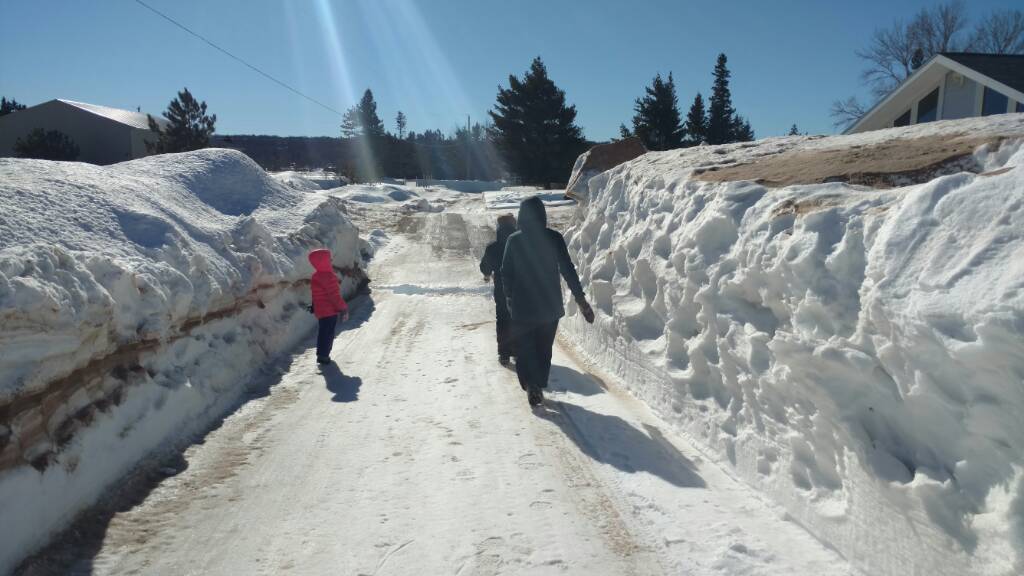

The bank on his road. With my wife and 6 year old for scale.
It is deceiving, because of wind the opposite side of the road the banks are half as tall.
