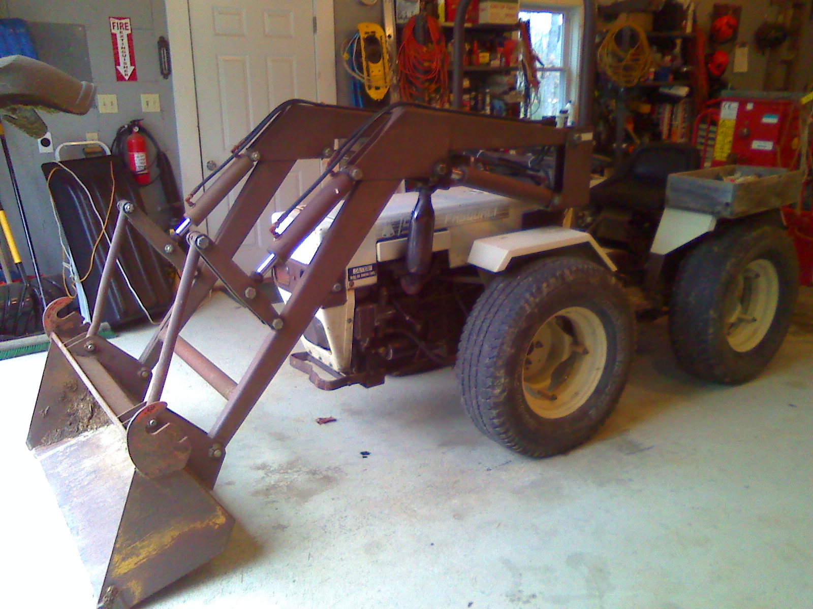

Hi I have a Pasquali tractor with a loader that I want to add a plow to for the winter. I plan on welding mounts inside the bucket to attach the plow to but I don't know how to hook into the hydraulic system to control the plow rams to move the plow angle.

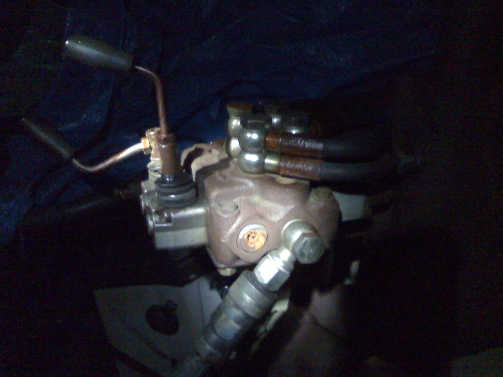

Attached is a picture of the current control valve, on one side it does have a quick disconnect so it almost looks like I could add a single lever control in line with quick disconnects and have hoses with quick disconnects to run up the loader to connect the plow rams to.
My issues are:
Can I simply hook in as I said to this quick disconnect?
WHat to buy for a control valve? Where and model if someone can help with that
Quick disconnects - Ive read a few threads on this and I think the one on here is the AG standard one, but can someone help identify it for me.

I'd suggest considering putting fixed links (or lock/tie down the cyl's) in place of the bucket curl cylinders on your FEL, and then use those hyd lines and control to angle your plow. Put in QC's to make switching back and forth easy to do.
For the single acting angle cyl's, just one line from each cyl. will do. IMO.

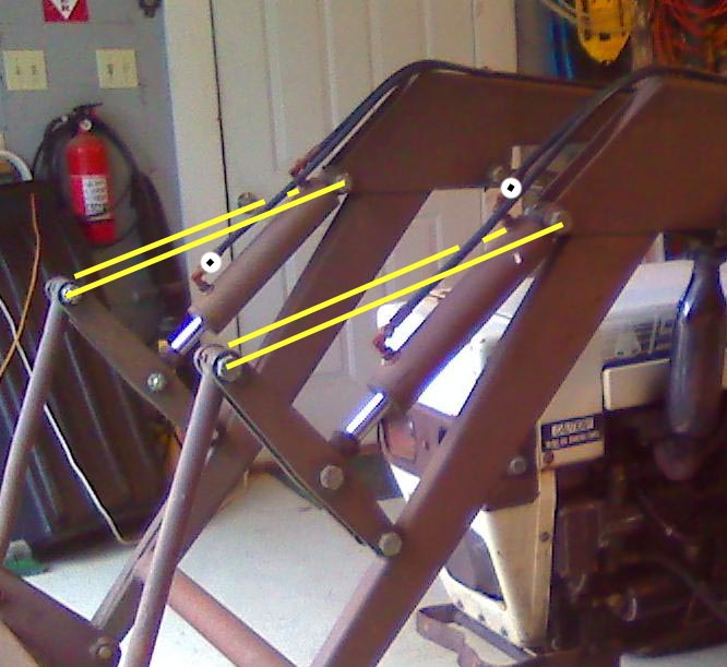

What I'd consider doing if mounting plow to FEL frame.
Find a good position (curl) that will work good with the front plow.
Then, pin steel links (yellow lines in attached pic) to hold that curl position. (won't involve removing the two DA cylinders).
Then, put in quick connects at the far end of one cyl to attach one SA angle cyl, and at the other end of the other cyl to attach the other SA cyl. (shown by white dots with black center in attached photo).
Other quicker ideas for conversion might come up, but this should work. Some simpler design to fix the bucket position to make conversion between bucket and snow plow would be my goal.

Phil, can you please post picture of your valve, and count the number of hoses connected to it? What are the GPM and PSI specs for your tractor? All this is needed before a particular valve can be recommended.
/ Need help adding a hydraulic adjusted plow
#11
Hi Kennyd my first post has a picture of the valve, its a poor one cause its always dark outside now by the time I get home, if you need a better one Ill post one this weekend.
I counted the hoses, there are 10, which of 8 are for the FEL so the other two are feed and return I assume.
I called the dealer (best word for, they dont sell new tractors but resell used and carry parts) for Pasqualis. He could not give me specifics on it but stated when he added them for clients he stated to get valve with a self centering lever and that is open when centered (allow fluid to pass through when not engaging it) and it must have a relief valve (when using valve and ram goes to end fluid will dump back out exit hose)
He said to connect its input to the out port of the existing 2 spool valve assembly and the out port of the new single valve to the return hose to the tank that was taken off of the existing 2 spool valve body.
This sounds in direct contradiction to what ive been reading in threads on this forum, but would be the cheapest, easiest way to do it.
So with that, what is the problem with hooking it up in that manor? What do I risk damaging?
Id be running the plow angle rams so there really wouldnt be alot of pressure on it I wouldnt think.

Need better pictures...10 hoses? It's usually 6 or 7, 4 for the cylinders, 1 FEED or IN, and 1 OUT or T and possibly a PB (power beyond) hose.
OK, I just looked at the picture again...I see that some hoses are stacked on the same port-that explains the 10.
There is more pressure than you think...all the weight from the snow will be trying to collapse the cylinder!
You can hook it up that way in series on the OUT line, it is not recommended but possible if you have no other choices.

That port/plug may very well be for a PB sleeve-but finding the proper one for your valve may be impossible, they are not universal but rather manufacturer specific.
Most valve's are not supposed to see high pressure on the OUT or T ports, when you plumb in a valve downstream, and that valve is activated the the pressure can rise enough in the first valve to cause damage. While it's often talked about here, I have never seen pictures of it. It is always best to use the PB ports whenever possible.
You could add a new PB equipped joystick valve to run the loader, and then use your existing valve as your new "remotes". Kind of the best of both worlds since you would be updating your loader control to a modern joystick style, and you get two extra valves/spools for "free".
