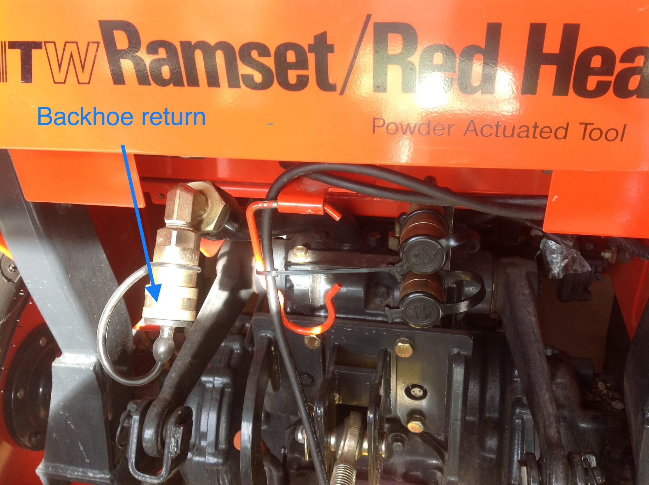

Jeffy,
Not sure if this pertains to the DK series, the CK series had some issues with backhoes putting more heat than normal into the hydro fluid because the backhoe return line was returning through the remote valve. Their solution was to dump the backhoe return right into the hydraulic fluid fill. No restriction to build heat. A kit with a longer tube and QA connector was supplied with the backhoe from Kioti. This is what it looks like on my CK35.
   / Need help attaching backhoe DK55 #14
my ck35 connects to the 2 right connectors and i dont have any heat issues, how do you now top up the hydro fluid with that setup?
