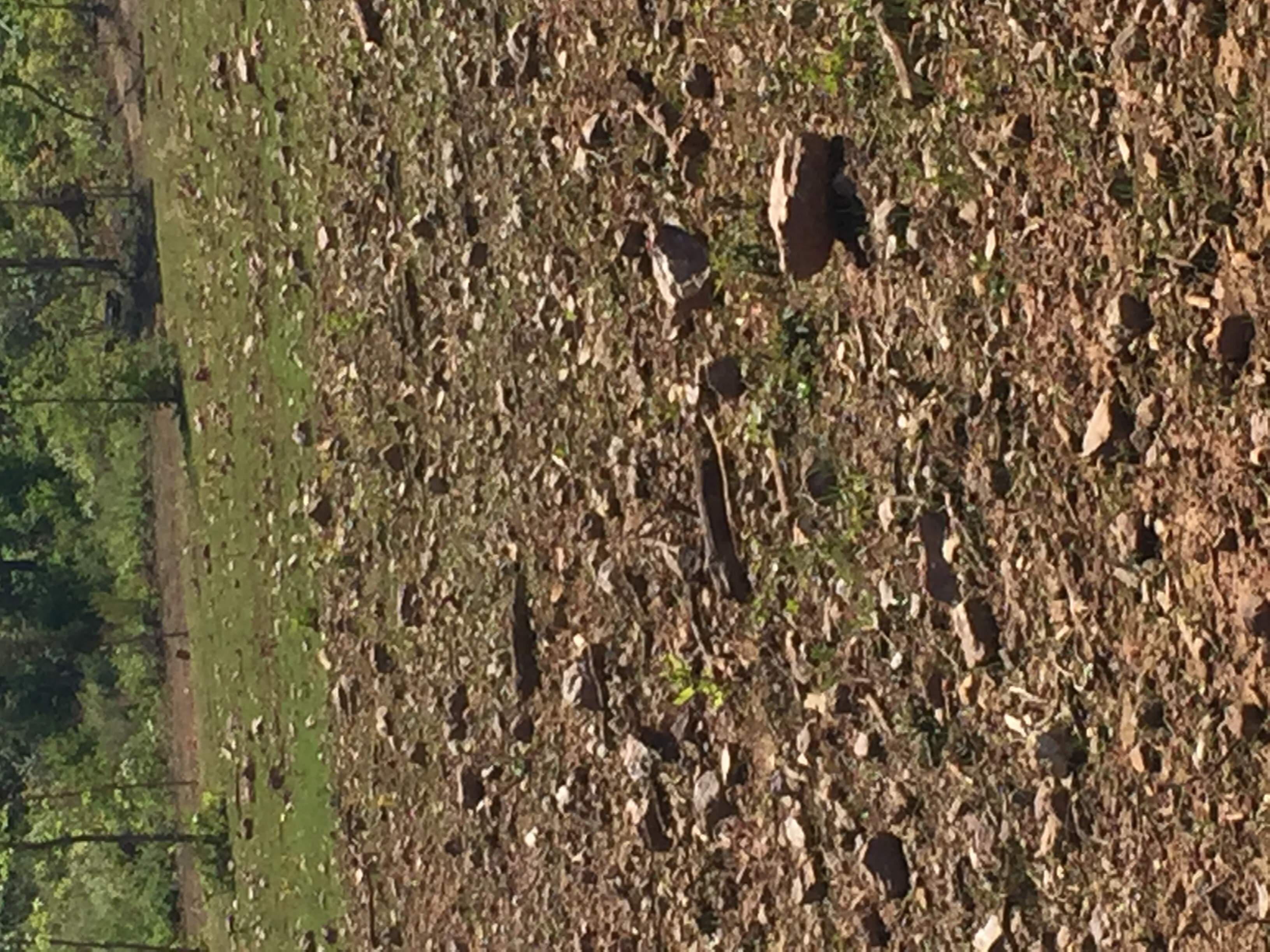

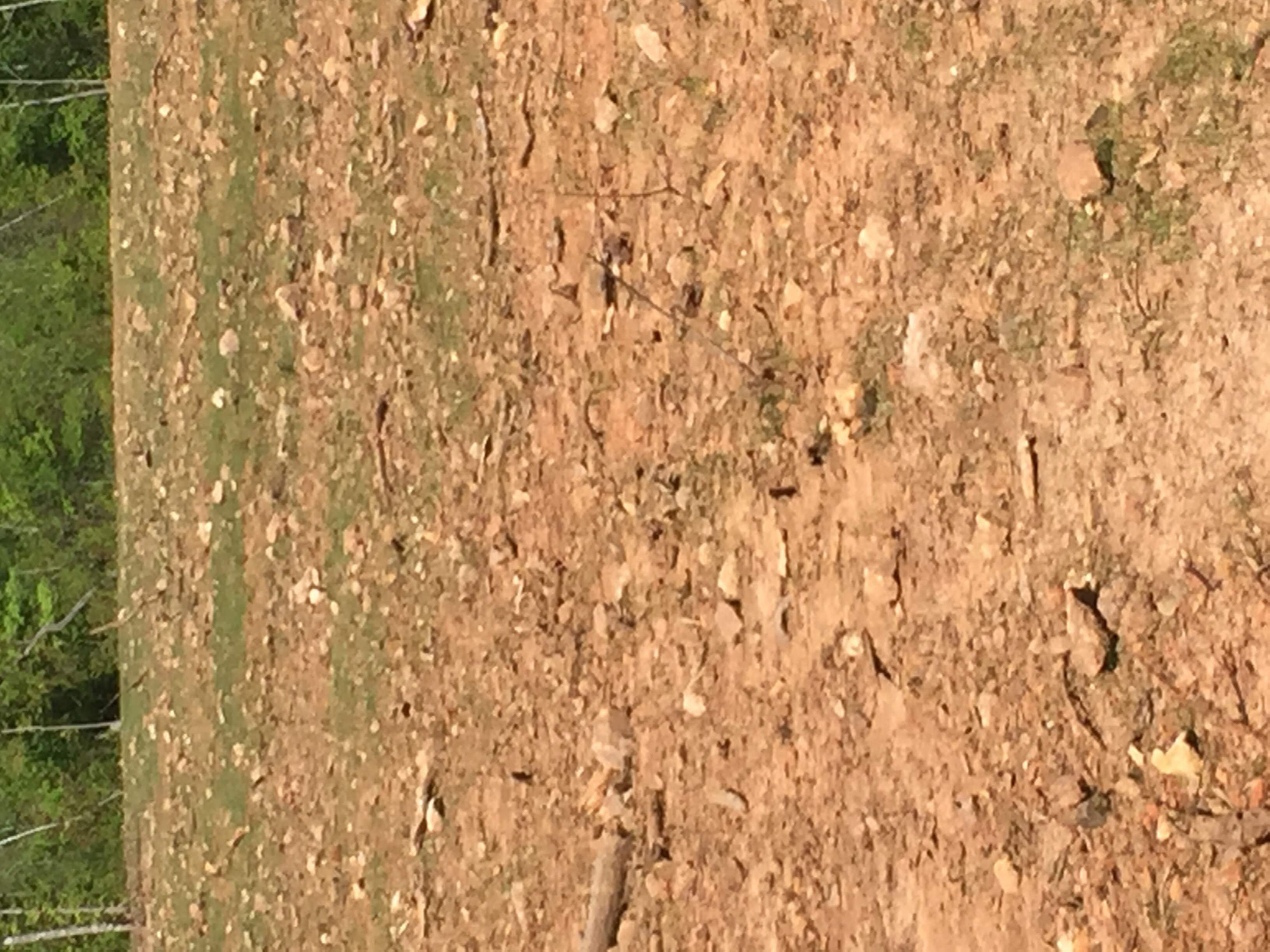

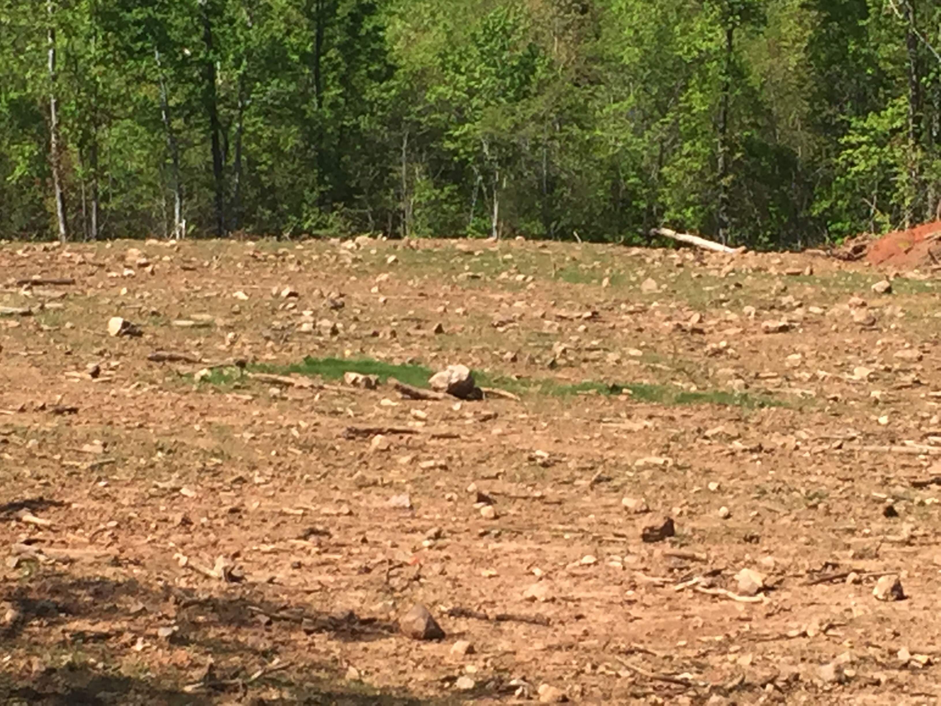

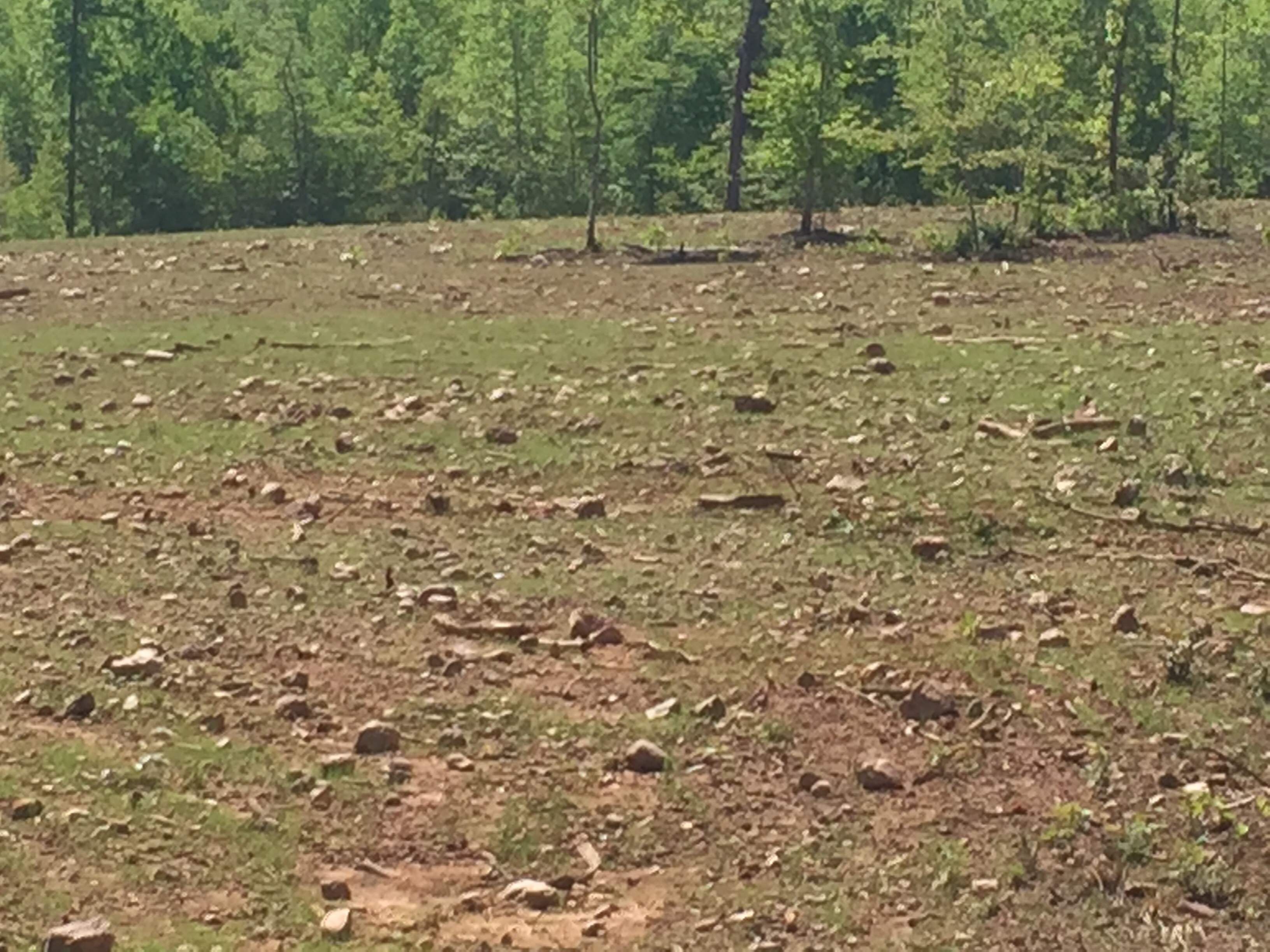

I'll keep it short and to the point. I have about 20 acres of rocks that I need to clean up I was thinking about just using a landscape rake and drag everything into rows ( like raking hay) but I really have no clue how to do this anybody have any advice I posted pic of what my land looks like thanks

I think you will destroy a Landscape Rake in short order.
A solid Rear/Angle blade might do.
Do you have an FEL on your tractor? A GRAPPLE would be the best tool.
And, after windrowing, how are you going to move the concentrated rocks?

I would think the landscape rake would be the best tool to start with. You could rent a Harley rake later. I think a lot of those rocks would be too big for the Harley rake to move.
Gonna be a lot of trips to make the windrows and then scoop the rocks up, but hey isn't that the goal,...to get some seat time on the tractor?

I plan on using a front loader and a dump trailer to move the rocks after I windrow everything up. Yeah it's going to take a lot of seat time and feel like I'm in way over my head but most likely just putting to much thought into a time consuming project

It looks like the moon, I will never complain about the rocks we have again! If I was going to do it, I would use the riper bar teeth on the front of my bucket, using it/them as fingers racking pushing the rocks into piles. I have done it that way, we however don't have the rocks you do, and I already had the ripper bar.

That's going to be some real tonnage! The ones in pictures are just those on top, there are MORE underneath!! ;-) Start with 2 acres, work out a system, then do another section. repeat until you feel done.
Unless you spend real $$$, moving 20 acres of rocks is going to be a lot of time moving material. Close spaced tines (like hay tines) on a front end loader bucket can pick up stones as you drive towards the dumping spot, and letting the soil fall through. (A potato harvester)

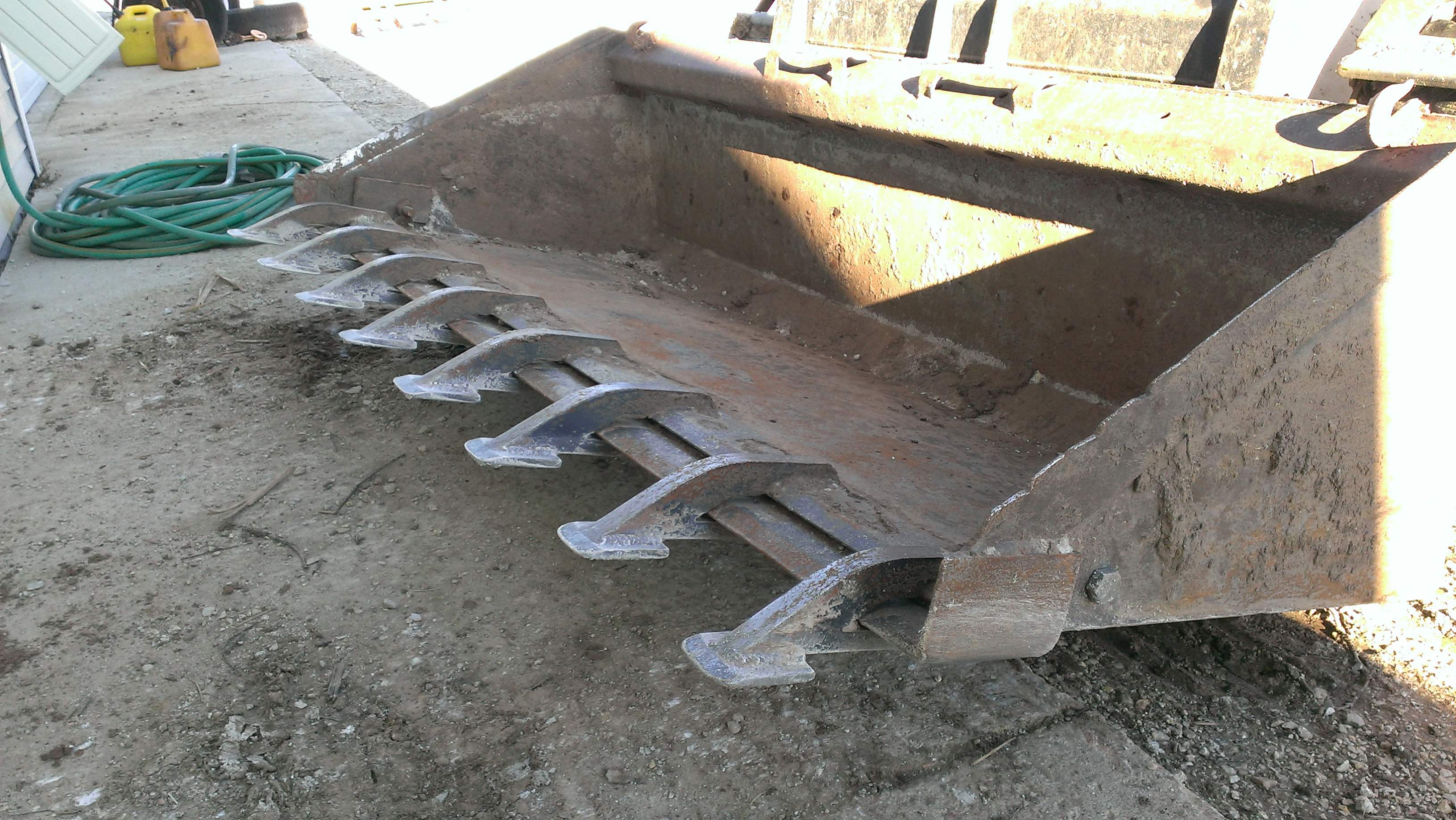

I would start with a rock rakeBradco 66" Skid Steer, Skidsteer, Rock Bucket, 3" Tine Spacing Universal Skid Steer Quick Attach
You can rent them.
Once you get the majority out, then a powered rake (Harley rake, etc.) will do well. I have used one on the skid steer but I do not think I would start with one with as many rocks as you have.

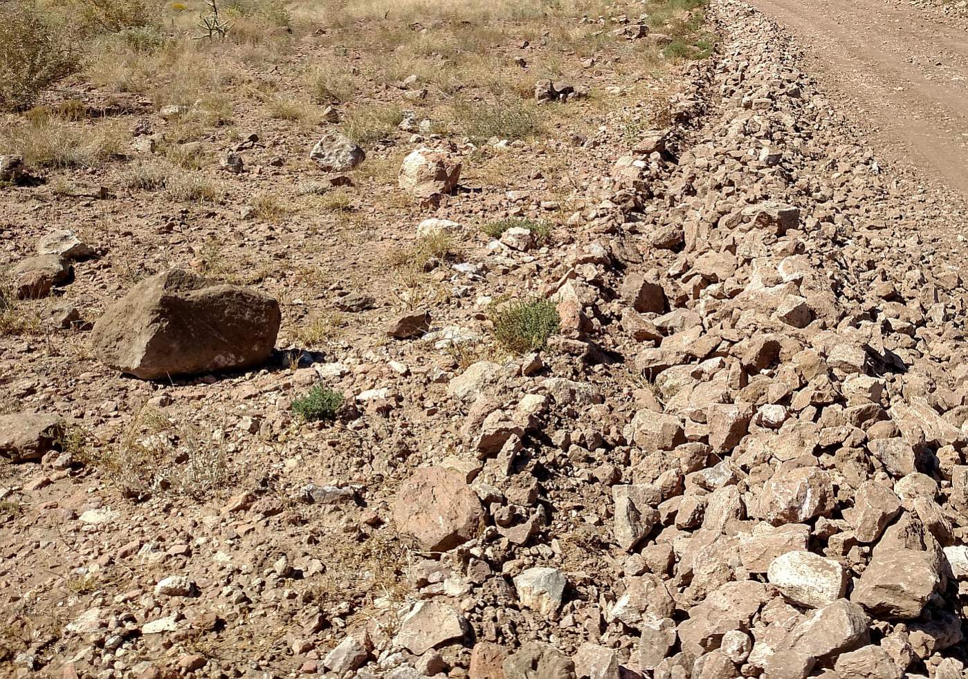

My property is pretty much rocks with a little bit of dirt mixed in. My "driveway" was carved out of the native soil with a dozer and has no gravel or other materials added to it. Just last week I cleaned up where recent rains had brought the rocks up. I used a landscape rake and box blade.
What it looks like after about a week. Don't have a before shot.
Close up of the windrowed rocks at the side of the road. See the lovely boulder.
I used my box blade with the rippers dropped down all the way and the box tipped aggressively forward but not really using the blade itself. After several passes up and down to bring up the top layer of rocks I then walked it and tossed out most of the cantaloupe-sized and larger rocks off. Followed up with the rake set at 45 degrees. As it is only a 72" rake (tractor width 60") it left the windrow right behind the trailing side tire which is why in the picture it isn't quite off the driveway. Getting ready to order a rake with offset capability so that I can push them the rest of the way the next time.
As someone else mentioned if there are that many rocks on top there is at least that many underneath. Turning that into a field suitable for planting doesn't seem realistic to me (if that's what hte OP is thinking) but you could certainly clean up the surface with a rake.
