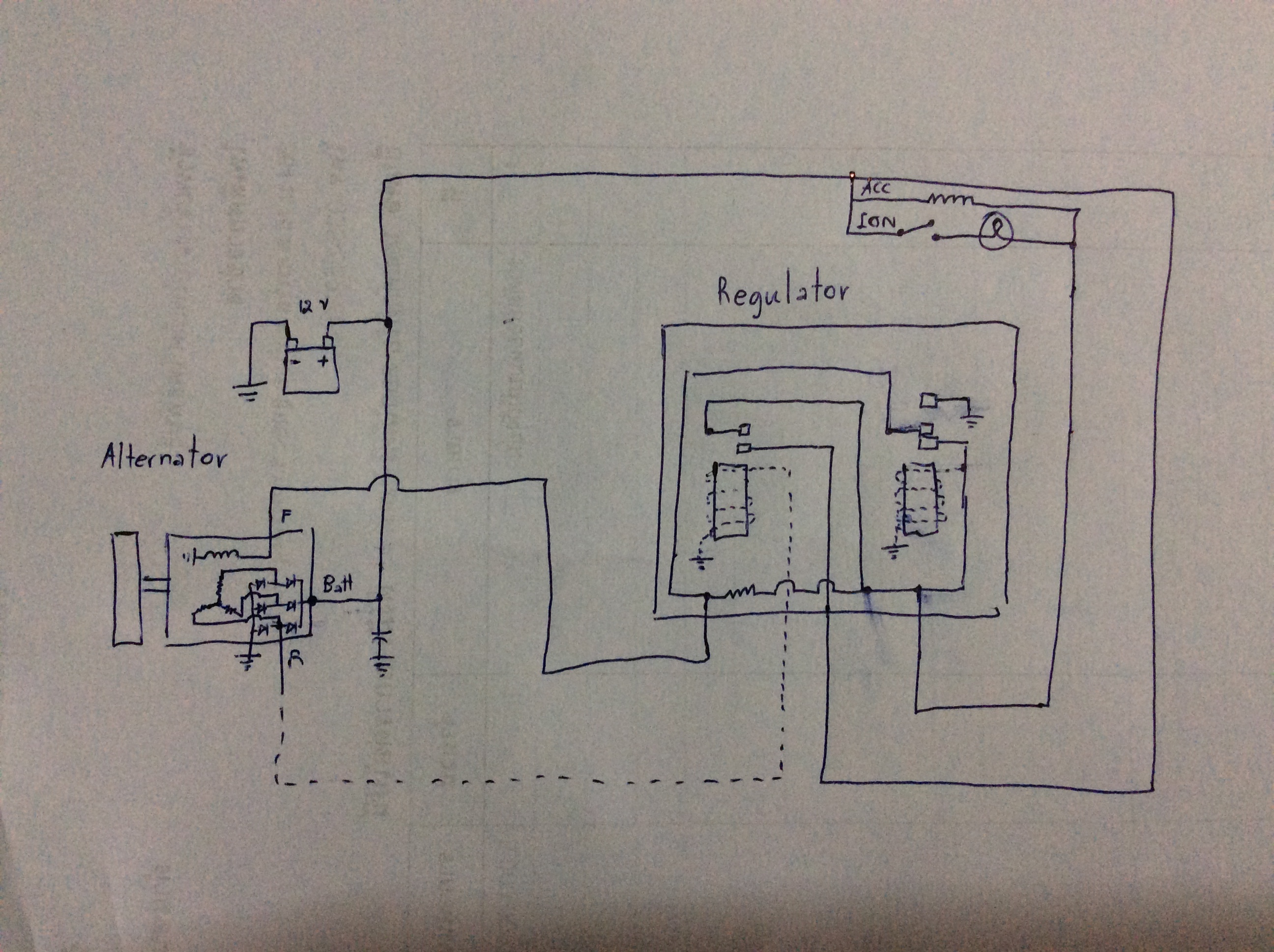

I bought a fuse box of the Jinma tractor. This box includes the voltage regulator. But the pin labels are not very familiar to me. I want to use it on my own machine. Does any one know the pinout of this regulator?
Thank you
I draw a diagram from what I learned from this forum. However, the pin labels that they use are FADE, while my regulator has FNLEB pin labels.

good morning if this was on typical american made charging system the letters would be the following
f- field wire
l- charging light
e- ground
b- would be positive
also is yours 4 pin or 5 pin trying to understand the 'n' in the middle let us know how many pins also does the replacement plug in or solder to alternator
/ Need help: external regulator wiring
Thank you for your reply. This regulator has 5 pins. It is pluged in the fuse box shown in the picture. All the 5 pins are in used as I has checked the PCB inside the fuse box.
