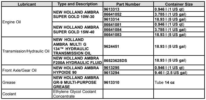

Here is the fluids that are recommended for this tractor in question

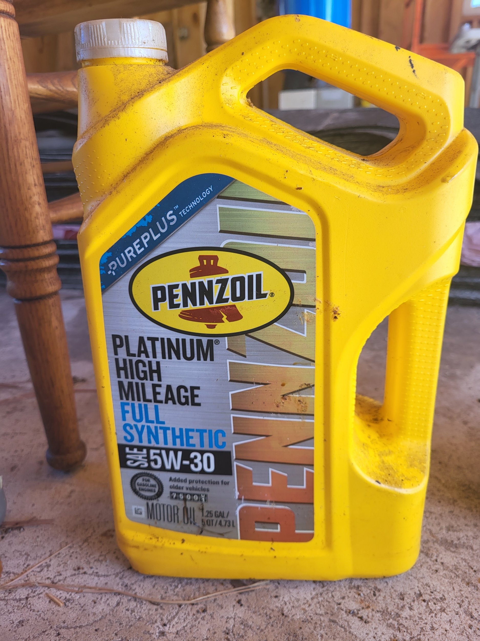

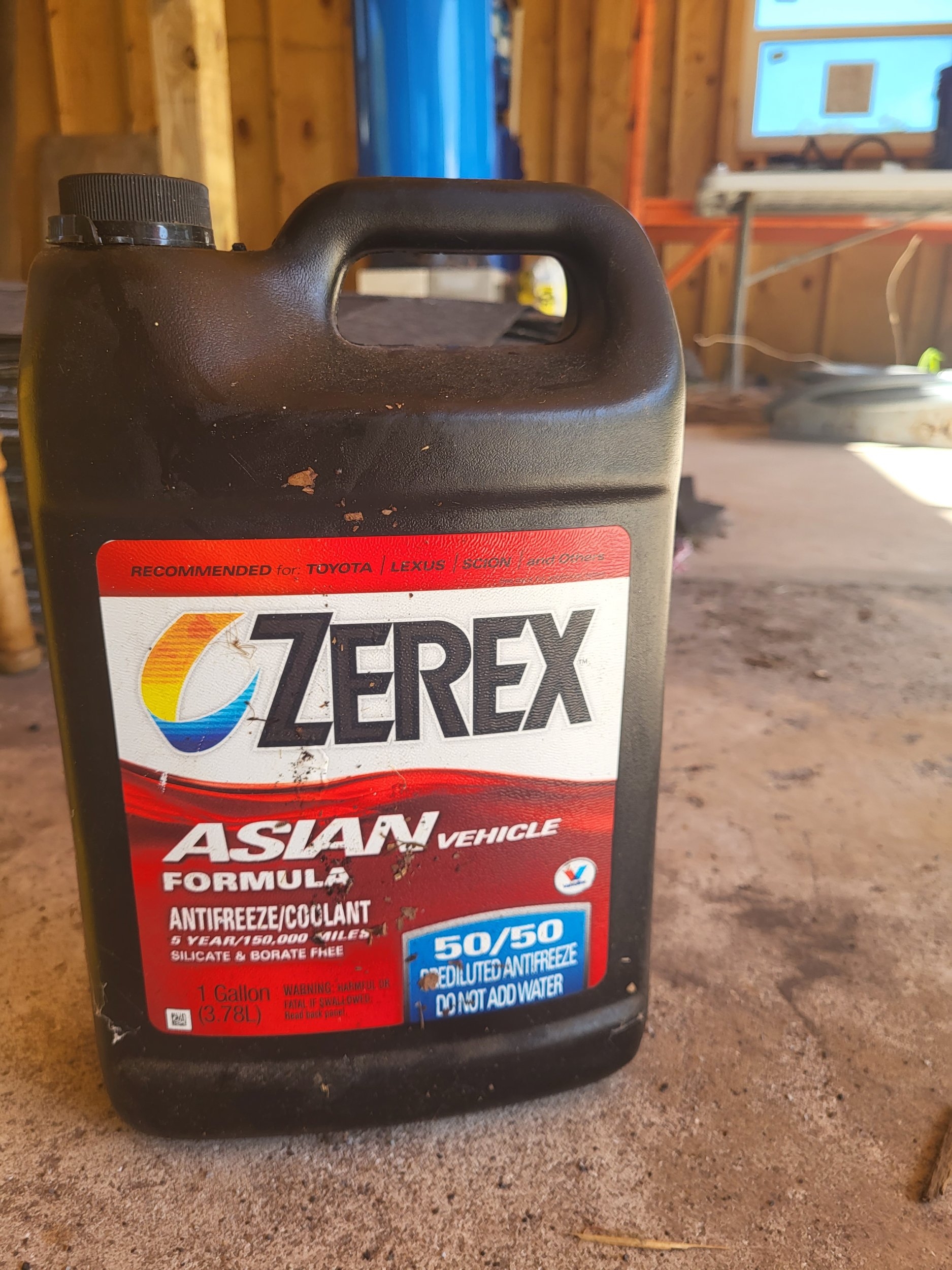

Actually I looked around and was only able to find these, which I'm relatively sure are not any of the correct oil's , but I'm not positive on the coolant... I read that it would take a 50/50 mixture coolant but I am not sure if this is the correct one, I assumed that it is not because it says it's for Asian vehicles and not tractors
also, the oils are not the correct sae, I'm hoping he didn't use any of those! I'm assuming he didn't.

This is what I'm leaning towards doing, In which case I'd still be looking for info on which fluids to look for when I go to purchase... I only ask because I see that as far as the oil is concerned that it says there are 2 possibles

First of all - What climate are you in? North Alaska, Hawaii?
Most oils mix fairly well.
But cold climates can do with a llighter weight oil for starting in the winter.
Not so with anti-freeze.
If the plans are to keep the tractor you might want check the antifreeze color. Or just plan on draining, flushing and replacing. In general if you mix green and orange antifreeze they can form a thick, jelly-like substance that can completely stop all coolant flow which can lead to overheating.
For engine oil, a CK rated diesel oil is what you want. It's backward compatible to whatever API rating your manual specifies. You have more flexibility in the viscosity ratings than what the manufacturer is specifying. Depending upon your location and weather, you could use 0w-30 though 0w40 or anything in between (ie: 5w30, 10w30, 5w40, 10w40, 15w40).
I live in a somewhat moderate climate with winter temps occasionally in the single digits. My preference is 0w40 full synthetic. The API diesel rating is important.
There is a wide range of coolants that you can use. The manufacturer's specification of ethylene glycol is a very broad stroke, as almost all coolant chemistries are ethylene glycol based. My personal choice is Zerex G05, which is a hybrid organic acid coolant with a 5 year change interval.

My oil preferences are for a 5W-40 synthetic with a CK rating.
As far as anti freeze it is hard to standardize on one if you have newer vehicles around as many of them are quite specific as to what to use.
I would not recommend mixing anti freezes it can cause problems, draining and flushing is likely to be your best bet.
However you could open the cap and look in the radiator if it's green coolant then you could likely safely add more 50/50 mixed old fashioned green. The freeze protection should be checked any ways, the freeze protection also doubles as an anti boil over protection also.

We are in Florida.
And I've actually learned today that the family plans to sell the tractor.
With that being said, I'd like to get it filled up with the proper coolant and I believe it should actually be OK on oil for now..
