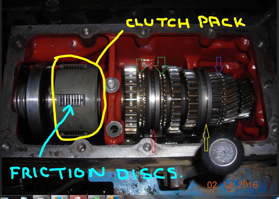

Your picture shows only the gearbox, not the shafts going in or out, so I cannot see. But my first thought is that the clutch pack is for the (hydraulic) PTO.
Do you have a (PTO) shaft inside the (drive) shaft for the PTO on the engine side?
If you have the tractor split, you could turn the shafts by hand and see what happens. If the tractor is not split, you could have some one turn the engine by hand, end see what happens in the gearbox. (try "in gear" and try in neutral) If the gears don't turn, its a clutch problem.
Make sure the gears and the gears shifter are in neutral before assembling, and test.
The clutch pack discoloring is from the welding or heat treatment in the factory, I think.
Did you get it fixed already?

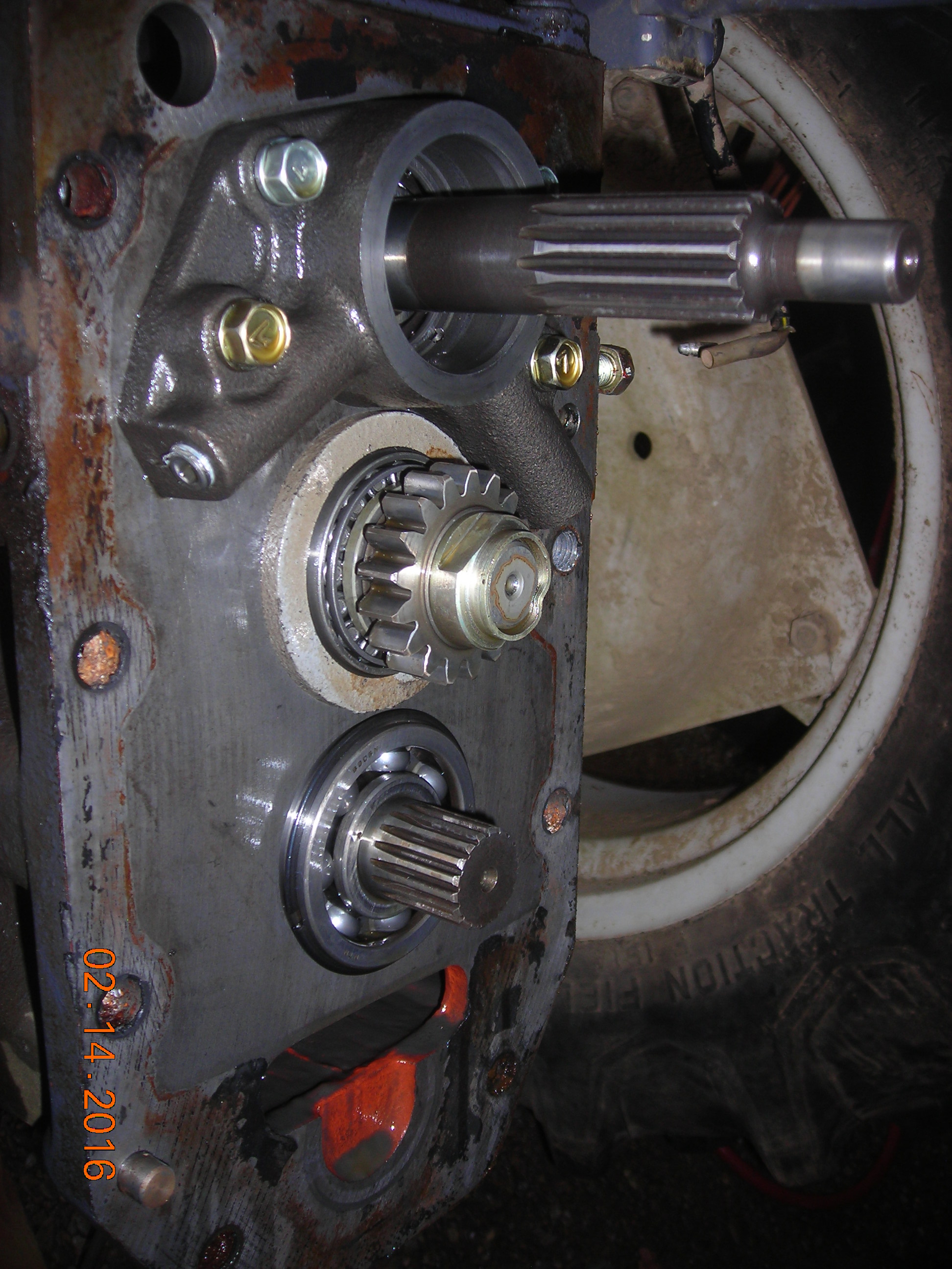

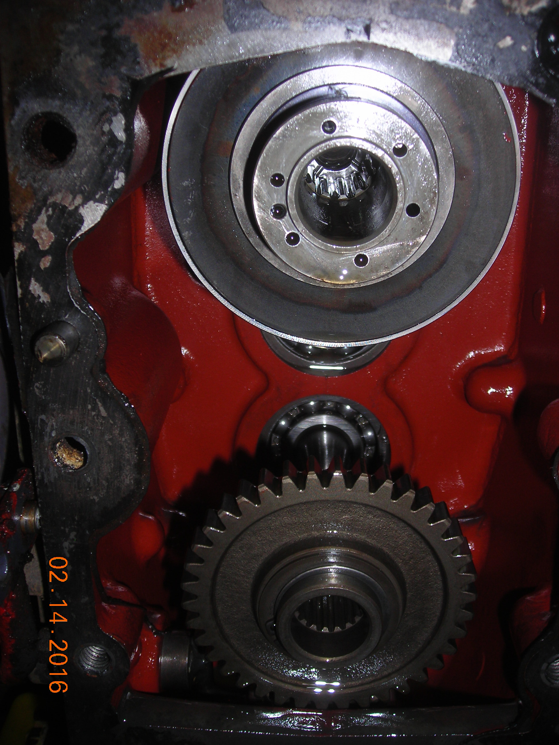

I have attached a few pics that shows the shafts etc. I do have the tractor split and have turned the shafts by hand as explained in my first post. I am still working on it tractor 010.JPGtractor 012.JPG

We have all been trying to figure out the clutch pack and what it does. BertZegers comment: But my first thought is that the clutch pack is for the (hydraulic) PTO. This makes a lot of sense particularly when the owner says the pto works as it should!

It seems many agree that the problem lies with the simple original clutch. I blew up the latest photos from the owner and think I see a problem with the splines on the clutch disk but I am not certain what I am looking at is actually part of the main clutch so perhaps this can be clarified. The splines look damaged and perhaps BanjoDunn is correct in saying the clutch disk may not be the correct fit for the transmission shaft splines and the shaft is spinning within the clutch disk. I am not certain and others should weight in.
My suggestion to Reddog5175 is for him to disassemble the main clutch and try sliding the clutch disk unto the transmission shaft I marked with a red arrow to see if they lock together.
Take photos as you disassemble the clutch so we can see the orientation of the clutch disk and also are there any no transport bolts or clips as suggested by Banjodunn which are preventing the clutch pressure plate from squeezing the clutch disk to the flywheel.

Looking at the pictures makes me think you split the tractor at the gearbox / rear end. Most of us don't know your tractor. A picture that shows the split tractor would help.
If you have the tractor split, (at the clutch housing) than you could put your old clutch plate on the "in" shaft of the gearbox. Then turn the clutch plate with gearbox in neutral (clutch plate should turn free) than test with gearbox in low gear (tractor should want to move). If so, the problem is not your gearbox or rear end but your clutch assembly.

The pressures required to operate the clutch pack will be much higher than compressed air.
Do you have an owner's manual for your tractor which would provide a clue as to the purpose of the clutch pack.
I had asked before if you had a shuttle shift but you did not answer.
Dave M7040
I used to own and operate a automotive transmission shop years back. Clutch packs like this were always tested with air to assure proper operation. Hit them with 100# of air and they will slam back and forth. Now 100# isn't enough to make them lock up under normal operation, but is enough for testing.
   / Need help fixing my tractor #29
My 100 HP Case power shift operates at 120 psi, although they are a different style clutch than this, I'm sure 90 psi air would tell you
if it was working or not. A big air leak would indicate a blown seal.
