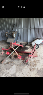

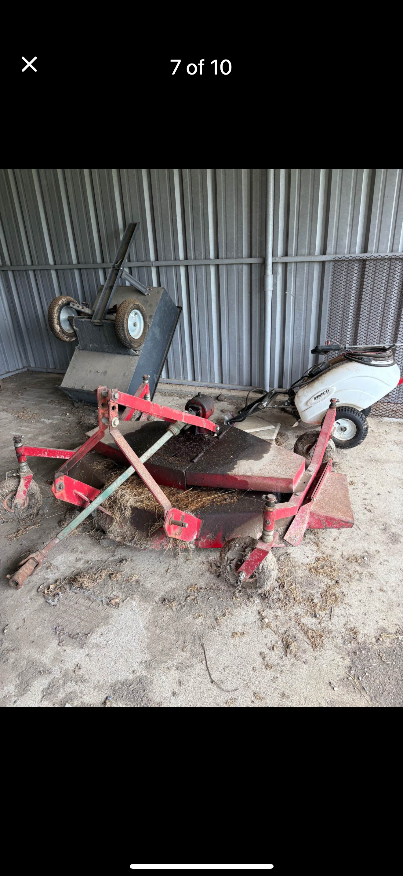

First post but long long time lurker. I want to ID this mower so I can see what I have.there are no markings what so ever. It has a left side discharge but cuts good so a little strange to me.
Anybody ever seen one of theses?

Well after looking more at it oil is last of my concern it’s a ccw rotation

That's interesting. I never put the left side discharge together with "backwards" rotation.
found some ccw blades for it going to try that. but cw rotation from tractor = ccw blade rotation and blade bolt is left hand thread. But there is not a single shred of info on it not even the gearbox, So im shooting from the hip here

Mower shows hints of being Rhino. And yes they made left hand discharge. I have a FM72 with left discharge, left hand blades, and left handed blade bolts.

Drive shaft is assembled wrong: Out of phase U-joints..
Plus: it's either a front mower using a 3pt type mount, or it's been mounted backwards. The 'front?' of the deck is not open to uncut grass. Si I'd say its intended as a front mount. Some tractors offer a front 3 pt type hitch setup.

BEFCO Cyclone C50-RD7 front mower.
