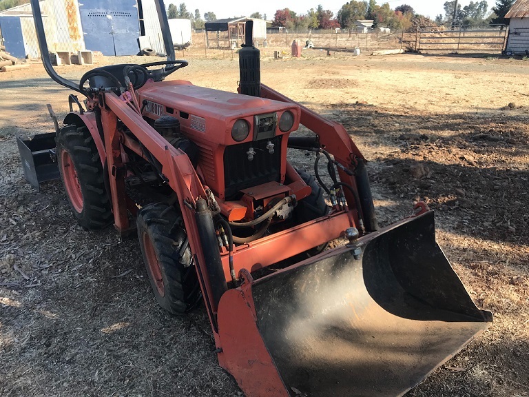

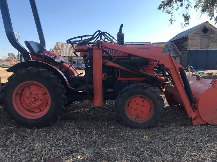

I need to rebuild a lift cylinder on my loader on a B6100 tractor. Local dealer says that until I can give him a model number for loader he cannot help me getting a rebuild kit. I have cleaned it, search high and low but find no indication of what model it is. If someone recognizes this loader or can give me an idea how to research it, I would appreciate it.
Thank you
Jenn

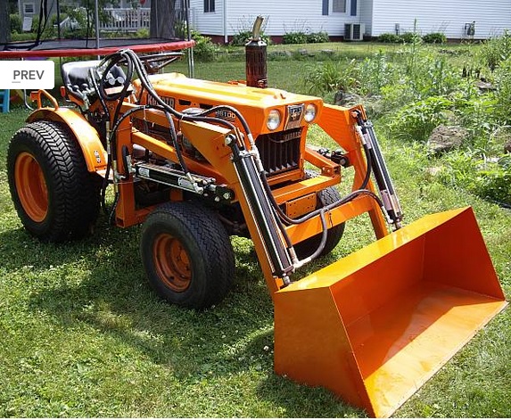

It took me a little while to realize the loader arm cylinder has been removed.
Kubota, like many tractor manufacturers, often had independent machinery manufacturers build implements like loaders for them and paint them orange.
This practice continues today for snow blowers.
Rather than work through a Kubota dealer, I suggest you contact local hydraulic repair facilities to see if any could rebuild your cylinders.
The B6100's I see on line have replaced their loader cylinders with new ones.
Dave M7040

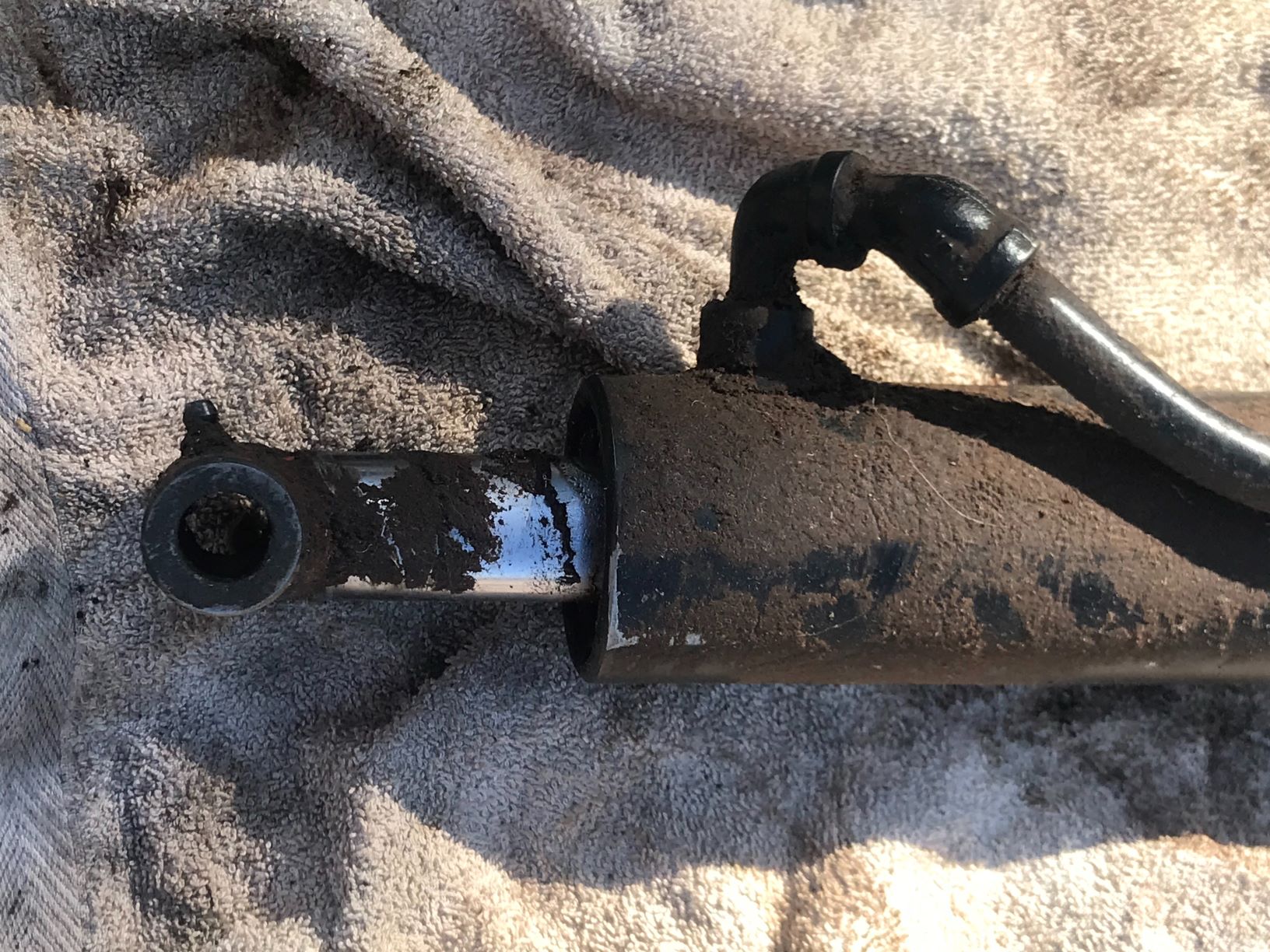

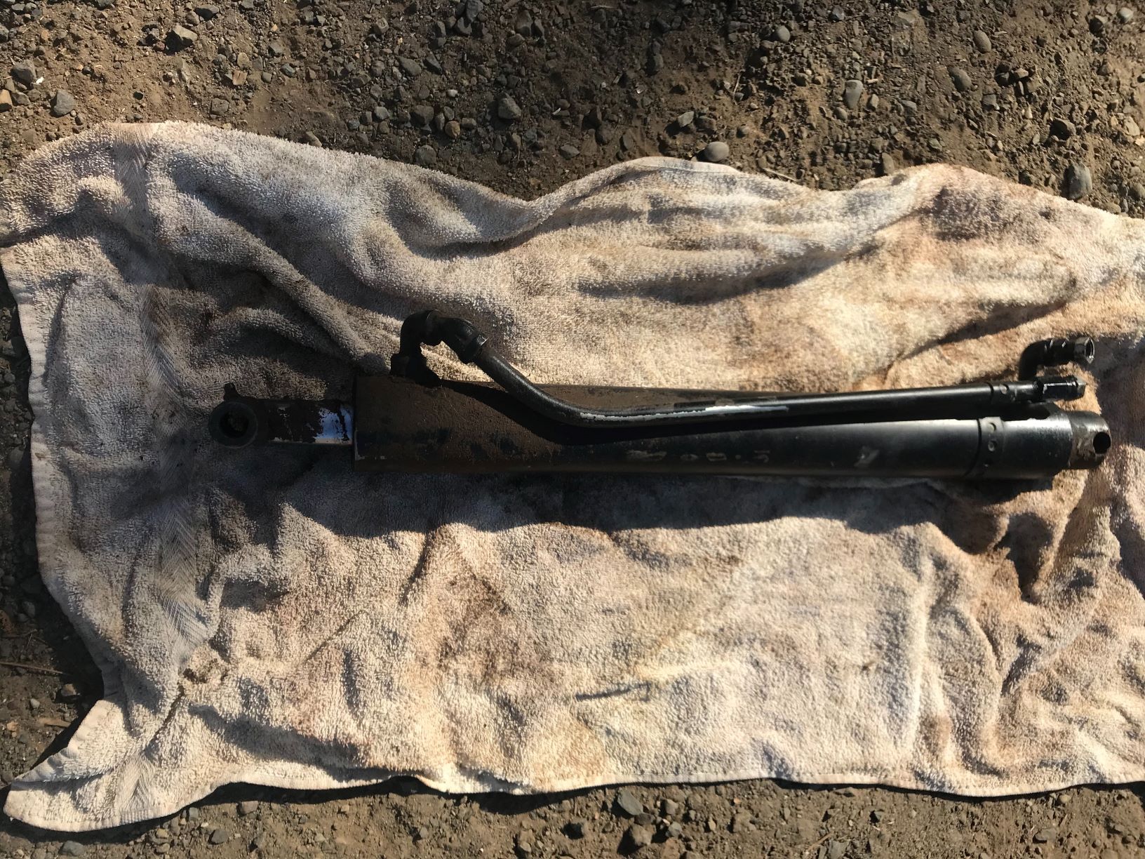

/ Need help identifying loader model on B6100
Here are some details:
retracted length: 23"
extended length: 33 1/2"
shaft dia: 1 1/8"
First photo: floating, bucket end
Second photo: end fixed to loader frame
Third photo: complete cylinder
Thank you
Jenn
