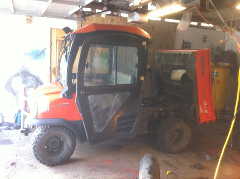

Blackplague said:
Its the kubota fluid, theres still a gallon of it left over. Im gonna have to drop it off because im over it.
Heres a pic, dealer says there 20-30 say behind... I guess im tearing to it my self
   / NEED HELP PLEASE! KUBOTA RTV 900 BAD TRANNY ?
#25
Im going to take transmission out to night in hopes of finding out why i cant get it into rev or low. I hope fixes it. Ill take pics of what i find or dont.
#26
SOME good news, The tranny not shifting was due to the guy not adjusting the cables right, 2 hours later i have all gears.. BUT its still very weak like it has no pump pressure. Where is the screw to turn the pump up a little? I remember seeing the thread but cannot seem to find it now.
