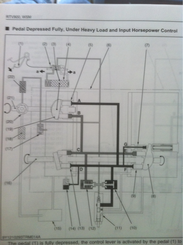

Im going in deep... Ill take some pics of what i find.
These hydro units operate via a lift (charge) pump just like you cars engine.
It feeds 100psi oil to the main pump.
As you give it throttle the charge pump feeds oil through ports to the servo piston.
It moves back and forth respectly depending on how much pressure is applied and directs the pressure to eather the drain or angles the plate so the high pressure pump starts displacing fluid in the form of pressure. That pressure from the high pressure pump gos to the piston pump motor # 1 and gets things turning... Now when there is heavy throttle and heavy load theres a back up ( assist ) motor that has its swash plate rotated via pressure flow from the regulator valve witch in returns gives it a extra motor....
During normal use this pump is at stand by and just going along for rhe ride..
This is the basics of how this works.
This is a very simple process on paper and understanding. However there is appx 11 different things that can go wrong to stop any or all of this from working corectly..
If ANYONE would like a picture or a copy of any page of this manual feel free to post up and ill get it.

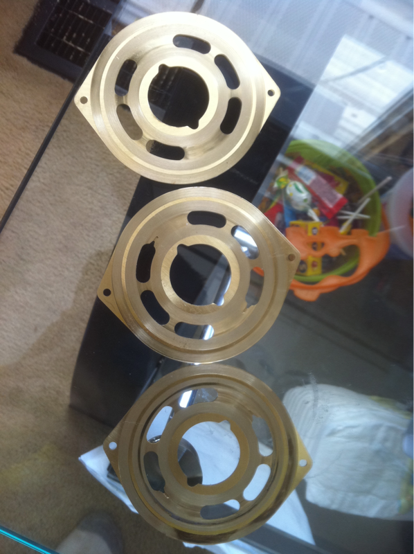

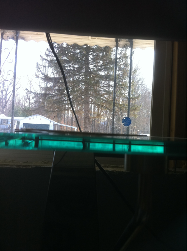

#48
Heres another shot at how warped it is..
One pic is of the pump plate on a glass table laying on its side.. its warped enough to slide a quarter under the sides of it with out touching the plate its self.
The pump and motors dont have very much pressure against these plates so they wont flatten out as you would think. if bent warped exc they just pump the fluid every where it goes with least resistance (not motors for sure)
I assume this has been a issue with this unit for a long time.. With out being able to direct fluid flow corectly im sure made the plate and pump cavitate witch caused hot spots as you see and warped it.
As you can see the motor plates have some wear also, though not bad ill still be replacing all three. There kinda pricy for what they are. 126.00. But thats ok..
Some units ive rebuilt didnt have plates but the pumps mated directly to the plate. If it gets scored or warped in any way it was a 1000.00 bucks and up... I do thank kubota for that one in the sense this is not your typical throw away unit.
I will have my parts tuesday so ill put it back together and i bet it works... There is no doubt that pump plate was 100% of the issue.
