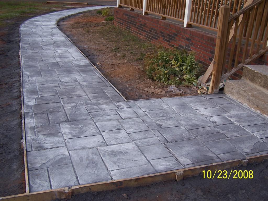

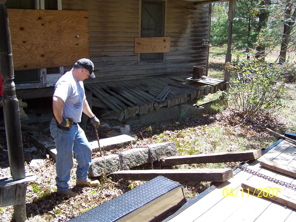

I recycled old granite steps from another farm we have, 5'x10"x8"...heavy:laughing:. Unfortunitly mine were uneven on the bottom so I had to pour a footing and set the fist step on a bed of mortar, let it setup, fill in behind it then set the next step. Moved them in place with the forks on the tractor and use a crowbar to position. This was before the sidewalk was put in so I had to allow for the thickness of the sidewalk. I don't have a good picture of the finished work but you can see part of the steps in the picture.
