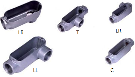

If you used a 90 degree LB you aren't going to pull anything around that and probably damage what's there. Is this what you used?
That's what I wanted to use, and that's what I should have used, but I didn't have a pair of 'em on hand so that's not what I used. :banghead:
They're on the shopping list for Thursday, though.

Why not replace your square 90 degree elbows with sweepers while you,re in there, just in case you ever want to put anything else in that same pipe, along with a pull line ?
Good idea. That shopping list is getting longer. :laughing:

I was always told that you can't use more than 360 degrees of bends before you can't pull a wire through a conduit. I've found that 270 gets tough. If you have four 90's, that's 360. Doesn't matter if you add sweeps or not, its not going to be easy to pull if the total degrees of bends gets over 270 and near 360. Better to add a box every 270 degrees and use these types of fittings on the ends going into and out of buildings.
