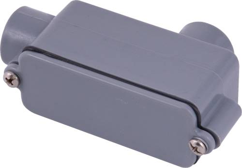

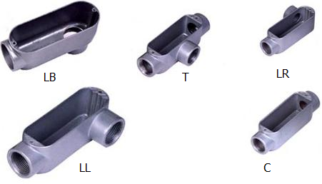

If you used a 90 degree LB you aren't going to pull anything around that and probably damage what's there. Is this what you used?
   / Need Help w/Conduit & Pulling Cable
#23
That's what I wanted to use, and that's what I should have used, but I didn't have a pair of 'em on hand so that's not what I used. :banghead:
They're on the shopping list for Thursday, though.

Why not replace your square 90 degree elbows with sweepers while you,re in there, just in case you ever want to put anything else in that same pipe, along with a pull line ?
#25
Good idea. That shopping list is getting longer. :laughing:
