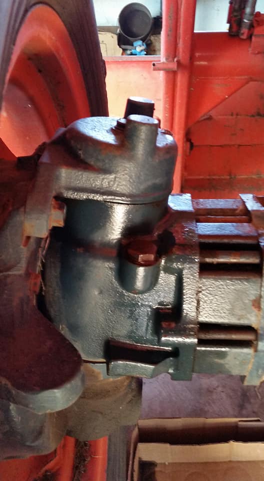

I have a ? in regards to this seal "A" in one of the cut out views posted on my L4150. According to my dealer and the serial number of my tractor, seal is just a o-ring. Part number 150 in attached. My question is can you replace this seal from the top or does everything have to go out the bottom?

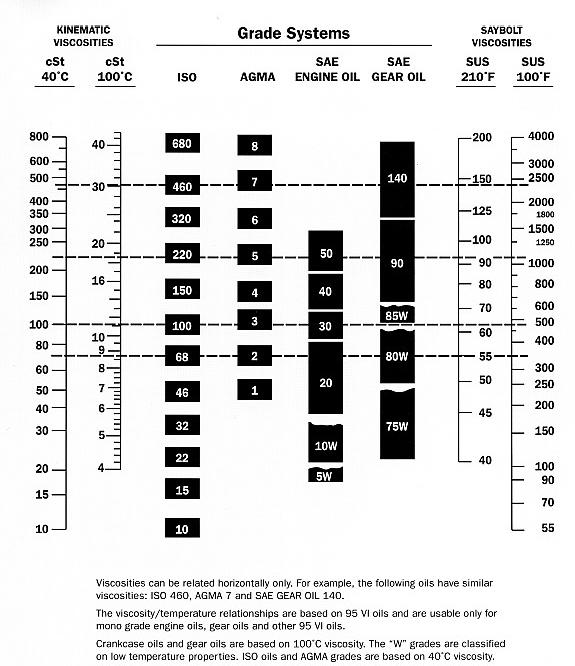

Gear oil, is not measured on the same scale as hydraulic transmission oil, and motor oil.
80-90w Gear oil, is actually light weight oil. Viscosity varies widely by brand. But, most are about the same viscosity as 40w motor oil. Most hydraulic transmission oil is about 30w.
Kubota SUDT is on the thin side, so you would gain some viscosity with 80w-90. But, it's not a big difference. Don't expect 80-90w to solve any leakage problems.
140w is the heavy gear oil, everyone thinks about when they think of thick oil.
See attachment:visc scale.jpg
