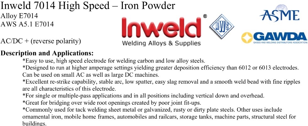

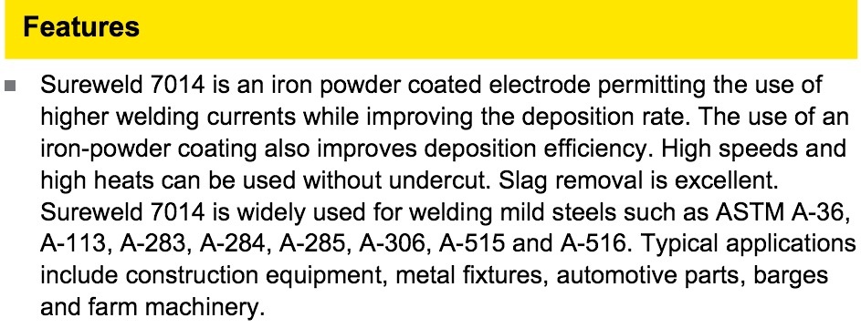

ArcWeld - I'm not going to say 7018 isn't a great rod - it clearly is. May even be the best choice for the hooks as well.
I'm going to respectfully disagree that 7014 won't work for dynamic loading though and have attached two manufacturers intended uses for the rod - it would appear that some of those uses are dynamic.
Those are pretty generic applications and not very specific. Listing structural steel as an application for 7014 is just plain wrong. There is no structural steel procedure for 7014 or even short circuit MIG for that matter. A simple way to tell which rods are for dynamic loading is to see if low temperature impact strength is required in the AWS classification. Also consider that low hydrogen, xx16, xx17 and xx18 as well as xx10 are the only common rods that come in higher tensile versions. You'll never see an 8014. The only exception is 6011 which is basically a 6010 for an AC machine. Anyone requiring a higher tensile would most likely have a DC machine and use a higher tensile XX10 rod.
