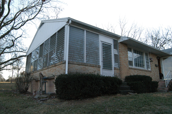

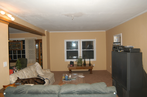

one shot of the porch open the the living room. the other picture is of some of the damge caused by the old windows.

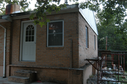

ok folks thanks for the advice while I was working on this room addition.
here are 3 pics showing the begain to end work. brick is almost done. And so am I.
