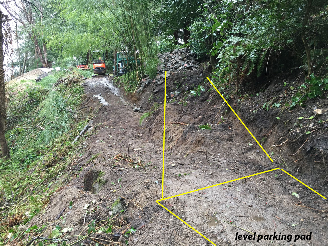

Here's today's pics. It's raining, and just mud. There's a thin layer of soil over the first course of rubble. Today in the rain I can start assembling the first geogrid layup.
545128d1521736374-need-help-access-road-across-img_1171_grade-jpg
I sure would like to cover each layer (of rubble) with 1 1/2" crushed rock but I don't want to spend any more money on it until I get nearer to the top courses & final gravel. You can see a 10y pile of covered (sandy) soil to the left of the eqpt. It's more than 50% sand.

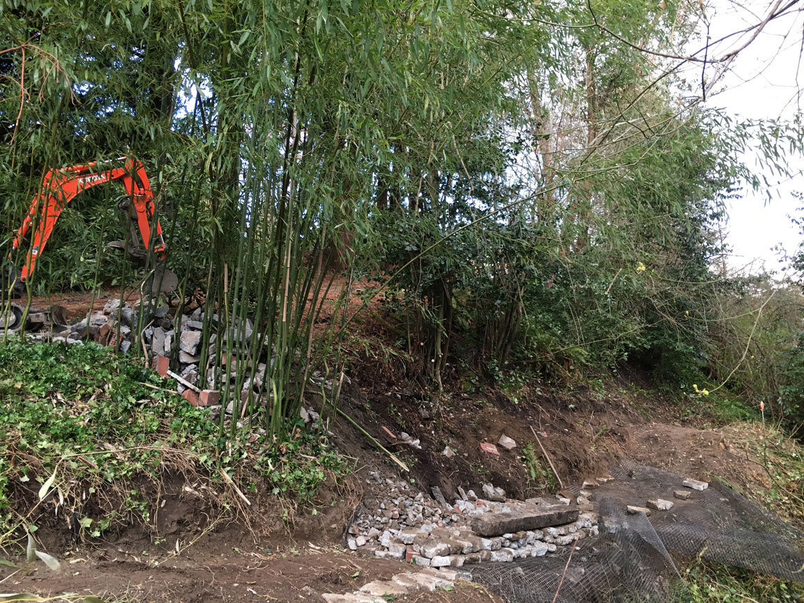

Started my layup today. There's one course of rubble, with dirt, so I could drive the excavator over it one more time. The first layer of geogrid is ontop of the layer of dirt ontop of one course of rubble.
545201d1521783831-need-help-access-road-across-1st-course-geogrid1-jpg

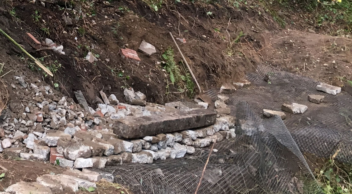

The plan is (or was?) to go up 3 layers of rubble and wrap the geogrid back over the roadway. 3 layers is about 15 inches, so I'd have to do this 3 times. It was time-consuming to stack the little "wall" then lay in the rubble behind it minimizing the voids.
The railroad tie is just a "fence" to prevent rubble tumbling off the pile from going over the edge.
545202d1521783831-need-help-access-road-across-1st-course-geogrid2-jpg
Then I watched this YouTube. Which has convinced me that I'm being a little too **** (and consequently, slow). The Geotextile is going to do what I need, without so much careful stacking. Maybe I'll just finish out the good solid base then just pile up layers fast.

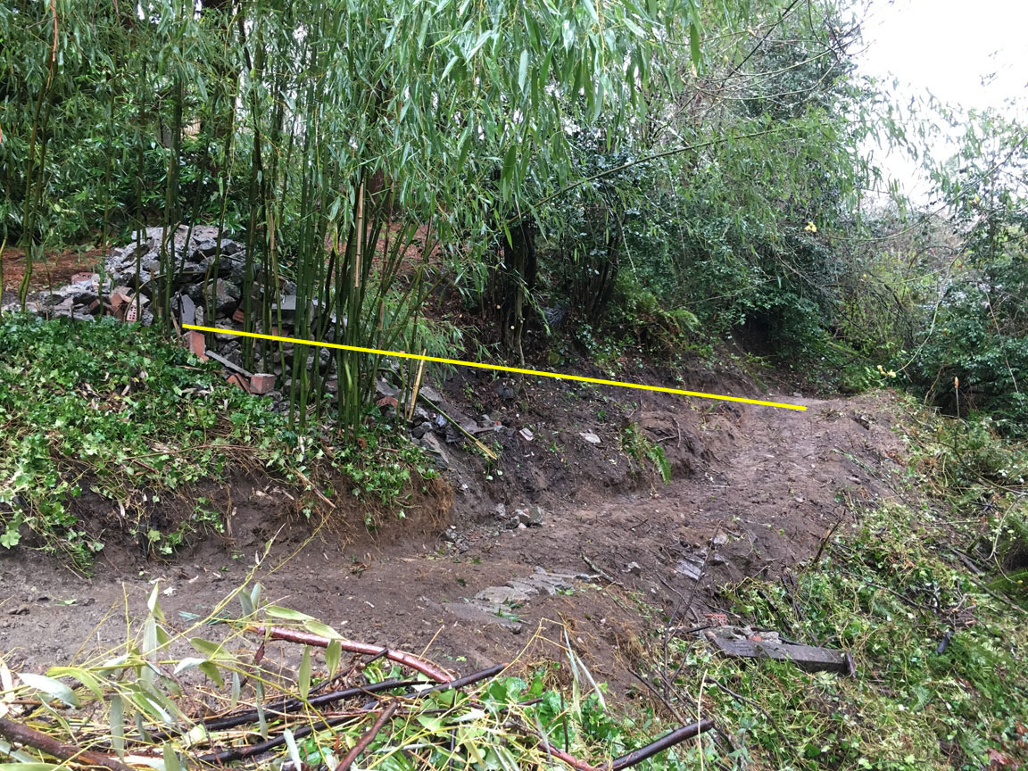

Here's the status as of 6PM today. Almost ready to roll the geogrid back over the shelf. Im up 24 inches over almost 30 feet of the first course. I stack a wall with the biggest chunks then just backfill it with smaller rubble. This thing is frickin' HEAVY, there's no way that Geogrid's gonna move ever.
545348d1521862905-need-help-access-road-across-24inches_up_puckermoment-jpg
I stopped the tractor and lifted the bucket for the pic. So y'all could pucker with me....;.

that last pic clarifies what you are up against. Looking good.
