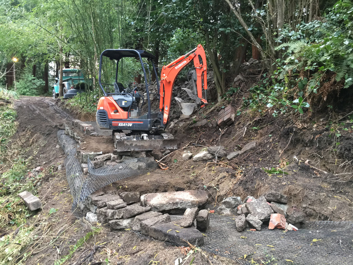

Everything gets covered with ivy, so I'm assuming it will be sheltered from UV.
545784d1522128636-need-help-access-road-across-img_1247geogtrid-jpg
I cut it with a battery-powered skilsaw.
Cutting it with shears it seems soft and pliable,
but with the saw it kinda 'shatters' and you can see the reinforcement fibers.

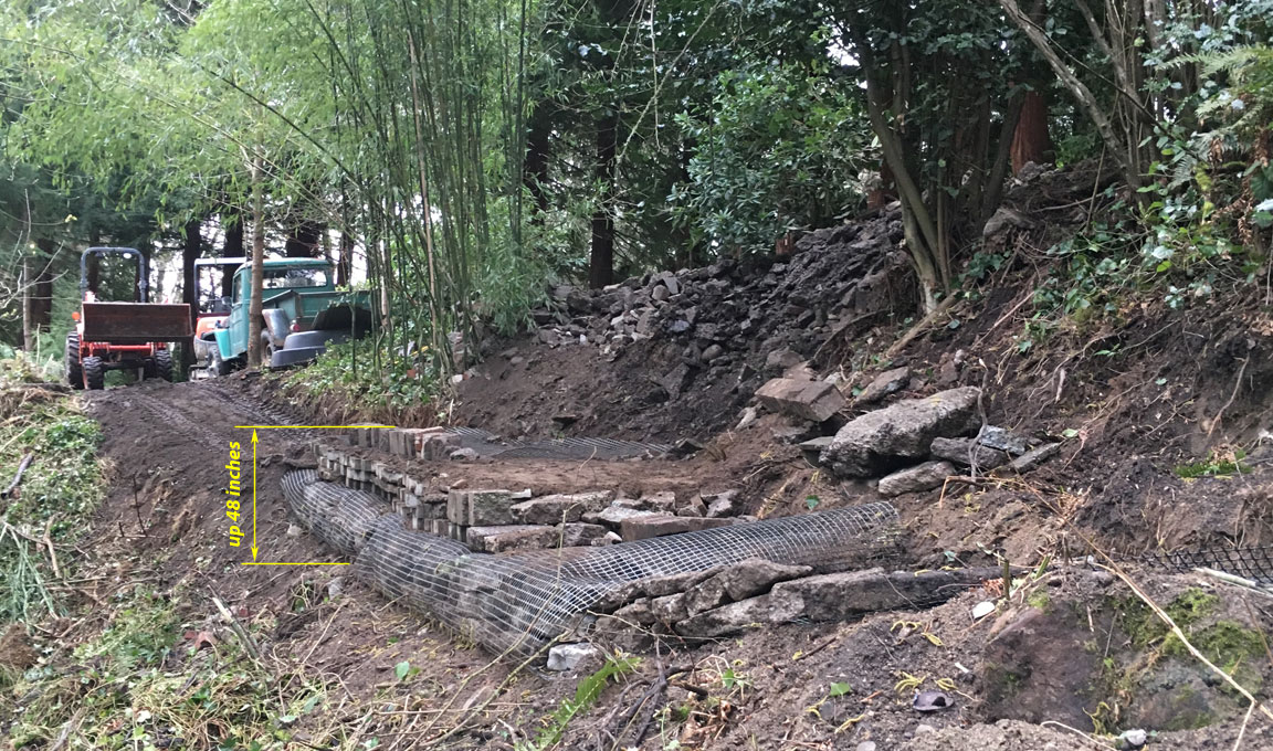

545781d1522128636-need-help-access-road-across-img_1242up48inches-jpg
I'm four feet up now (sort of).
The first course I "wrapped." But this was difficult and could not get it 'tight' anyway.
I hope the ivy covers it ASAP. The next courses I just laid the geogrid on.
545782d1522128636-need-help-access-road-across-img_1244-jpg
I might go one more course, then will start angling down on the upper roadway (the actual driveway).
545783d1522128636-need-help-access-road-across-img_1245-jpg

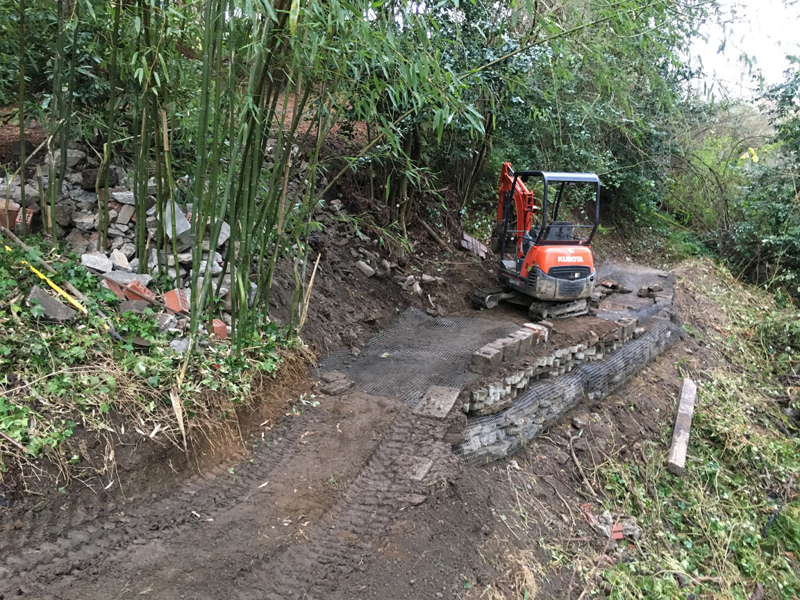

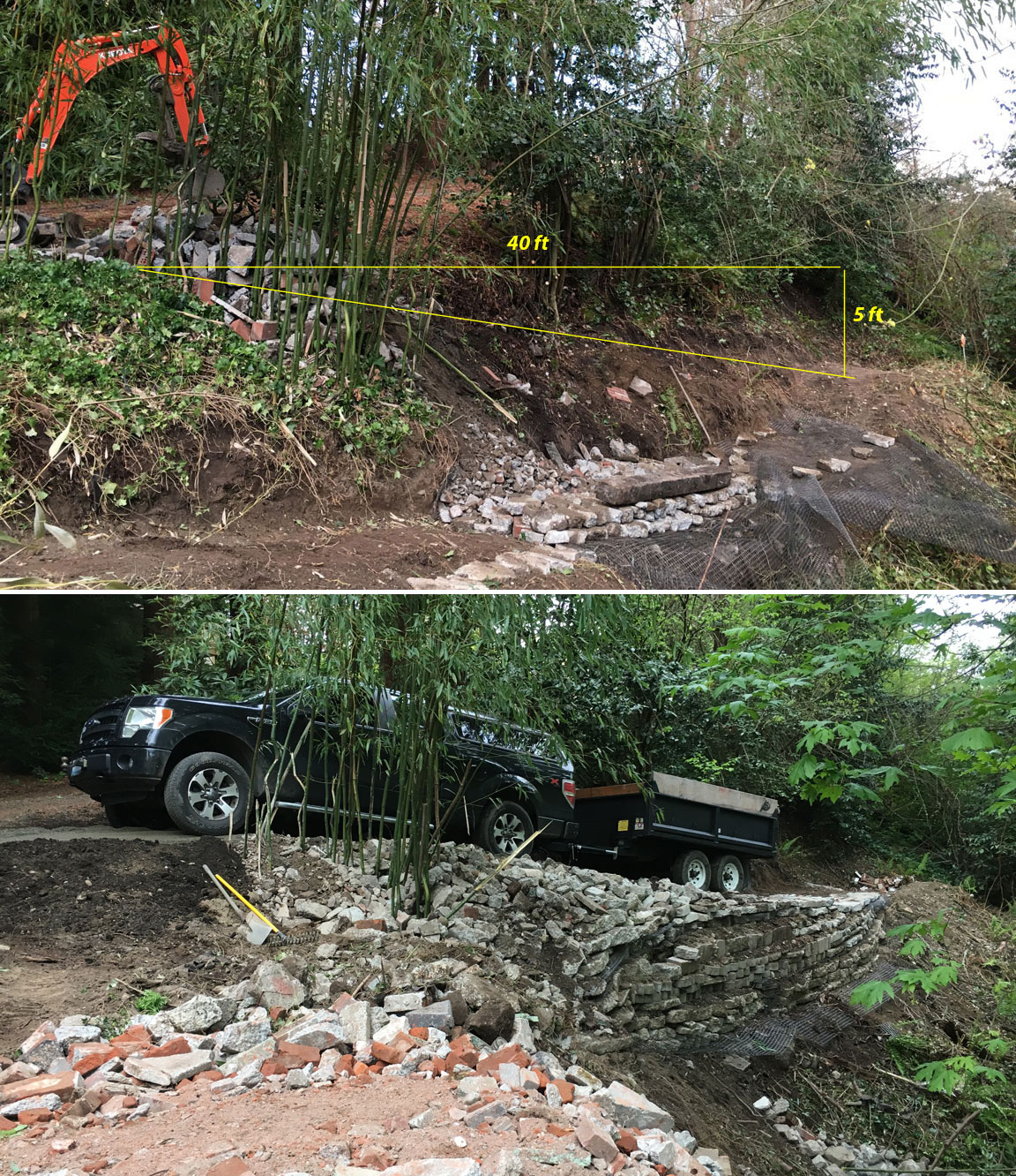

Pretty far along now. Here's a before/after.
552329d1525322142-need-help-access-road-across-before-after_almost_done-jpg
I spread 5/8minus gravel on it.
Now just gotta make the parking pad at the end.
Now it's gonna be a lot easier to get concrete out to the end.:thumbsup:
I'm more than surprised it's been 5 weeks since I started (minus 18 days off to go camping in Utah....)

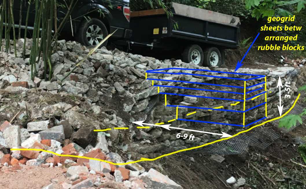

Made this pic so in 20 years in case anyone asks "how come that little spur never slid down the hill?" (fingers crossed !)
Then (if I can find this pic) I can remember how it was built.:thumbsup:
552348d1525358911-need-help-access-road-across-rubble_layup-jpg
Basically I cut a 6 foot shelf into the hill and built up with engineered roadway materials. It's an arranged slug of reinforced rubble that widens to about 9 feet up the slope. And 3-5 feet thick.
It's my own design, based on available materials. ;) Not expensive, but it took some time.
I had to buy the geogrid but the rubble was "free." I put about 4 inches of dirt ontop of each course of rubble, then laid the geogrid on the dirt. Then next course of rubble directly on the geogrid- which is not the standard method. Normally geogrid is layered with soil ONLY and the ends are 'sealed' with a fabric so the dirt doesn't fall out, and other obvious reasons. No rubble of course. But this is NOT for 80,000lb truck-traffic, it's a dead-end driveway spur.
I plan to back-fill rubble against the (almost vertical) face of my buildup, then cover with dirt and let the ivy grow over it.

Nice job. But I am completely confused. You built a temporary "road" to access this area, just so that you build a much more difficult way to access said area down the steep slope? Why not access it from the easier way you originally had excavated?
   / need help with access road across steep slope
#28
I can see that.....:confused: My wife (and everyone else) was asking the same thing but they couldn't read my mind:D.
I plan to park a dump trailer and a car trailer there on the level (next to where the Jeep pickup is parked). I'd have to move trailers every time I want something in/out of my 'new parking spot'.
The new spur intersects the driveway directly and will remain clear and accessible at all times.
   / need help with access road across steep slope #29
Oh, I get it, this kind of gives you easier access to BOTH spots, rather than just as one long spot...
