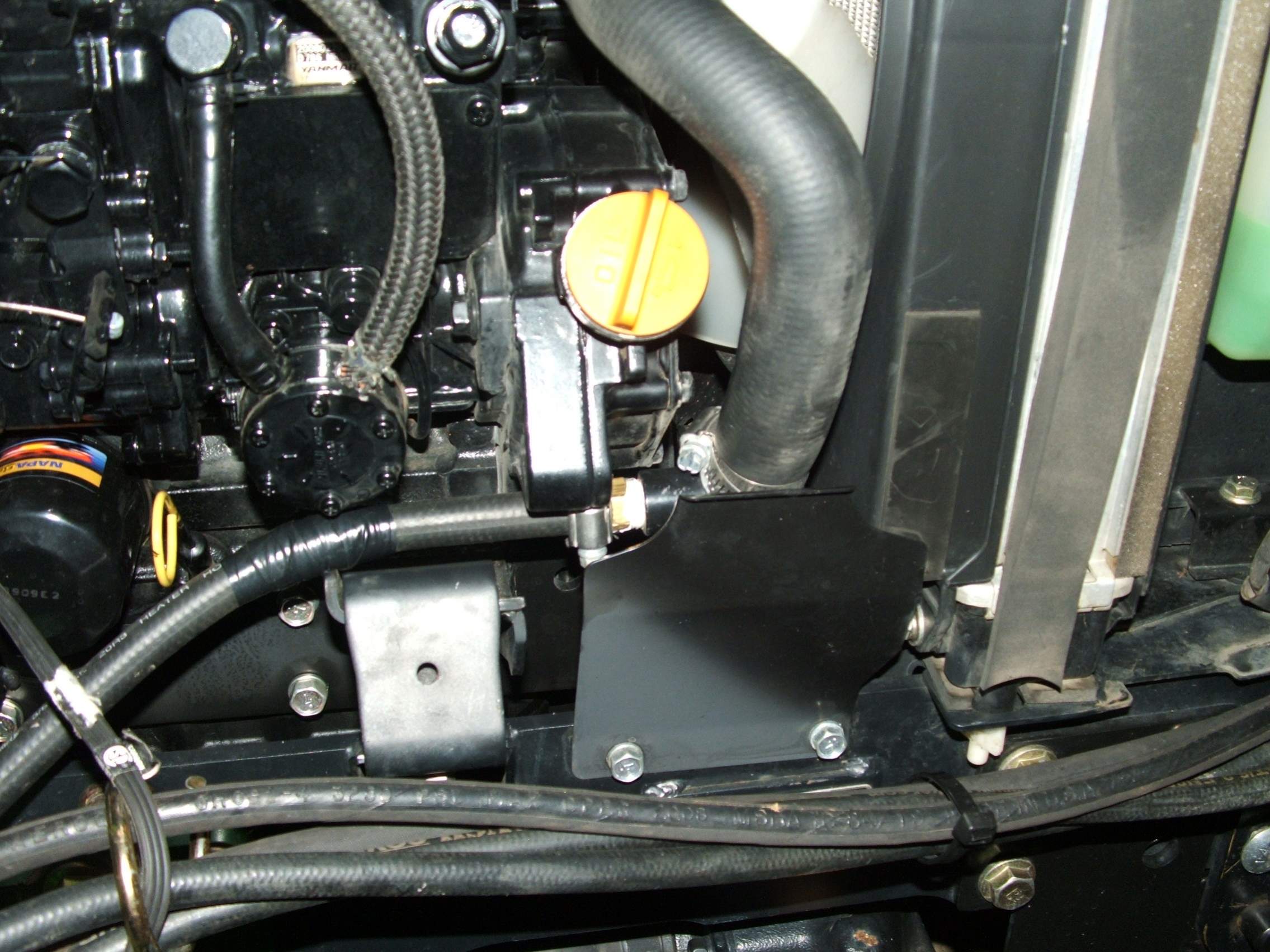

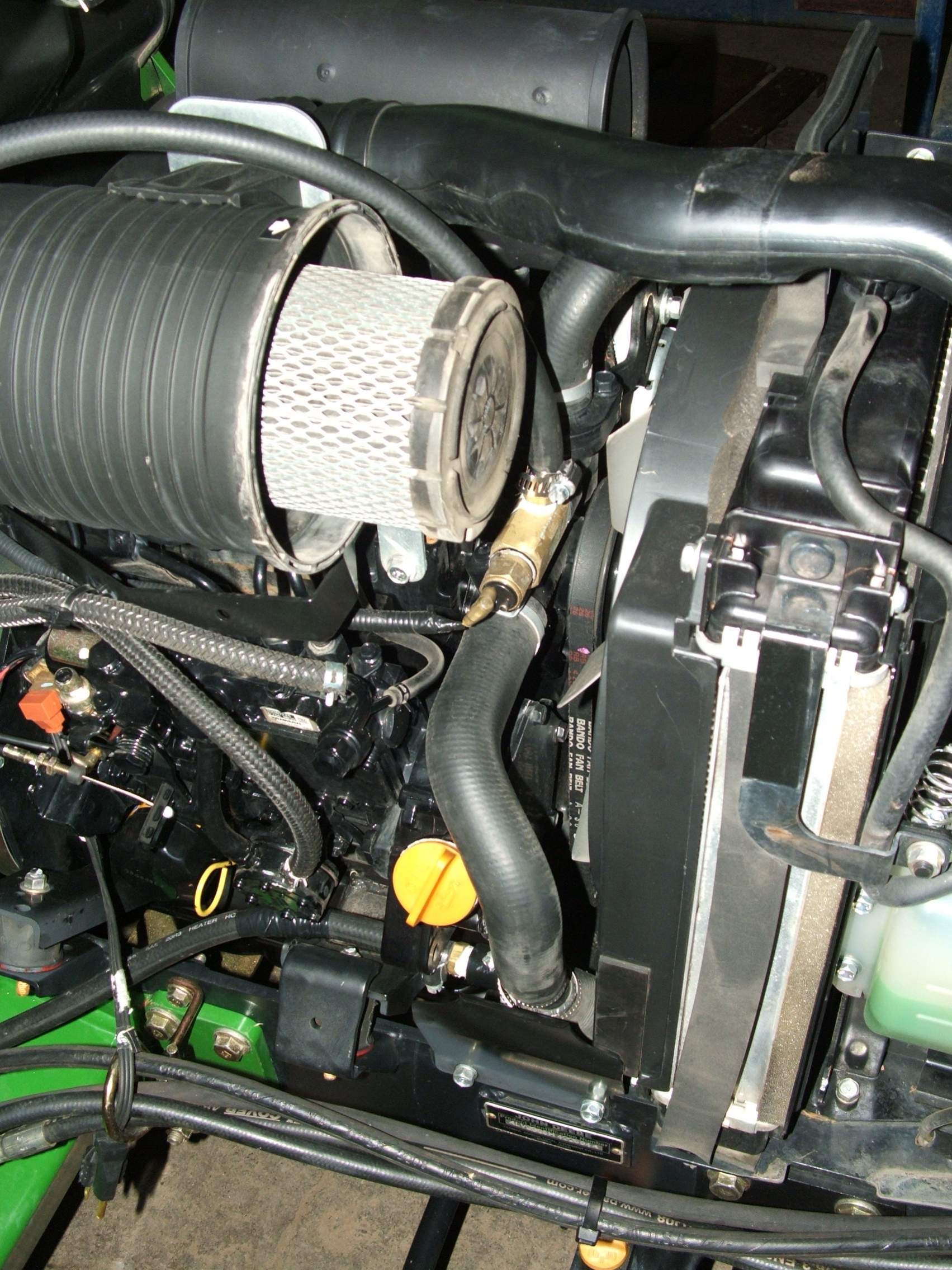

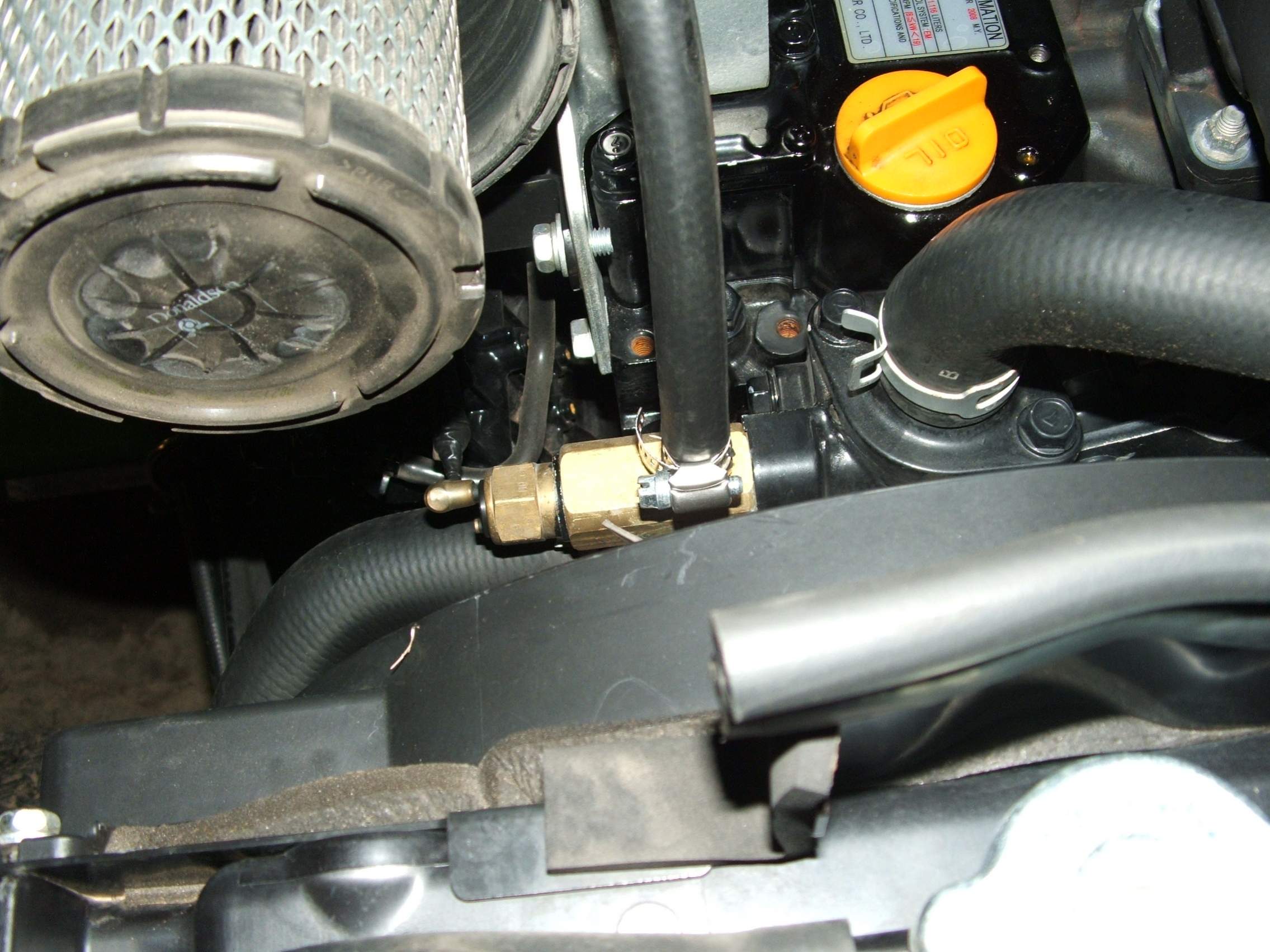

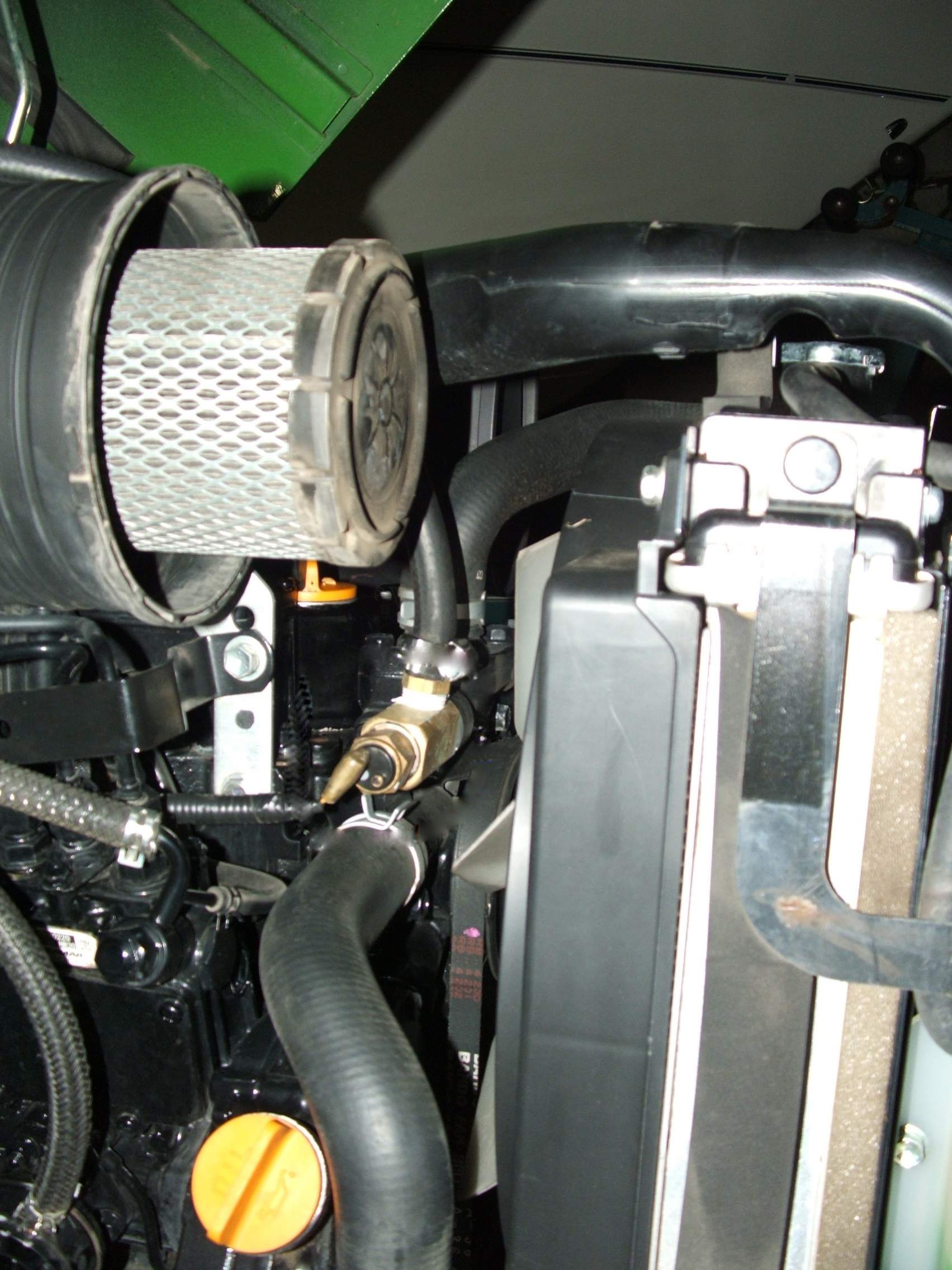

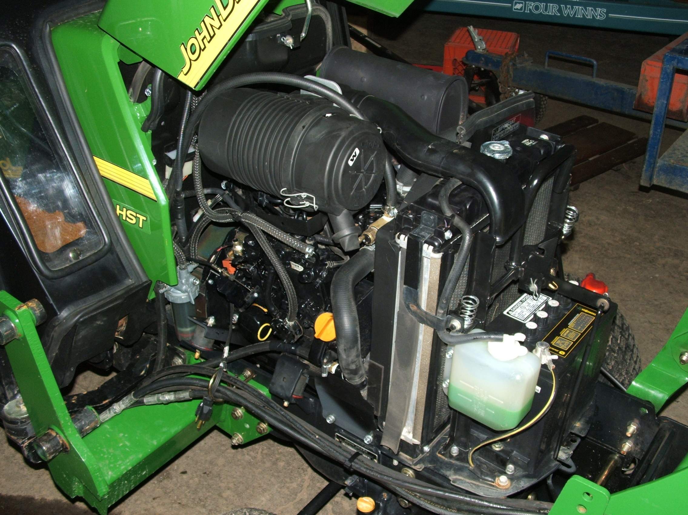

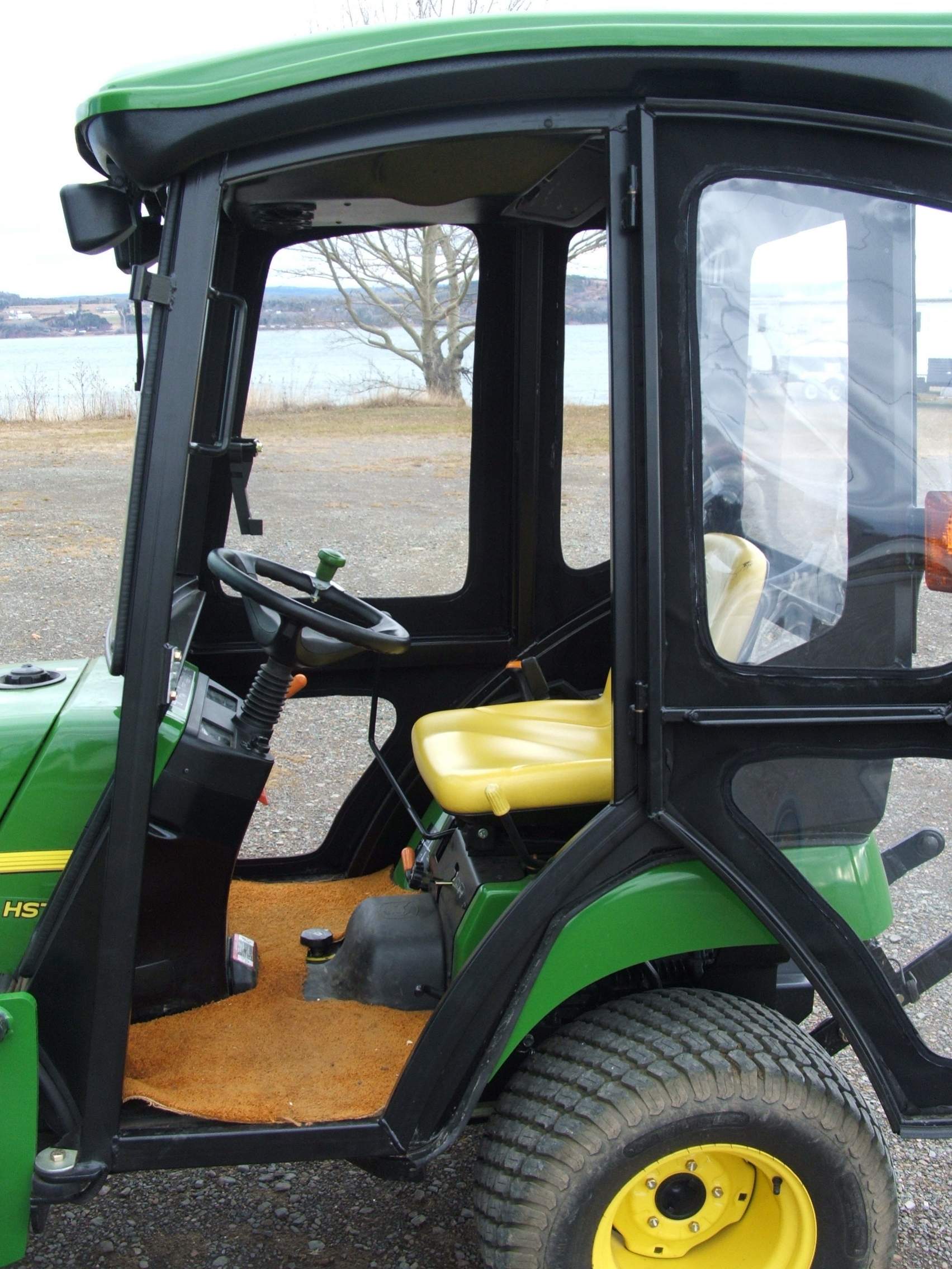

I could use some help in the form of instructions/pictures for installing a cab heater on my 2305. I've got the Original Tractor Cab installed, but I haven't seen any good guidance in terms of how folks have installed coolant based heaters. Looking for:
- Models of heaters people have had good luck with?
- How did you tap into the coolant lines?
- Do you take the heater off in the summer? If so, what did you do to make this easy?
- Pictures?
Thanks in advance!
Scott
   / Need help with cab heater for 2305 #2

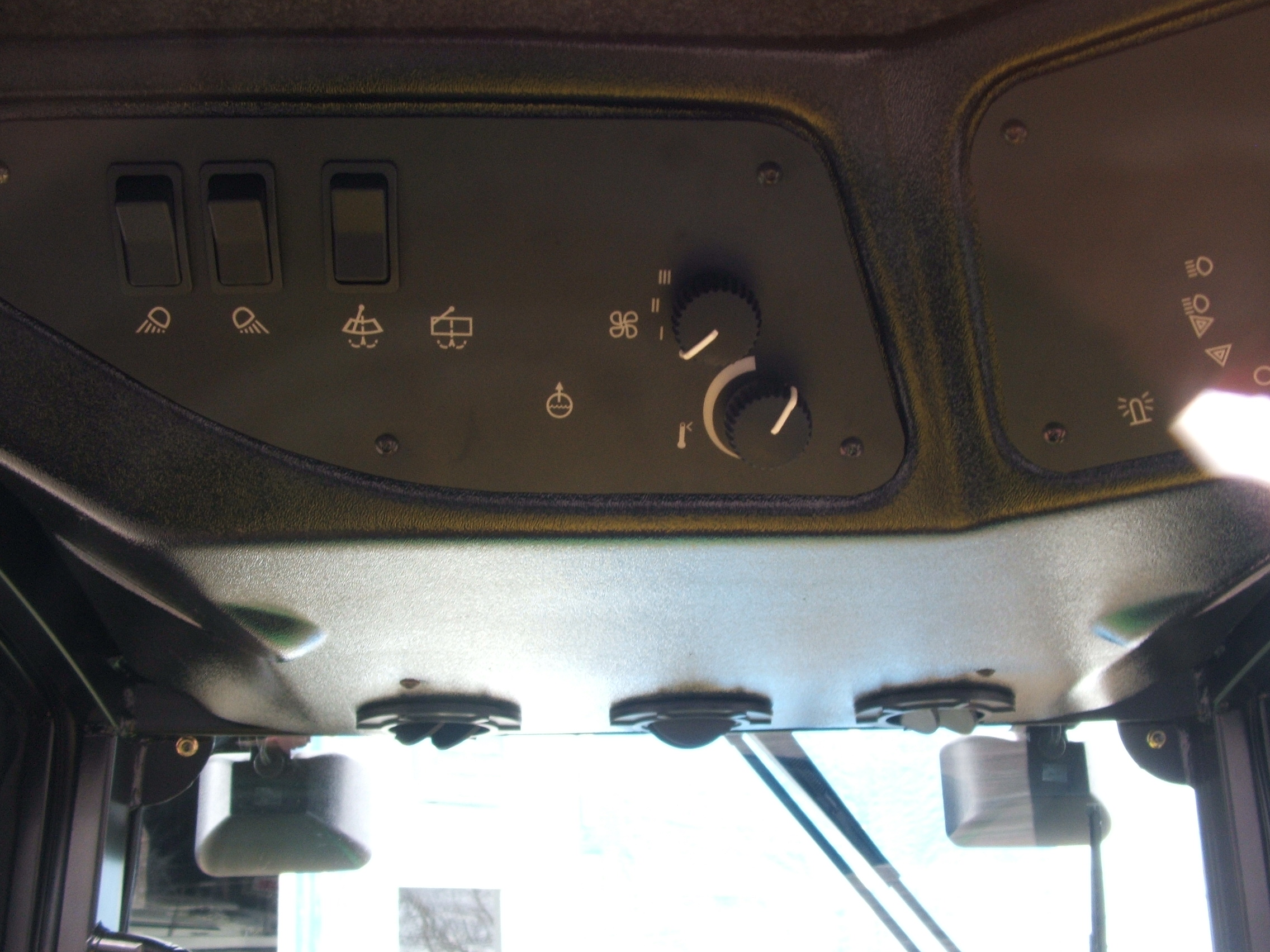

Here are a few pictures of my set-up. The heater came with the Jodale-perry cab and the fitting was included in the package. The top hose by the thermostat is your feed line and the bottom one by the radiator is the return. Summer time I remove my cab and link a hose between the top and bottom hose fitting. The heater in my cab is built-in so I can't help you there.
