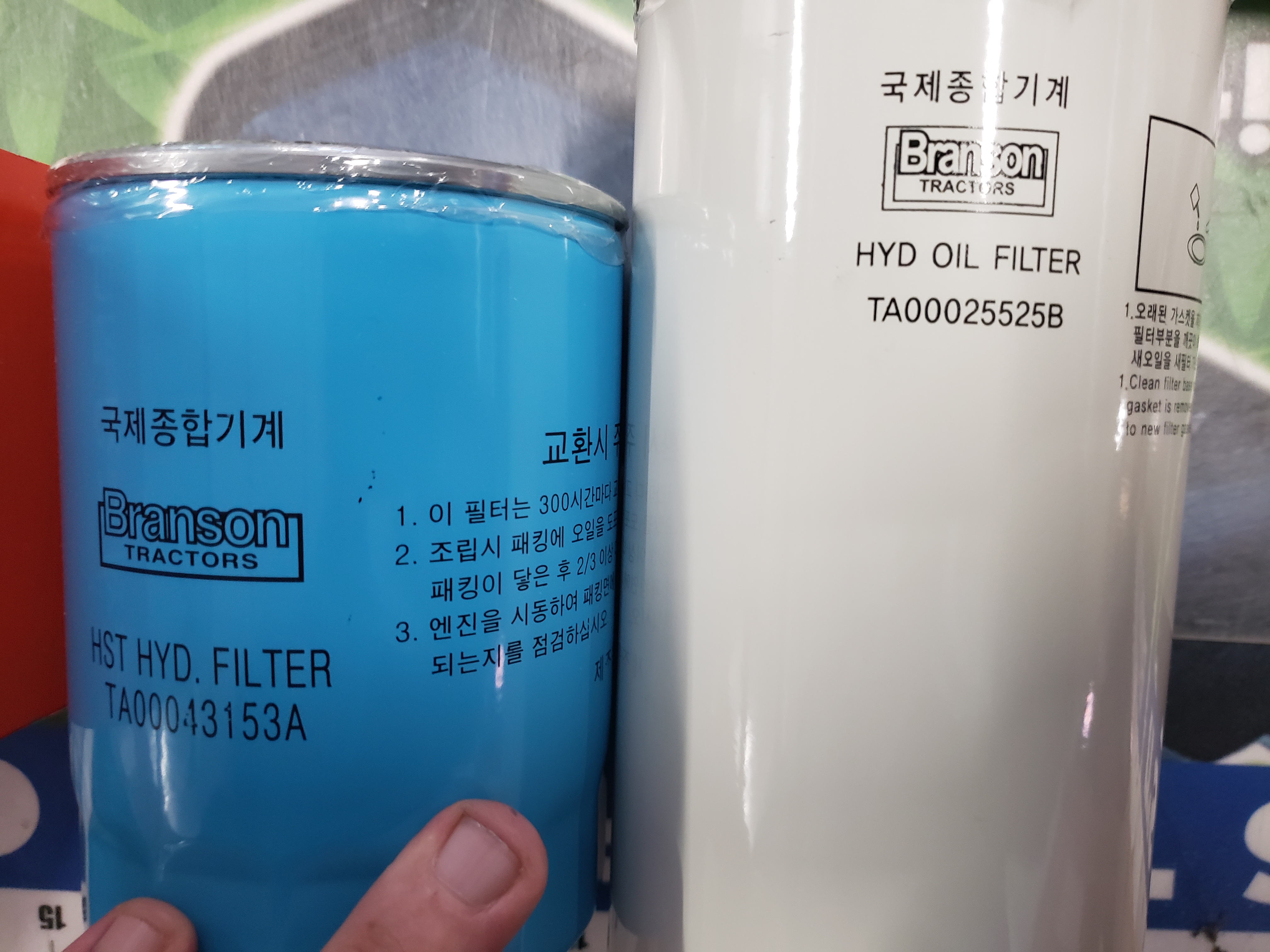

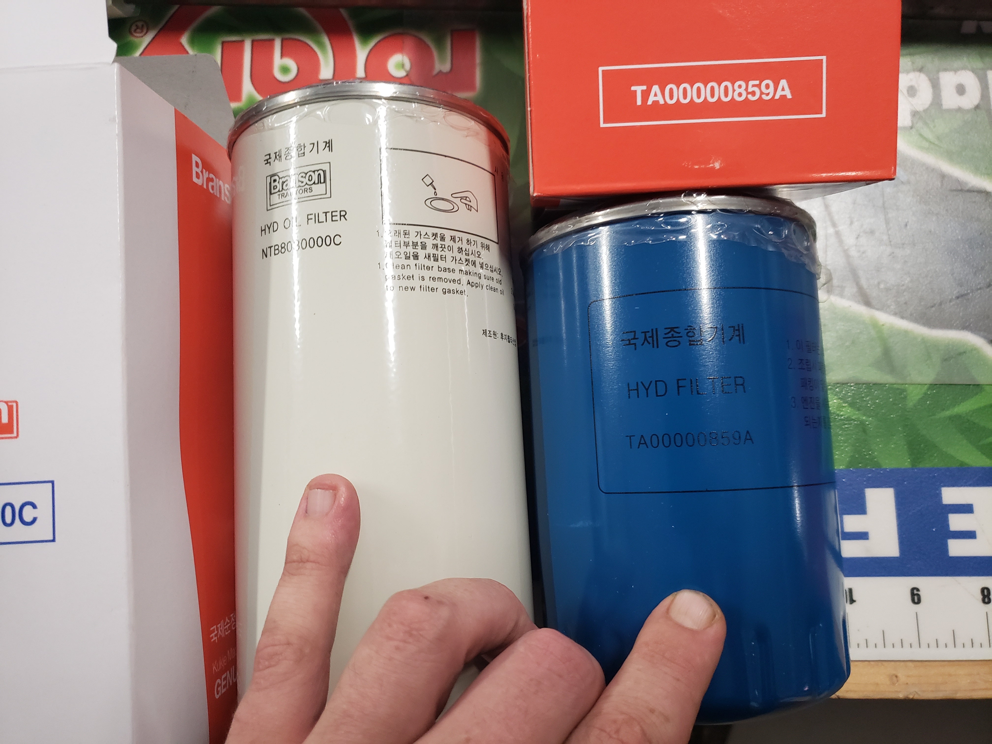

ok for your tractor the 4720H you do indeed have two hydraulic filters, one main hydraulic transmission filter and one hydrostatic motor filter( both are for the hydraulic transmission), to find out the exact filter you need all i would need to know is if your tractor has Diesel exhaust filtration( If it does you will see a very large metal cylinder directly on top of the engine, if you don't see this and only a muffler then your tractor is a pre 2014 model, if you do see this its after 2014.) there are two options for your hydraulic filters
the first being this: NTB8030000B3 - main filter, TA00000859A hst motor filter they look like this, 20191218_090309.jpg
if it is the other set : TA00025525B - Main filter, TA00043153A - Hst motor filter they look like this,20191218_090406.jpg
There are part numbers on the actual filters so it should be fairly easy to find out which set is on your tractor.

well i took off NTB8030000B3 and TA00043153A but they gave me TA00000859A and its looking like it wont work. ill have to dig into it more later tonight.
im taking the filters into town hoping i can get some thing to get me by till i order a few sets of the right filter.
it does have the dpf filter above the engine
