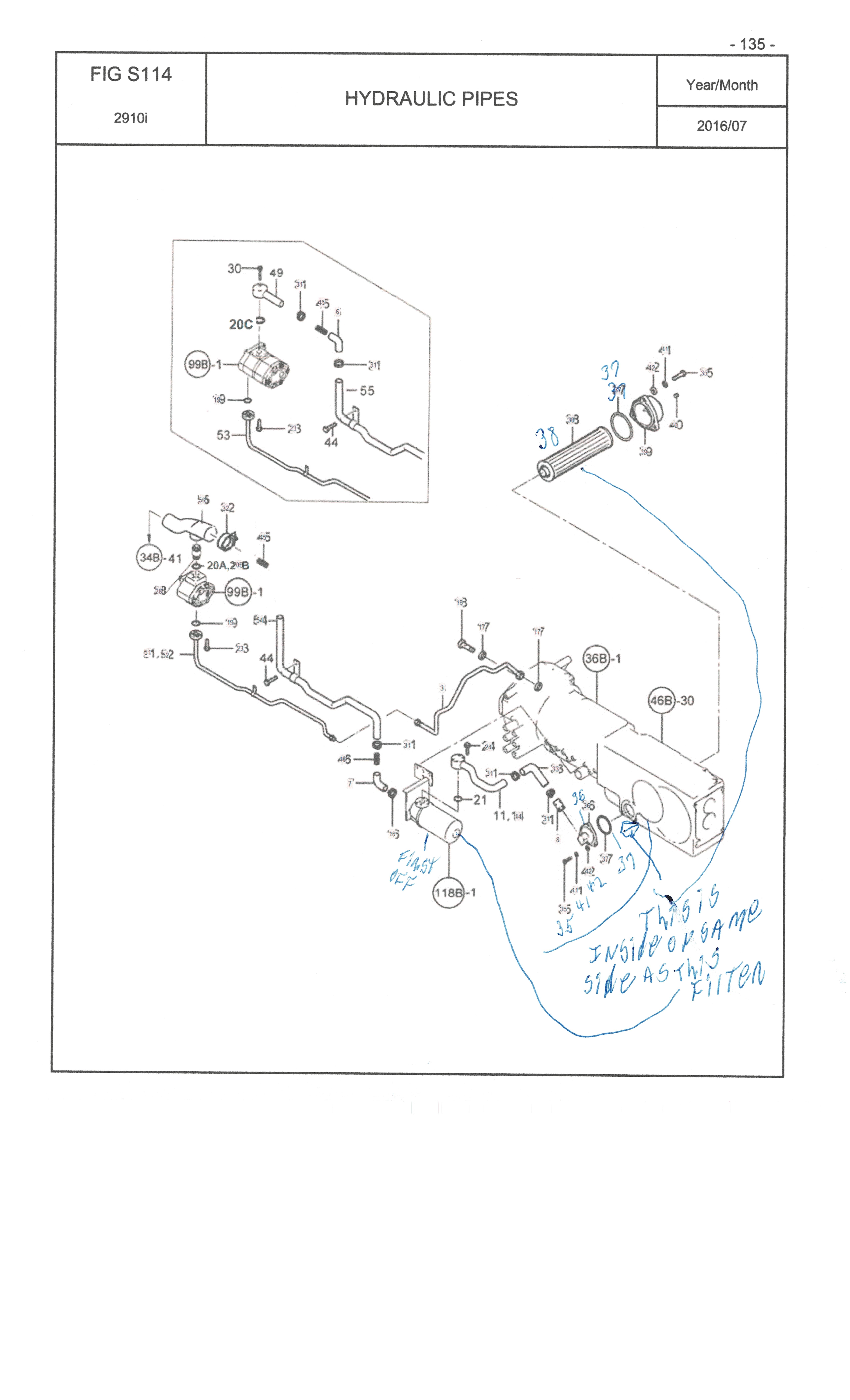

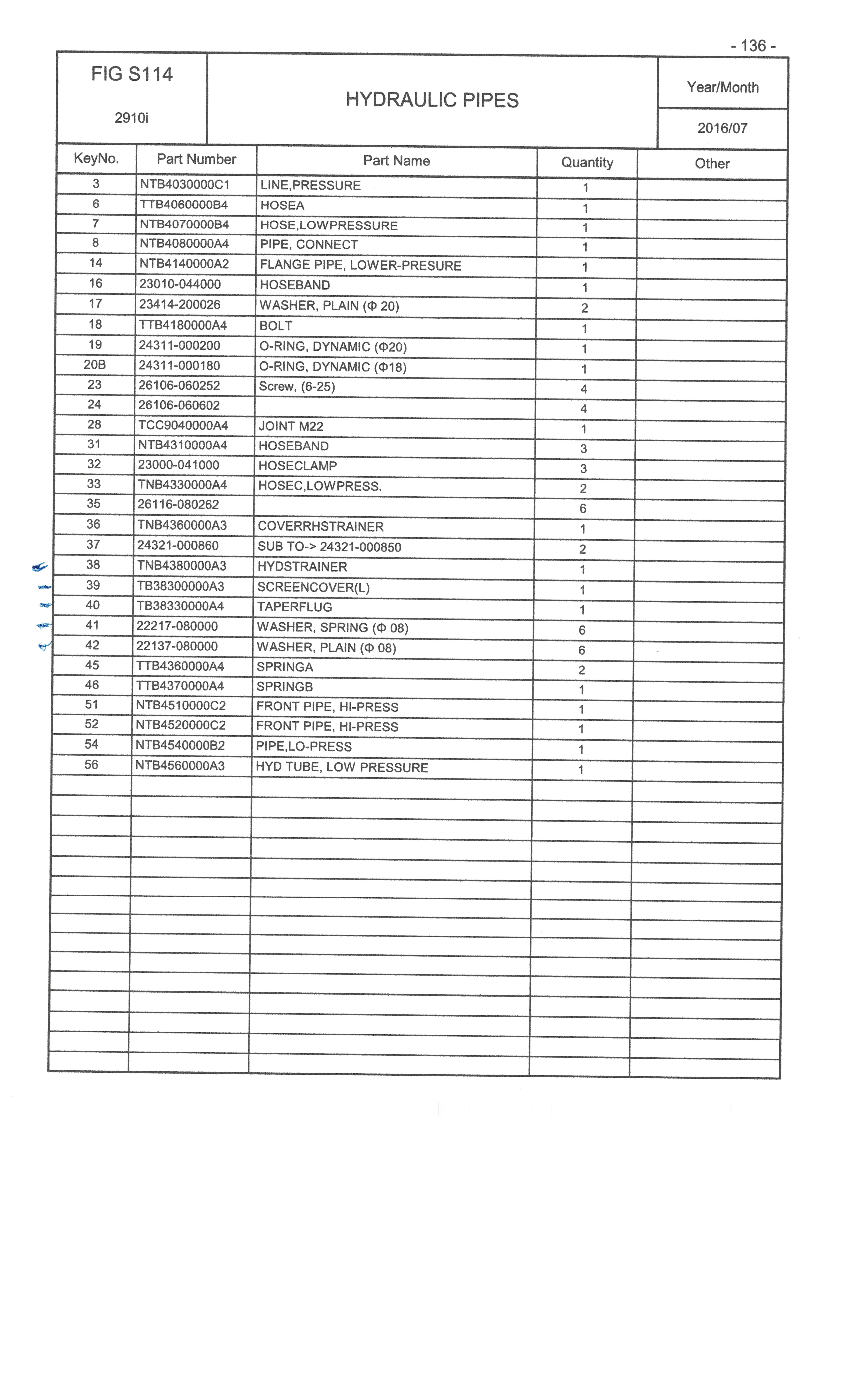

Oh man, hopefully not derailing the thread but I juts struggled with the screen issue when doing the HST/HYD fluid change last week. The 00 series service manual (page attached below) says...
1) When changing the transmission fluid, disassemble and rinse the strainer with nonflammable solvent to completely clean off filings. When reassembling, be careful not to damage the parts. 2) Since the fine filings in the oil could impair the component parts of the hydraulic system which is precision built to withstand high pressure, the suction line end is provided with an oil strainer. 3) Please do the replacing, of the oil filter cartridge and the cleaning oil strainer at the same time. And when replacing, reinstall the oil strainer first.
No photograph or detailed guidance of how to locate the strainer so I assumed my model didn't have one so I put the filters on and filled with oil. I still don't understand where this strainer is actually located or how you get at it on the 2400h.

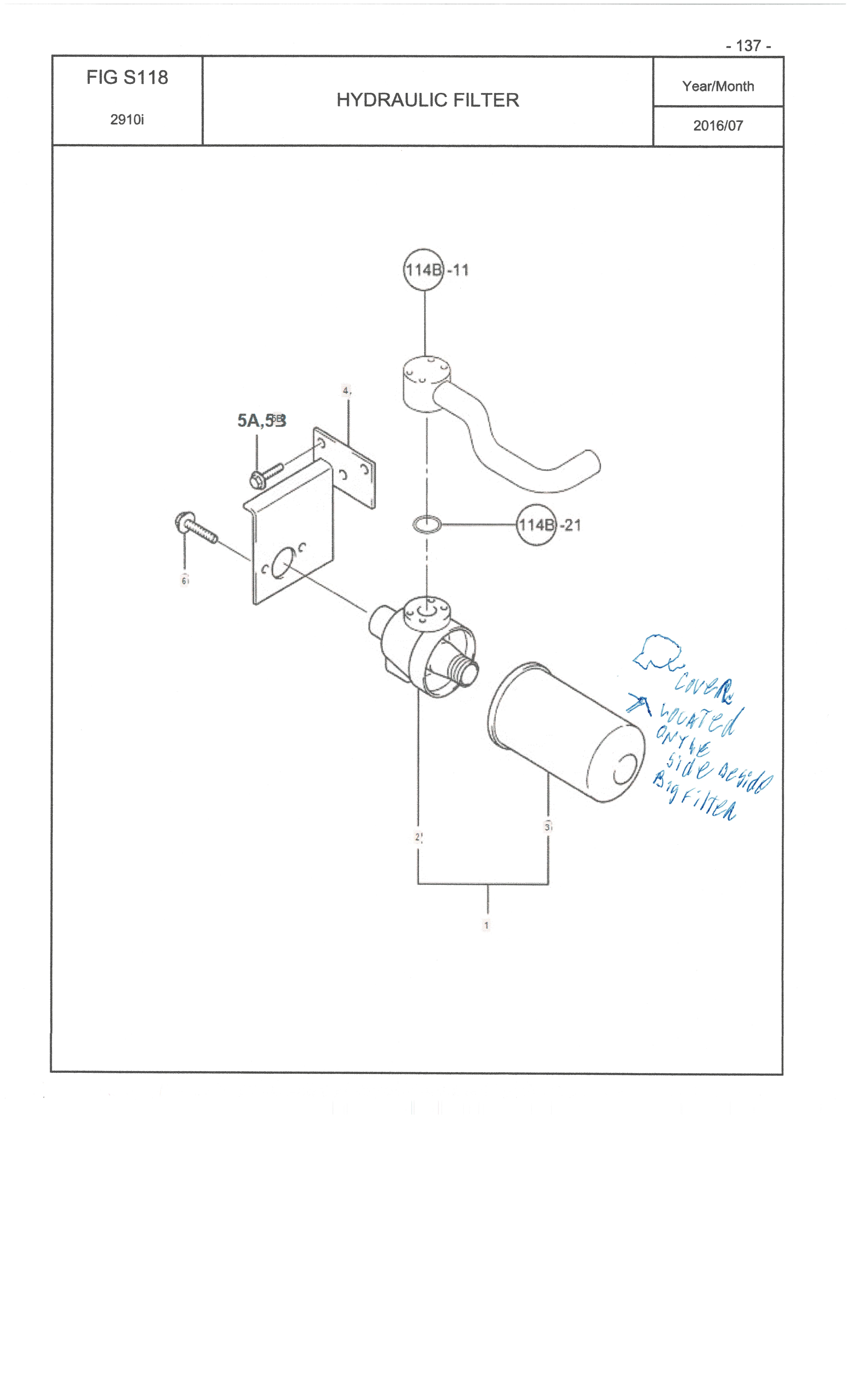

I know it was a learning experience to find hydraulic strainer, first you have to remove the big filter you can see and then remove the cover that is behind the big filter and inside you will pull out a cylinder made of steel mesh, wash and clean it, mine had never been cleaned it was clogged badly, I assumed it didn't have one because you cannot see it with the eye. Because you have to remove filter in front before you can take cover off and get to metal strainer,the book says to do them at same time.View attachment 2910i filters 003.jpgView attachment 2910i filters 001.jpgView attachment 2910i filters 001.jpg Hope this helps.View attachment 2910i filters 002.jpg

I know it was a learning experience to find hydraulic strainer, first you have to remove the big filter you can see and then remove the cover that is behind the big filter and inside you will pull out a cylinder made of steel mesh, wash and clean it, mine had never been cleaned it was clogged badly, I assumed it didn't have one because you cannot see it with the eye. Because you have to remove filter in front before you can take cover off and get to metal strainer,the book says to do them at same time.View attachment 643560View attachment 643561View attachment 643561 Hope this helps.View attachment 643562
Thanks sallyb!!! That dose help plenty! Do you happen to know if I can pull the screen without draining all the oil? If I yank the big filter and only a litre or two come out I'm okay with that.
   / need help with filters and hyd fluid my Also dealer sucks #20
I had changed oil and filter twice ,one right after the other,so when I finally understood where mesh filter was, I did not change filter or oil again, you will loose some oil of course but not all ten gals. . I did not drain oil out again when I found the filter and did not replace outside big filter again. It is frustrating and costly. Good luck, hope this helps.
