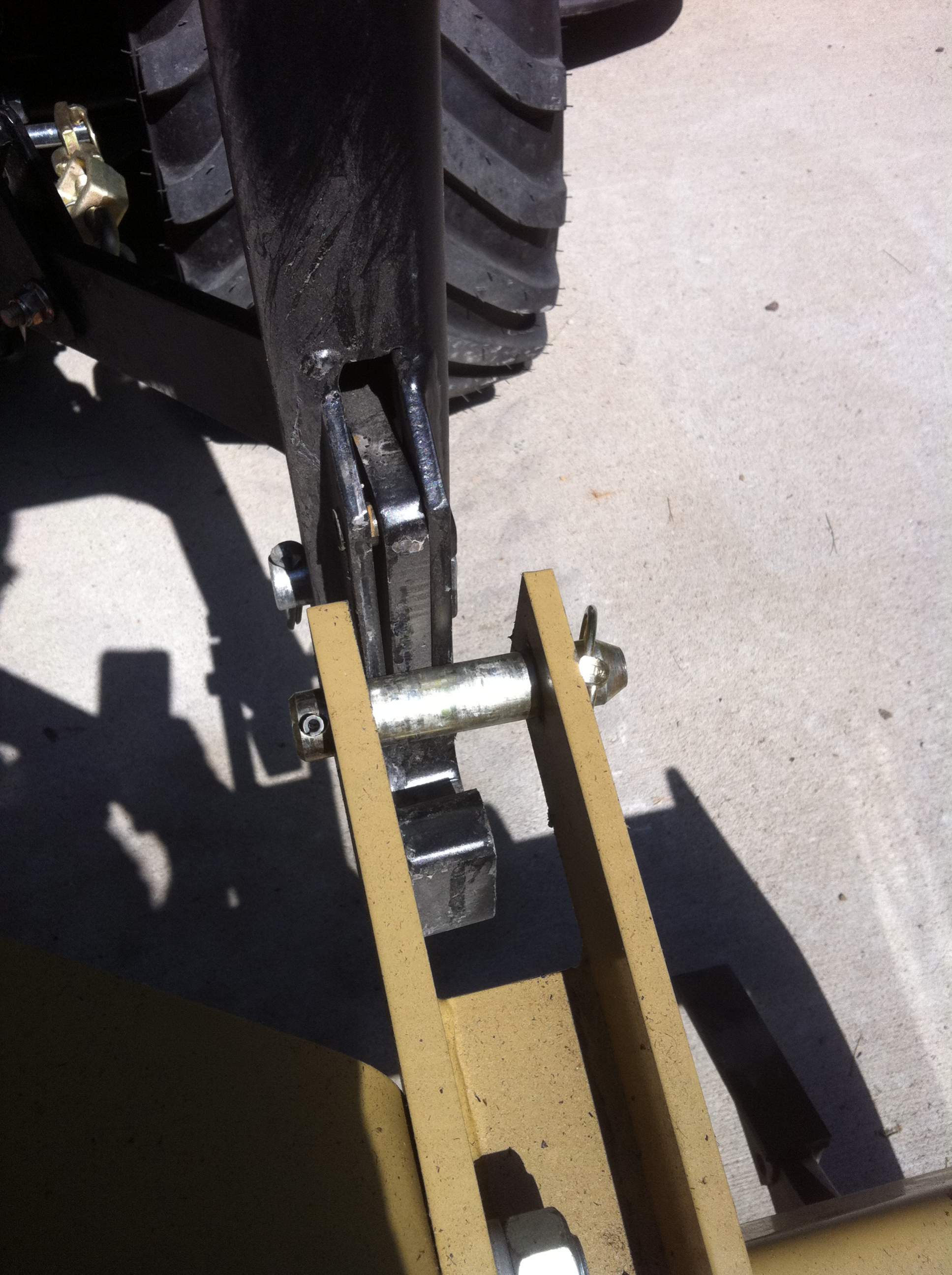

Here is what my john deere dealer told me "The I-match come from John Deere but they do have 2 different ones. The black one like what you got and then a higher priced one that is the same only green. The box blade will work, all you have to do is extend out the top link before you back up to it so the hook is farther back."
I have tried that but still can't get it to hook up, enclosing some pics maybe you can tell me what I am doing wrong. I can't even get the bottom ones to hook up. Looks like to me if I suppose to hook up to the bottom bolt of the box scrapper it is too big to go in the hole. I hate calling my JD dealer all the time he prolly thinks I am an idiot. 1st time tractor owner I don't know about this stuff.

The black and green quick hitches are NOT the same. Unfortunately the green ones are not available at the current time - they were redesigned with and adjustable upper section and have not been released yet. The black one is cat 1 only and does NOT fit everything. I have several customers waiting for the updated green version to be available.

Ditto on the black and green hitches not being the same. The black hitch does not have a large enough center hook to work with most att and have not seen very many applications where it works well. The I-match green version will work with everything that follows true catI dimensions with the exception of certain items like a rotary cutter that does not have a floating hitch. You can hook up but can damage the lift arms when operatin (non floating units can be made to work if you replace lift straps with chains). You can make your hith work by enlarging the hook or better yet wait for the I_match version. Typically when using a hitch you are using the lower pin on the mast and today it is almost always closer to catII in diameter than catI. That is what it appears you are having problems with.

The John Deere salesman just came to my house, he had to take the bushing out of the lower pin and he made some other adjustments and NOW all I have to do is back up to it and raise it up and it works. He also showed me how to hook up the driveline for the rotary cutter. I think now maybe I got it figured out better knock on wood.:laughing:
