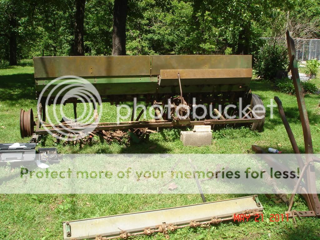

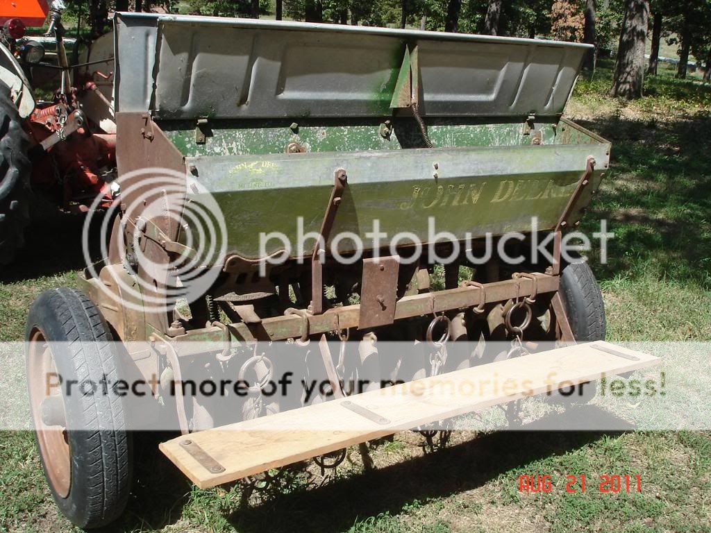

The levers at the back, side corners are the feed control for the fertilizer section. The picture below shows the seed lever under the lower left, and the fertilizer on the left side pointing towards the back. That drill is a JD/VB FB, which is very similar to an FB-A.
They are very simple drills, not a whole lot to figure out. Here's a link to an ebay auction for one.
John Deere Van Brunt Model FB-A Grain Drill Operator's manual Original | eBay
I found this one in a fence row, all bunged up, bent frame and broken gears on the passenger side. Cut it about in half, made a sweet little drill. HTH Mark

Nice job:thumbsup:
