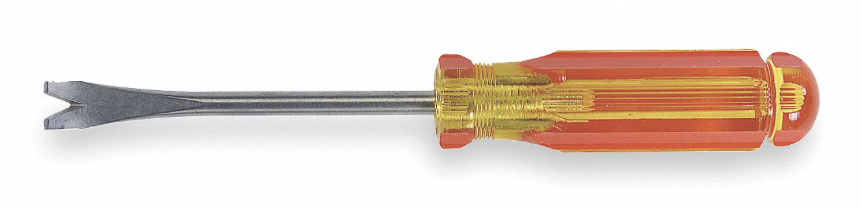

Or if it is a slip fit and presses down to seal I'd do it differently. In that case, get a tack claw and work around the edges levering it up a little at a time.
This is a Stanley 69-010 tack claw
luck,
rScotty
luck,
