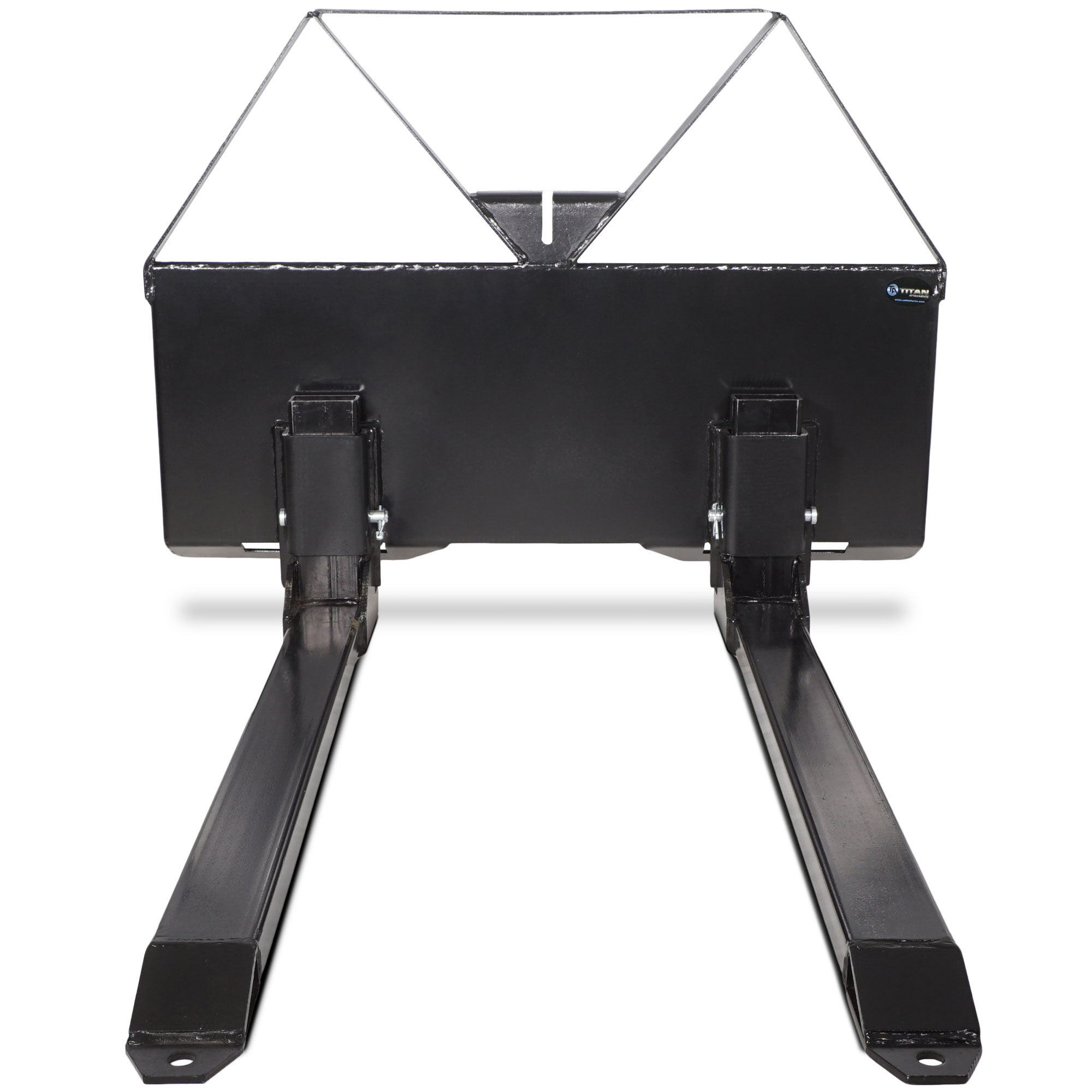

Planning on building a pole barn this year, anticipate needing to do some high lift of beams and rafters. The lift is going to be higher than my FEL can reach.
I have a LMC Cat 1 boom pole I rarely use. I was thinking about attaching it either to my SSQA pallet fork frame, or to my FEL bucket. My pallet fork setup is Titan's budget/non-adjustable forks. Pic:
Boom pole looks like this:
Thinking I could make some type of fixture that would replace the forks, sliding in from the top of the fork receivers, maybe using the same pins. And mount the boom pole to whatever that fixture is. Use heavy chain or some type of drilled flat stock for the top link attachment.
A slightly more expensive option would be to buy a blank Titan SSQA plate and weld the boom pole to the plate. Practial, still cheap, but I dislike losing flexibility (rear lift use of the boom pole) even though I rarely use it.
A still more expensive but more versatile option would be mounting something like Pat's quick hitch arms or a HF quick hitch to the front of the pallet fork frame.
And, of course, more expensive still, I could also just by a Cat 1 adapter for my FEL. :)
Interested in thoughts and experiences.

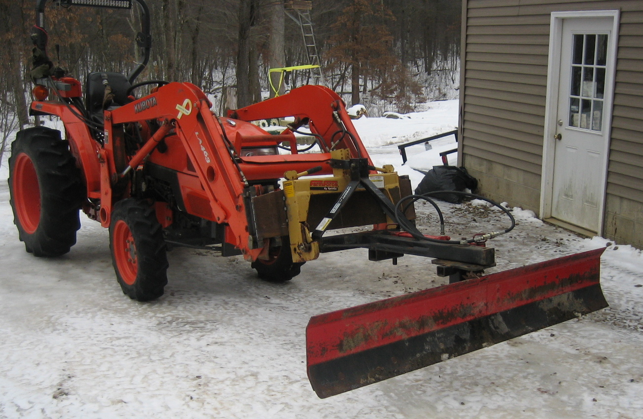

Here's what I made from an old quick hitch
to put my blade on the front for snow plowing.

Very nice!
Regarding weight and balance: I expect to be lifting light loads (single pieces of dimensional lumber will be the main lifting). 99% of the time, I have a subframe mounted backhoe as my counter weight.
I find, as I get older, my spidey-sense of machine-induced danger gets sharper. I think of dicey things I did 10 years ago, and my next thought is, "no way I would do that now."

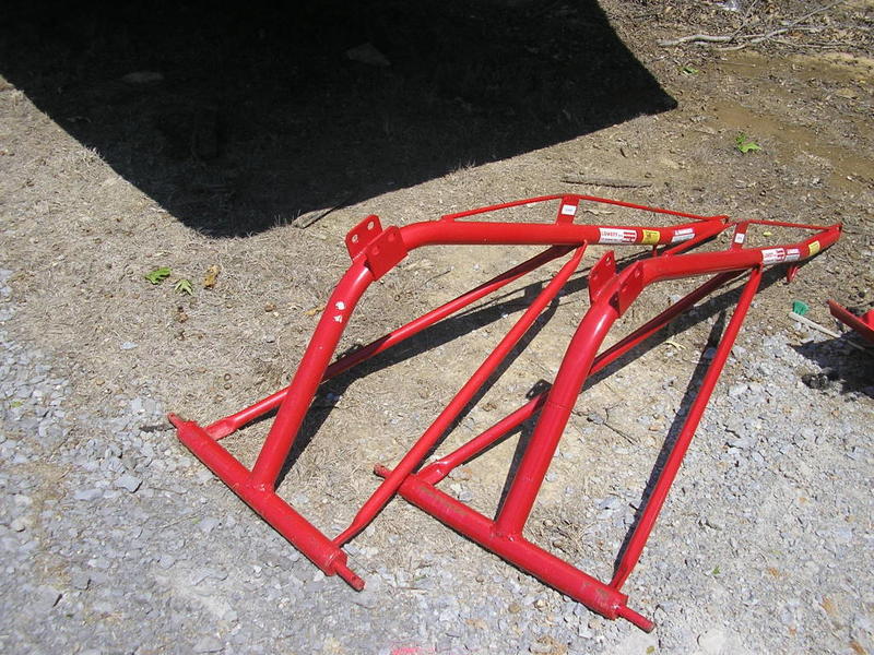

That lightly fabricated boom pole will definitely not safely lift very much weight at it's tip.
   / Need ideas for adapting boom pole to FEL/pallet forks #5
A lot of options, depending on your tools, available materials, and budget.

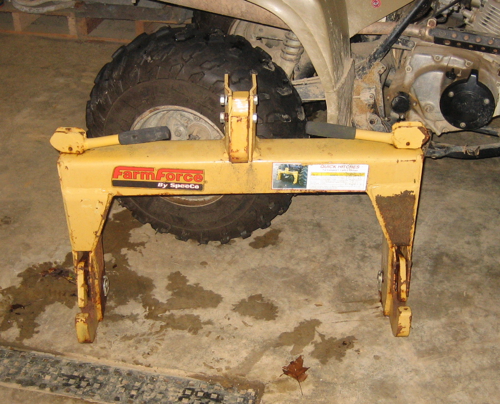

I would avoid using a chain for the top link in case you were ever stretched out to near vertical it could come back on you. I think aftermarket top links are inexpensive and the adjustment might be handy sometimes.
The inserts you mentioned that slide in from the top might be a good way to adapt that Speedco type 3PH frame into your pallet fork frame and still be removable.
Correct. It's rated for 500lbs at the end-ring. For this application, I don't anticipate lifting anythng that weighs more than 200lbs.

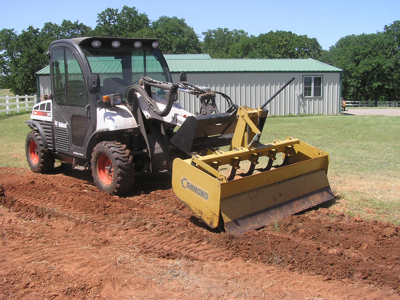

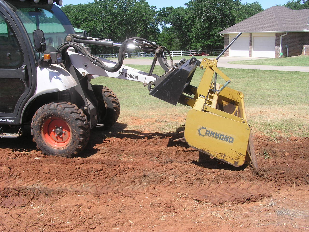

This gets my vote because you can use other 3 point implements on it. Would be very handy with a landscape rake.
I have one with extra rollback built in, that gets a lot of use:

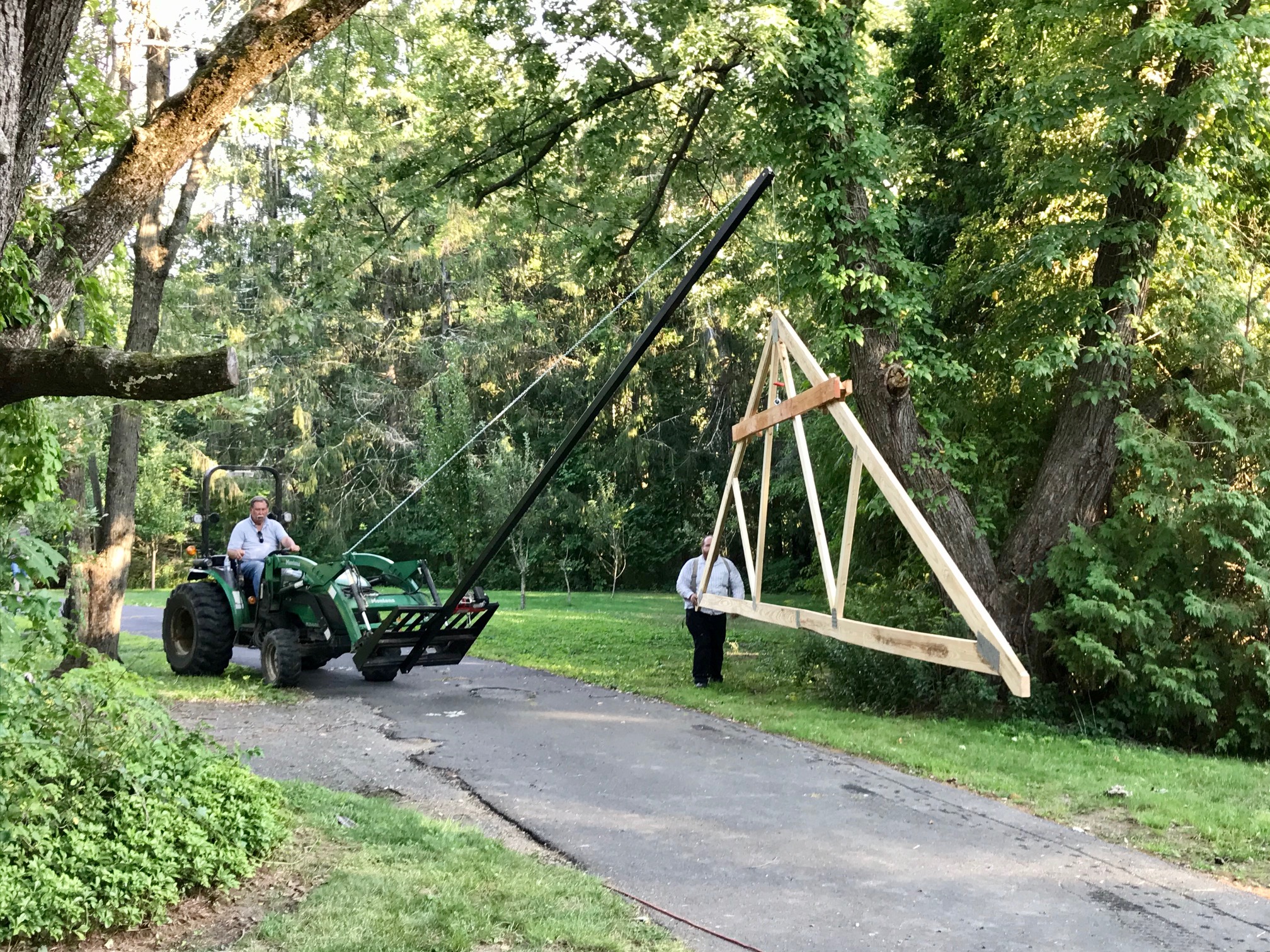

Did exactly what you are planning this past summer. Raised a pole barn and set trusses on 12' walls. Bought a 20' square pole for $100 and attached a Harbor Freight electric hoist. Allowed us to easily lift the trusses and raise them up and down with precision to set them exactly where we needed them. Supported the pole with chains attached to the front end loader mount. Built a jig to attach to the trusses so we could pick them up across multiple places so we would not damage or overstress the trusses. Screwed the truss to the jig so there was no chance of dropping the truss accidentally.

For my version I used a 4" "H" beam 20' long with brackets welded on so it would slide over my forks and a chain to hold it from sliding off if I pointed it down. I set trusses on top of a 10' wall and 24' wide building so I had to reach over 12' to set them. Trusses are 24' wide by 5' tall. My loader is rated for 3000#, but with the 20' extension I was limited to just a few hundred. The 24' trusses weighed about 150#.
I second this! For my pole I simply added a short length of chain and some metal hooks to pick up trusses. I just finished placing trusses on a 30 x 50 shop, 16 foot walls and 5x12 pitch. Easy-peasy. With this kind of extension you learn that the curl circuit is too fast, easier to tweak placement using 'angle of the dangle' and the loader circuit.
