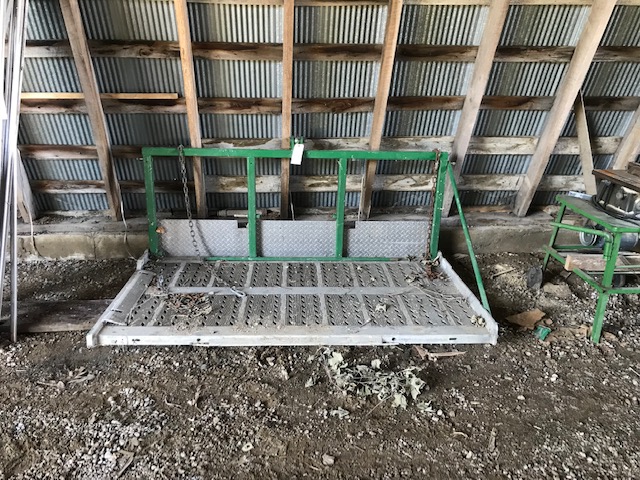

Attaches to 3-point hitch

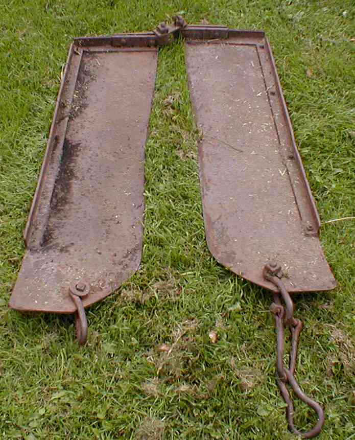

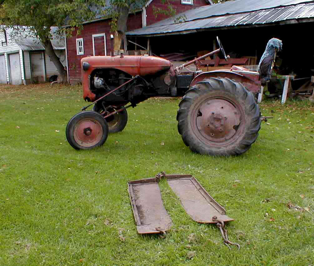

The largest I estimate at 32 cu ft, or around 5000 lbs. Others are variously smaller. The solutions using the three point are less attractive because you need a way to load and unload, and it'd be too time consuming to detach the sled, load it, re-attach it and go. If I had to do that, I'd just pay my excavator guy to ferry them himself. The split boat idea is cool in that you can pull it apart when the stone is where it needs to be. Plus, the ground they're going over is just field turf, so there's no issue with ground damage by sledding them. Some very cool ideas here though.
