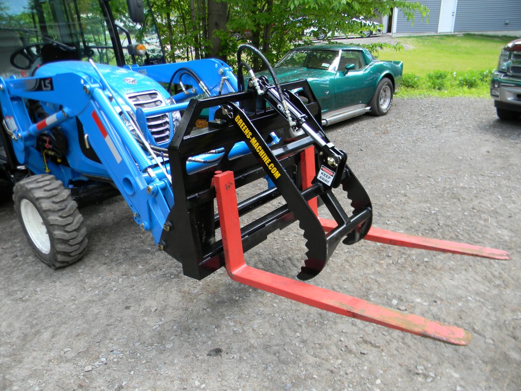

Thanks folks! I'm going to go with my existing rear remotes and just get a set of hoses made... It's the cheapest option and if I feel I need something different later, I can do that...
Any recommendations on type/size of quick connects and hose? How about a hydraulic hose shop? I just don't know where to go..
BTW, since I've owned my CUT, I've never had the hoe or FEL off of it... I swap out the bucket now and then for pallet forks, but never needed to remove either.
Thanks again!!
Crabjoe,

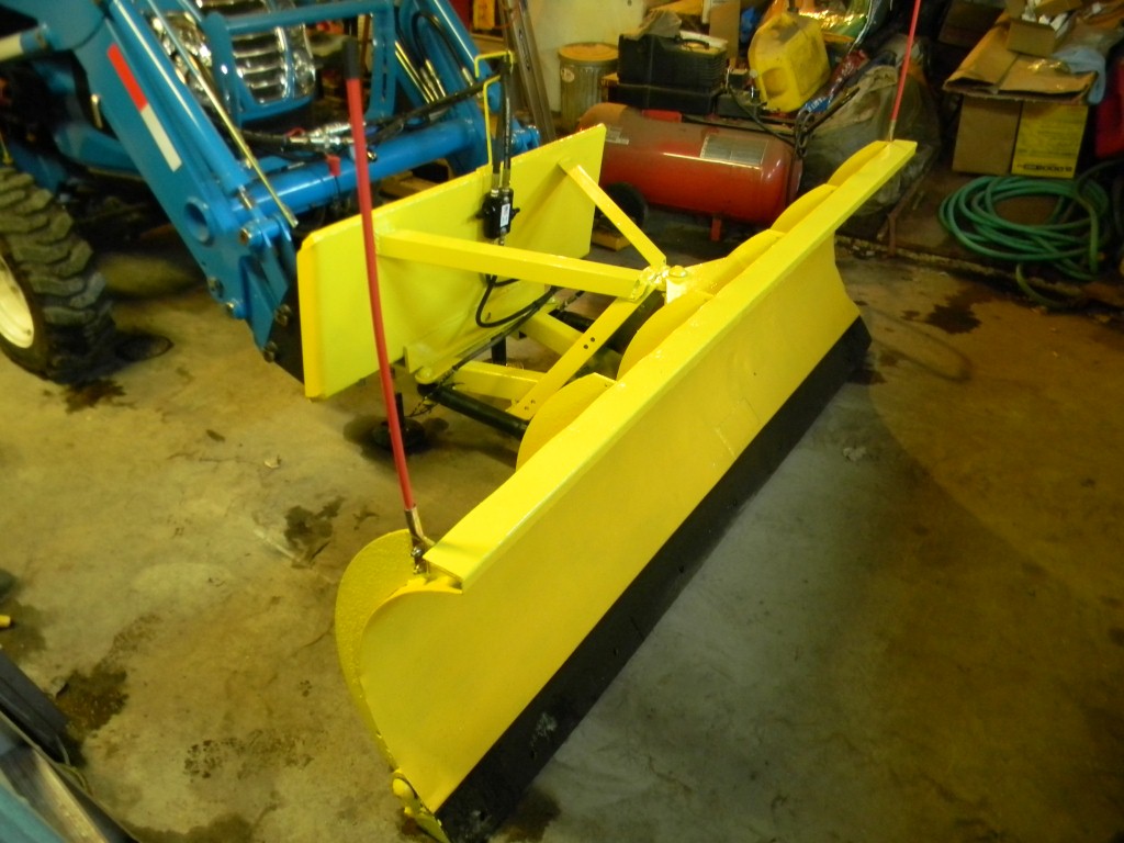

I bought ready made 1/2" hydraulic hose and all quick connect fittings from my local TSC store. Ran them from the rear remotes to the front and secured with zip ties. I can use whatever front hydraulic attachment I have and control with the remote lever in the cab. My cost for everything was around $200. and I bought extra QA fitting to have in stock. I use the front lines for my QA PA truck plow and hydraulic thumb on my forks. Attached is a list of what I bought with part numbers.

Crabjoe,
George,
Thanks for the info, but I went ahead and order the Front Hydraulic hose kit from Bob @ Michigan Iron yesterday. There's 2 reasons I went with them. 1st I needed filters for CK20S HST and the 2nd was that I didn't want to have to try and figure out which way I needed to route the hoses to take a measurement. A plus is that I'm dealing with one company.
BTW, what I was told about MIE's kit is that it comes with everything.. 4 hoses, 90 couplers for the rear, bracket by the FEL to allow disconnect of FEL without having to remove any hoses, and a torque tube bracket to hold the end couplers. I requested a male and female Ag couplers for the front end. $350 wasn't the best price, but it works for me since I don't have to figure out how to route the hoses nor take measurements.
