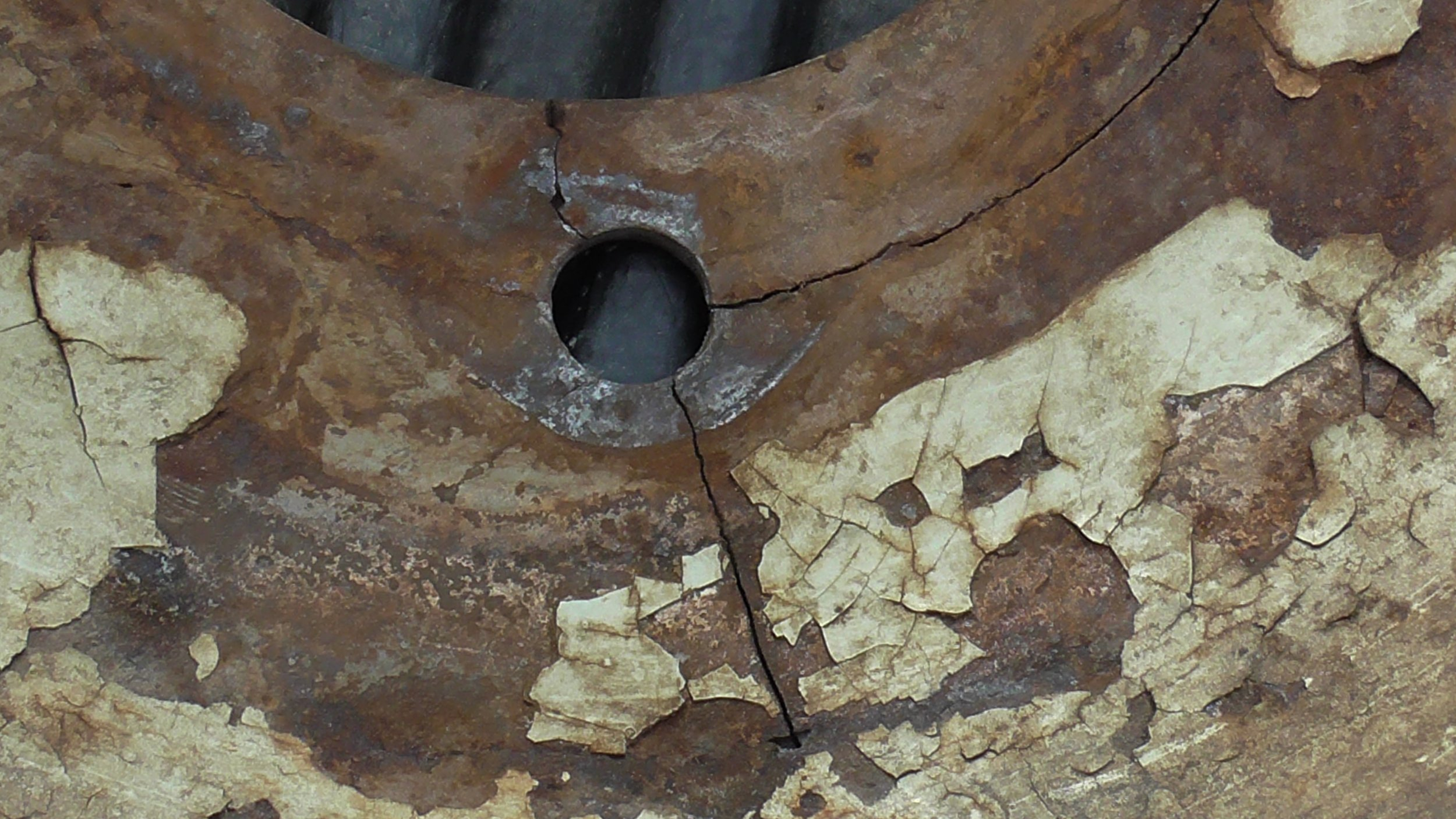

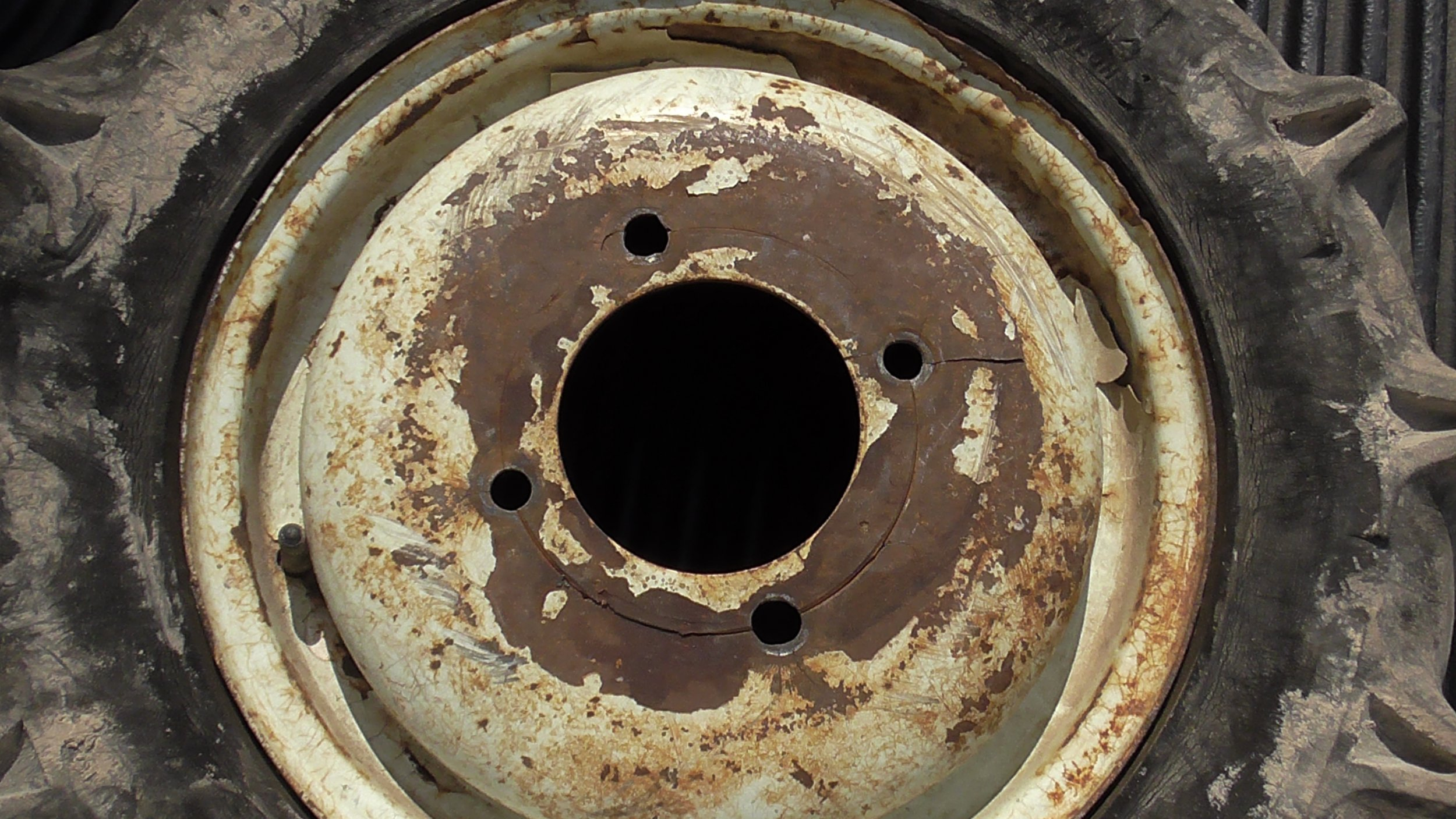

I just discovered major cracks in my right front rim. There is a major continuous crack running between 3 of the 4 lug holes.
Does anyone know if there is a generic replacement rim or part number?
This is the 4WD model and it uses a 6.00-14 tire. The lug
hole spacing looks to be about 5 15/16" and the rim center bore hole is about 4 3/8” diameter.
I'm in Louisiana and hoping to find a local replacement, but will probably also check with Valley Power on Tuesday.
Comparing pics of the tractor from 2011, looks like there were already cracks when I purchased it, but now the wheel is only supported with one bolt. Greatly appreciate any information on a replacement, Thanks!

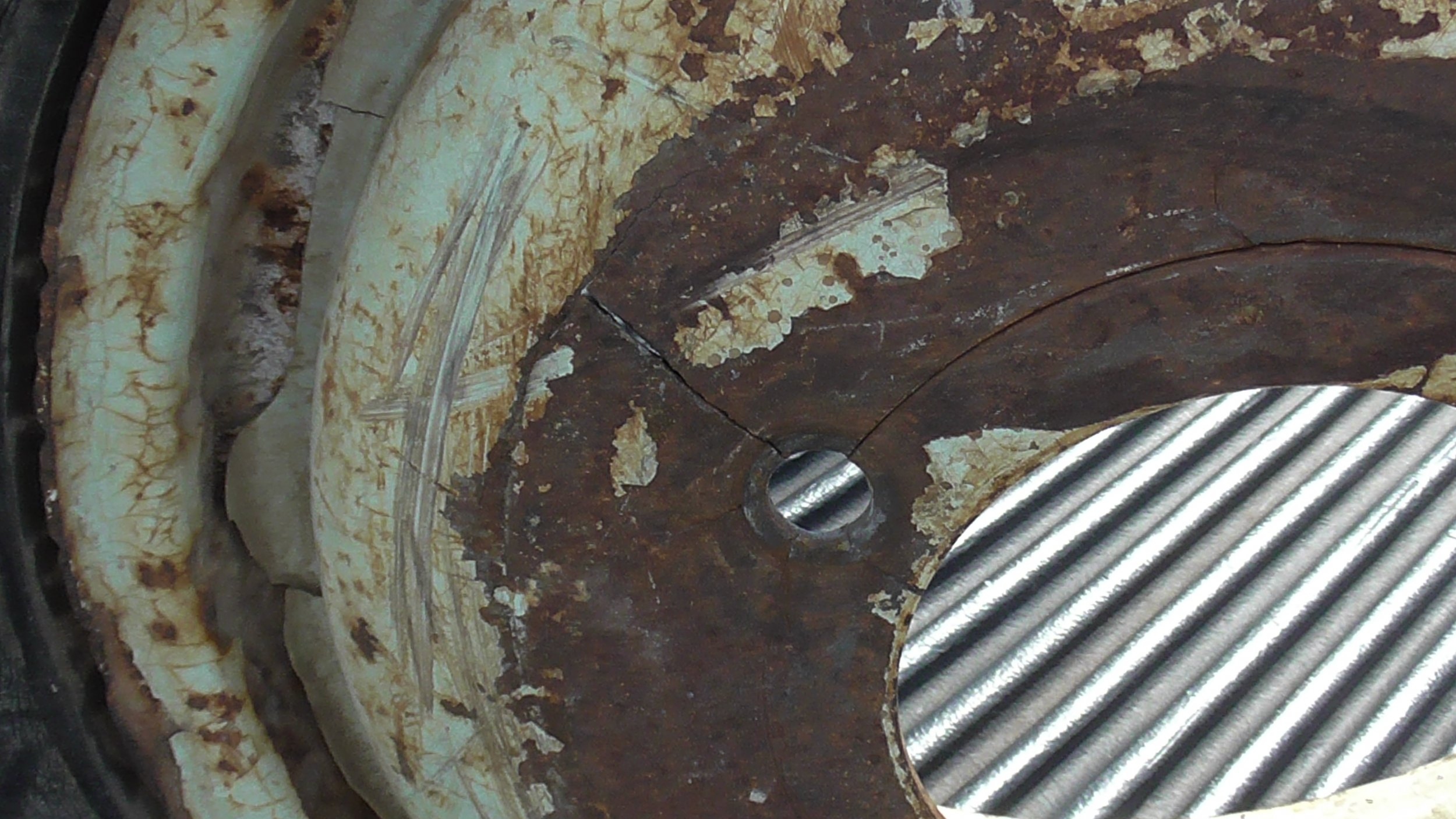

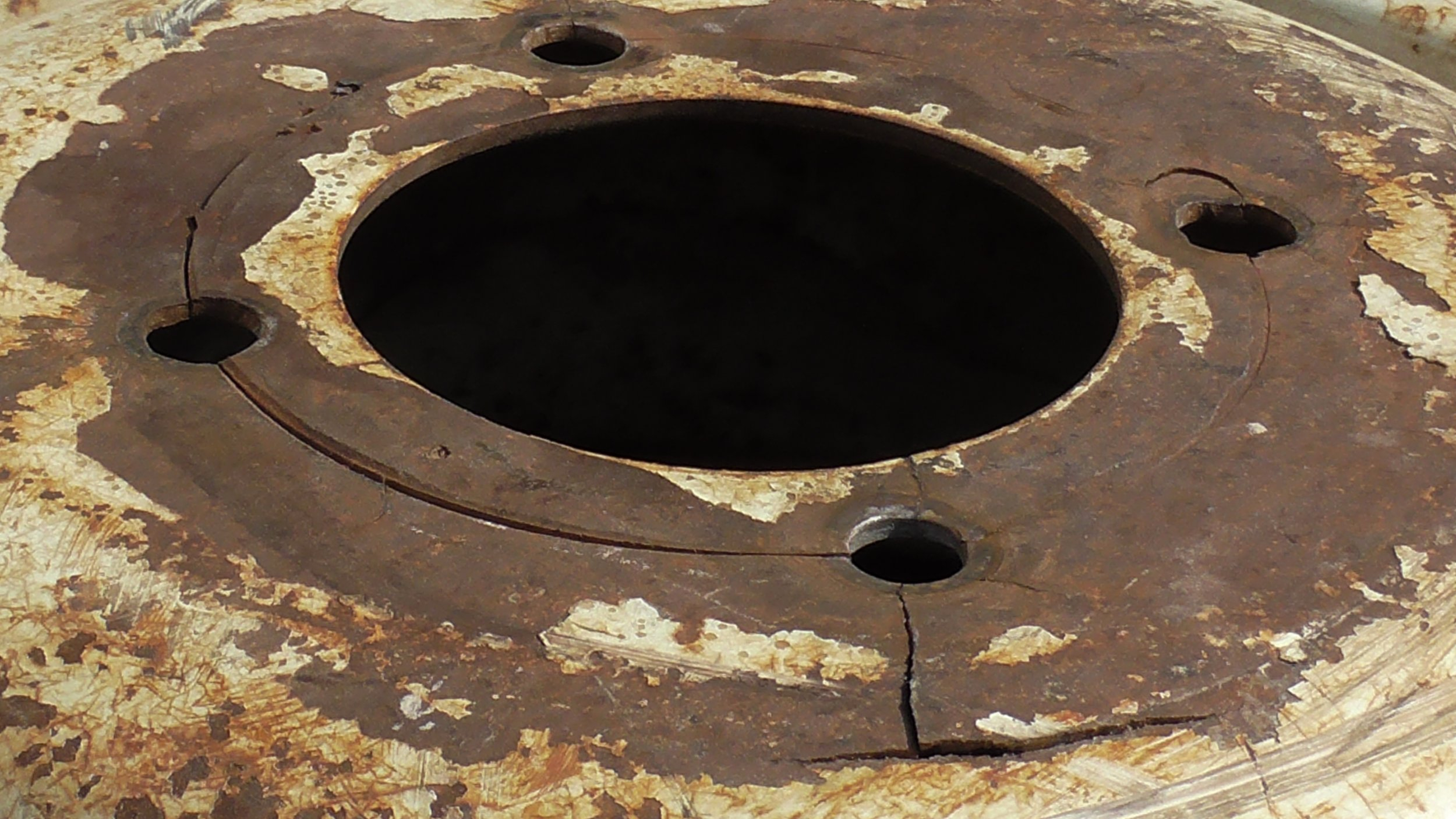

Thanks for the replies and ideas, I was really interested in trying to get an insert made and welded.
When I took pics to attach today, I noticed more cracks/fractures that actually run outward from the lug holes into the curved part of the rim.
I've had this tractor for a little over 10 yrs and only used it for light 4ft bushhog and grader blade for gravel drive and typically dont have 4wd engaged very often. However, when I purchased it, it always seemed like the right wheel had a little tilt/slight wobble and I had thought possibly bad stub shaft bearing. But when I removed wheel and checked the shaft and kingpin case, I didnt find any play in the shaft.
I looked at my pics from 2011 when I bought tractor and the crack line by lugs was lightly visible in those pics but looked more like a rust line/crack in paint (the line looked like rust from where wheel weights were mounted) rather than a rim crack but evidently it was cracked when I got it. (Wondering now if prev owner wrecked it..:confused:)
CausticUrbanCoast, thanks for the thoughts about the steering stops, I'll check the stop angle and toe in. I've always used left/right brakes for tight steering, especially on my Ford 850. Even though this tractor is much smaller, its never seemed to have a really tight turn radius compared to the Ford, so hopefully the stops are set ok.
Please keep the ideas coming and let me know if this could still be a candidate for an insert or whether it would hold up with these additional cracks, Thanks!

Brief update--I spoke with Valley Power and others regarding the rim.
The rim is beyond repair of just reinforcing the center lug area as additional cracks and holes were found in the rim bead area.
They also suggested getting a new blank 5x14 rim and having the new center with proper bolt pattern and offset welded in.
I see online that Hey Wheel and some others will make these, has anyone had experience with Hey Wheel or other companies?
Thanks
   / Need Mitsubishi D2000ii FD front rim info #10
I make these. I have centers plasma cut & use new rims.
