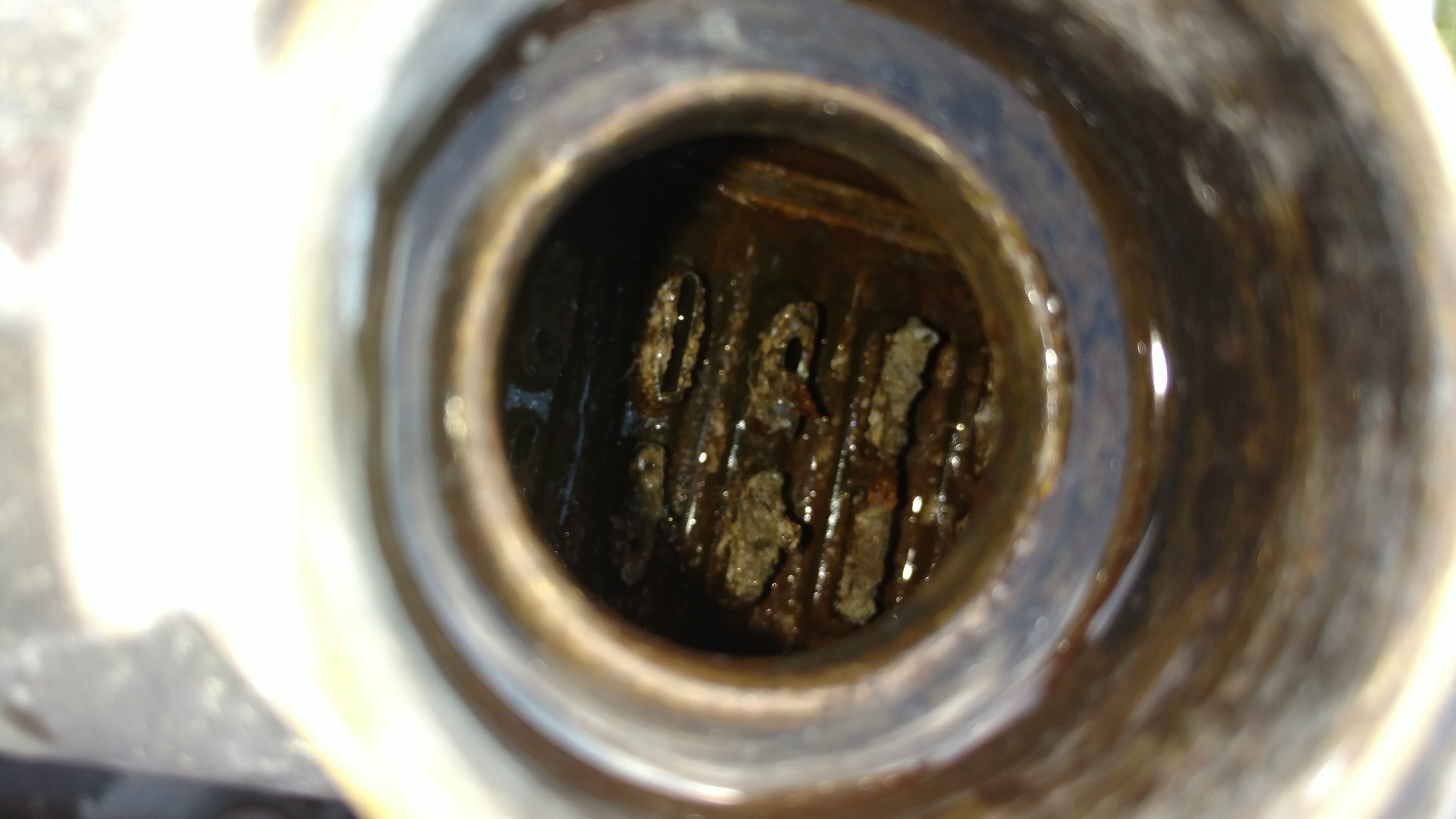

There should be a decent flow. After 5 mins you either have a blown head gasket or a bad pump would be my guess, that's almost no time! Or your rad is clogged but if you said it takes the whole hose flow and doesn't overflow that kind of rules that out.
If it were mine I would pull the pump I think.

Well I keep thinking that if the water flows good when back flushing then there isn't a blockage anywhere. Going to pull pump tonight.
Also take that heater thing there talking about out, even just temorary, unless it's literally a straight through pipe but if it has fins inside you know it's restricting.

Ok here I go....
It fires right up after sitting a day or two so I don't think it's a head gasket or it would be hyd locked or struggle to start.
Thanks for advise on brakes and axle seal. I looked at it closer tonight and it has tons of grass wrapped around it. I will start by cleaning that out. Maybe some is under the seal.
I pulled the water pump and all looked good then I looked in the now drained radiator and Bam there is the problem. It clogged.
Going to take it and have it cleaned and pressure tested and try again.

A proper back-flush should have blown that out. How did you do it?.
   / Need more help with my ym2000. (Over heating)
#28
Disconnected the top hose from the radiator put the water hose in the radiator hose and clamped it tight and let it flush for 5mins
