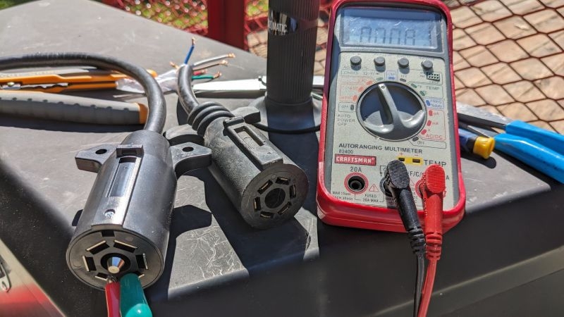

I double checked resistance between the plug contacts for ground & brakes. You would expect to see one ohm or less (1/4 the value for a single magnet). What I found is that I sometimes got OL (no continuity) even with the side of the probe pins making contact with the brass contact. Moving the probe pins around, pressing deeper, would then produce a reasonable value (between 1 & 0.8 ohms) I'm starting to think the plug is faulty & the contacts are not always properly connected to the cable wire. A new plug is starting to look like the way to go.

Picked up a plug last night & put it on today.

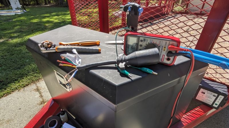

I cut off the old one with enough length that I could match wire color with contact via the multi-meter. (no surprise, the blue brake line had sporadic continuity)

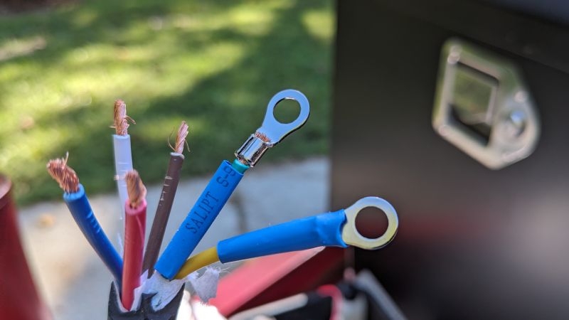

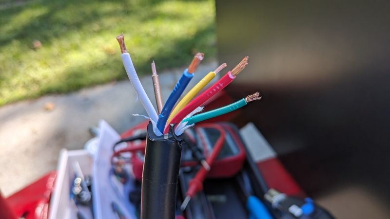

Stripped back insulation & trimmed wires in cable after threading through new plug body.
Crimped on ring terminals after adding heat shrink
Torched the heat shrink after all rings installed

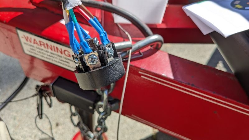

Installed wires on plug contacts after checking color placement via the old plug. Turned out the color pattern was as expected, but better to check & be sure.
Reassembled the plug. Just for fun, placed jumper clips loosely in GND + brake contact locations. MM read 0.8 ohms, so brake connection looks good!
