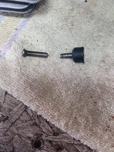

I remembered that when I tried to pullstart the machine, I pushed in the decomp valve as usual. But then, even though it wouldn't start, and got stuck, the valve button popped out. So something is wrong with the valve. A few minutes studying at YouTube University yielded a video describe just this

I had an aha moment. When I tried pullstarting, I pushed in the decomp valve as usual. It popped right out even though there was no start. I found a YouTube video describing a similar situation, in which part of the valve fell off and into the cylinder. Maybe that's what keeps the piston from moving. If I can get to our property where the saw lives, I will look into this. Lots of snowy, icy, hilly roads between here and there.
If that's it, the first thing is to extract the debris, and the second is to figure out what damage has been done. Getting a replacement valve and screwing it in should be simple.

Stihl and afm decomps known for this.
Why I always try to keep husky decomps on hand.

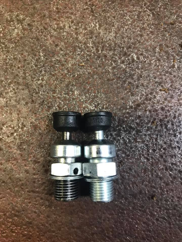

   / Need replacement for Stihl ms241 #38
Stihl valves sometimes do that. I have one that does. Some people drill out the outlet hole but a Husqvarna valve, which works better, does not cost all that much.

   / Need replacement for Stihl ms241 #39
When I rebuilt my MS250 I took a bunch of pictures but Eric sent me a manual also which helped a lot. I have a MS 261 and the decomp valve pops up after most pulls of the rope even if it doesn’t start. I forget to use it half the time, it doesn’t really pull that hard not using the decomp valve.
