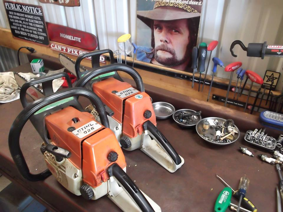

T27 green handle one in this brand at bottom right. For stihl.
