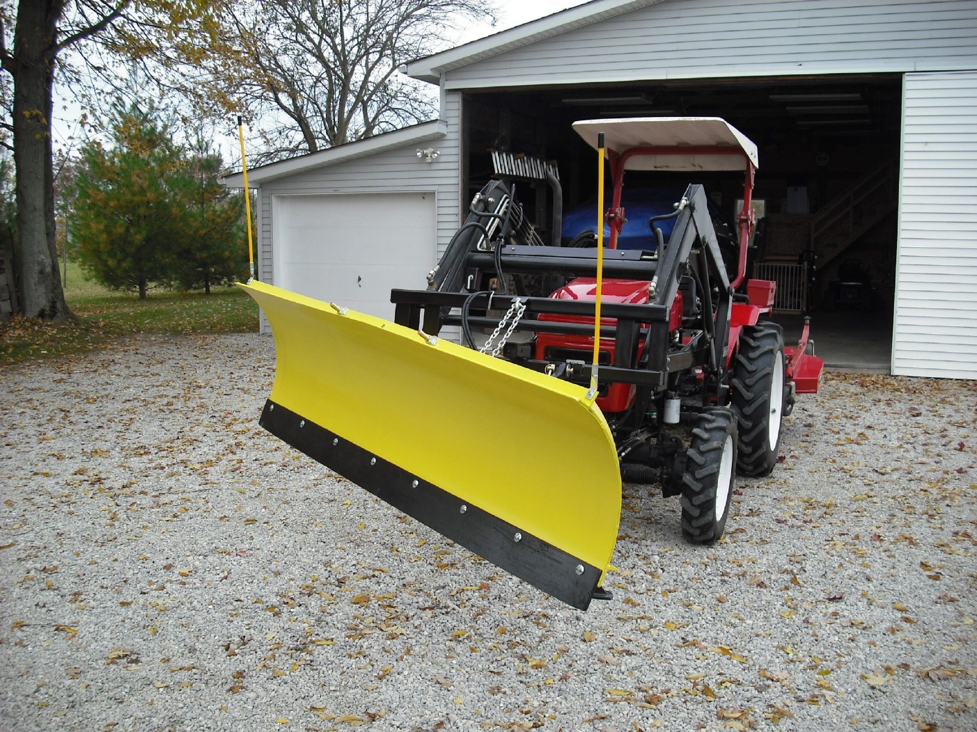

Check Craigs List. I got a rebuilable one on there for $80. It was a Meyer off a pickup truck. I put a new 11ga face on it, sand blasted it, new bolts and paint.

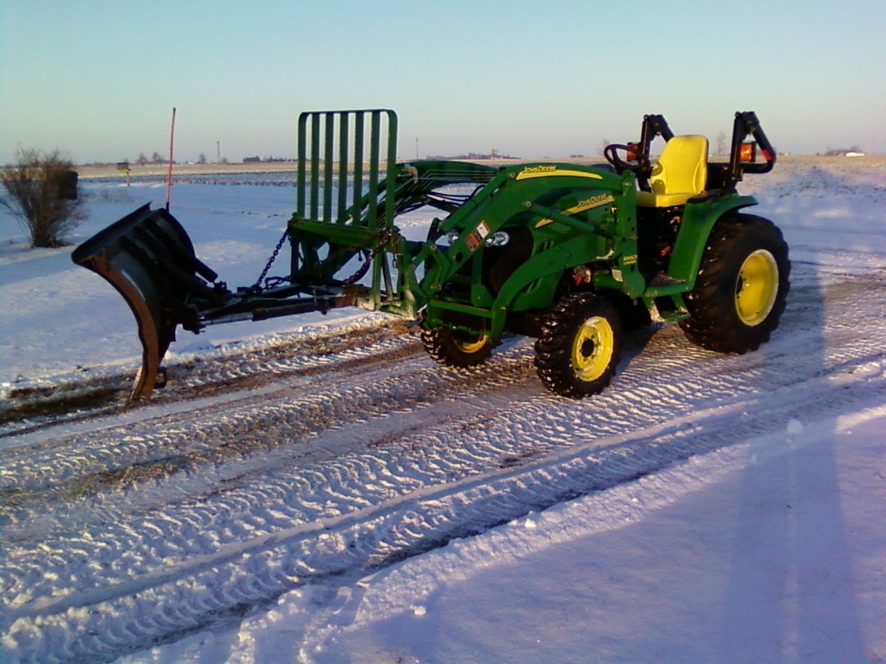

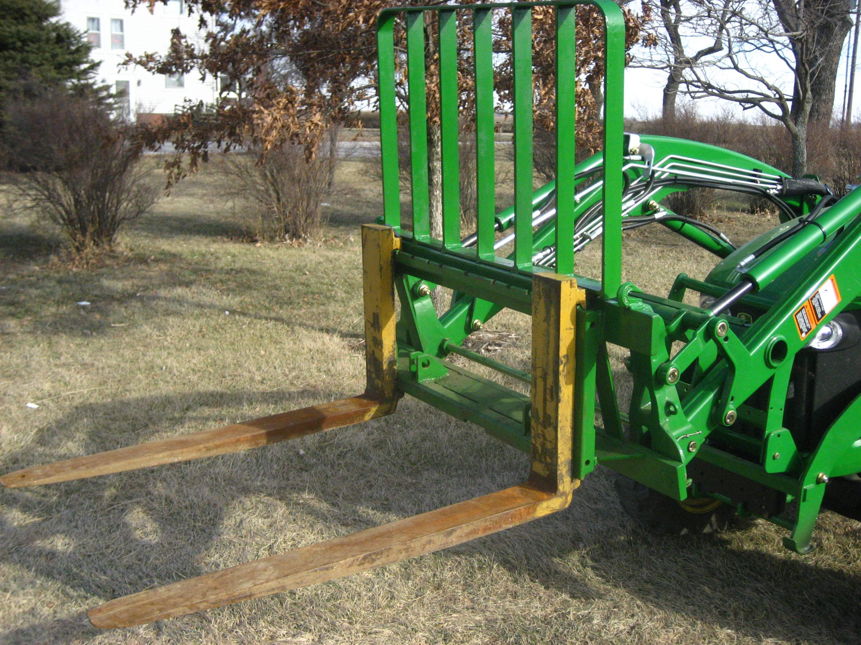

I put this together last year but I am going to cut it apart and make it like Chris did. I removed the forks from my fork lift attachment and attached the plow to it. I have hydraulics ran to the front for my 4in1 and angle the plow. I am out by Warrensburg if you want to take a look some time.

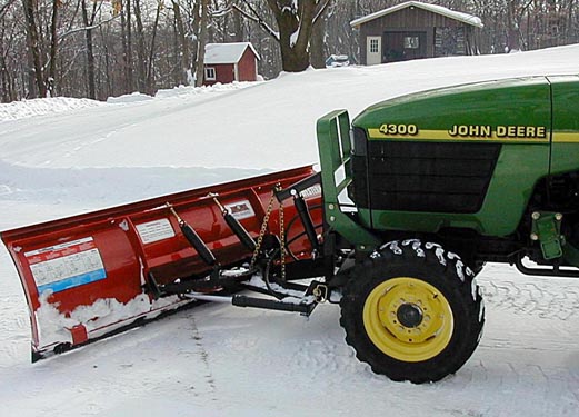

The FEL comes off so easy (like my Deere 4300) that I mounted a quick hitch to the front weight bracket (and the two MMM front plates) to keep the plow closer to the mainframe.

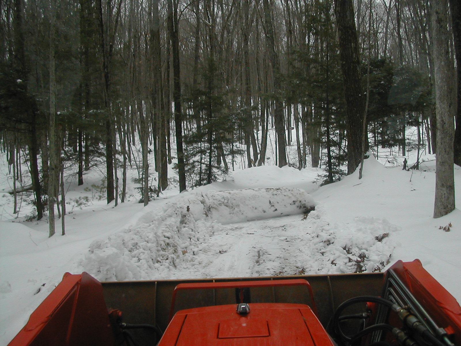

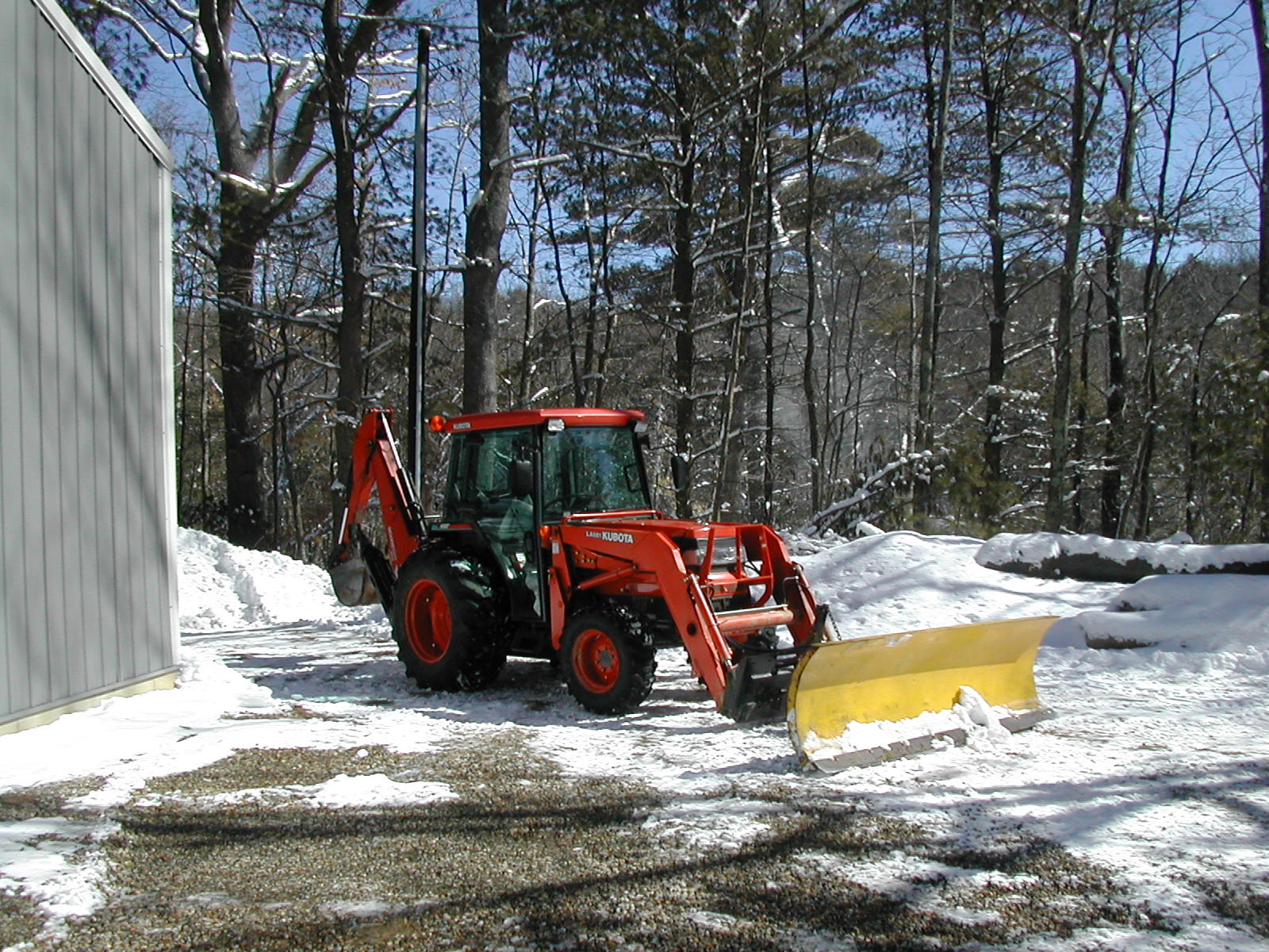

I though we needed to get Orange represented saw a lot of Green. Good idea to put the plow on the loader arms stacks snow wicked high. Recommend you used a pressure release valve on the angle cylinders helps to keep the arms straight.
