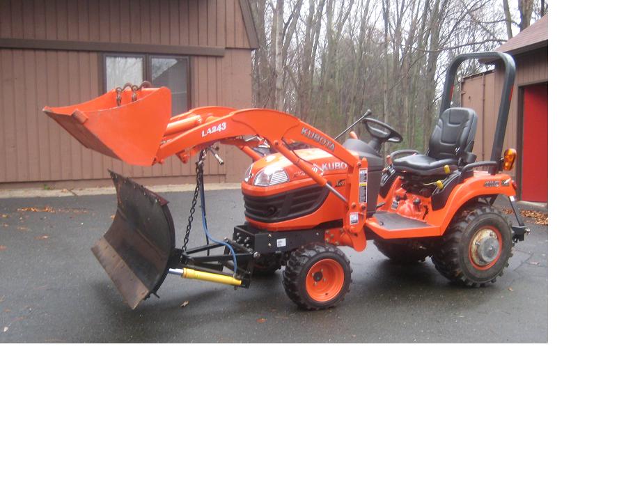

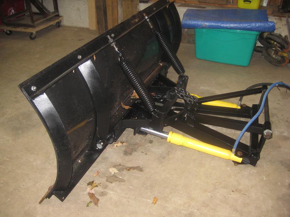

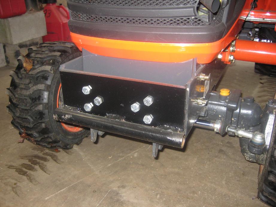

I put this together from a 7 Meyers that I cut down to 67? The skin was rotted so I removed it, did my welding had it sand blasted and painted it. Then I bolted on a シ thick poly skin. I made an adapter that is bolted to the front of the tractor and uses 1 pin to connect it. I use the FEL to lift it and the bucket hydraulics for the swing cylinders. Takes about 2 minutes to hook it up and you don稚 need to remove the FEL to use it.

Seems to me there would be visibility issues with the bucket and the plow both there? Like looking around a 4' plate of solid steel. I do like the simplicity of it.;)
