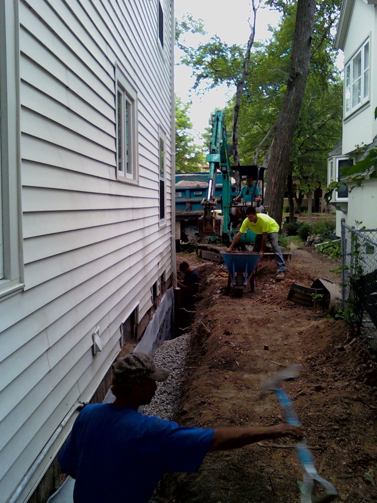

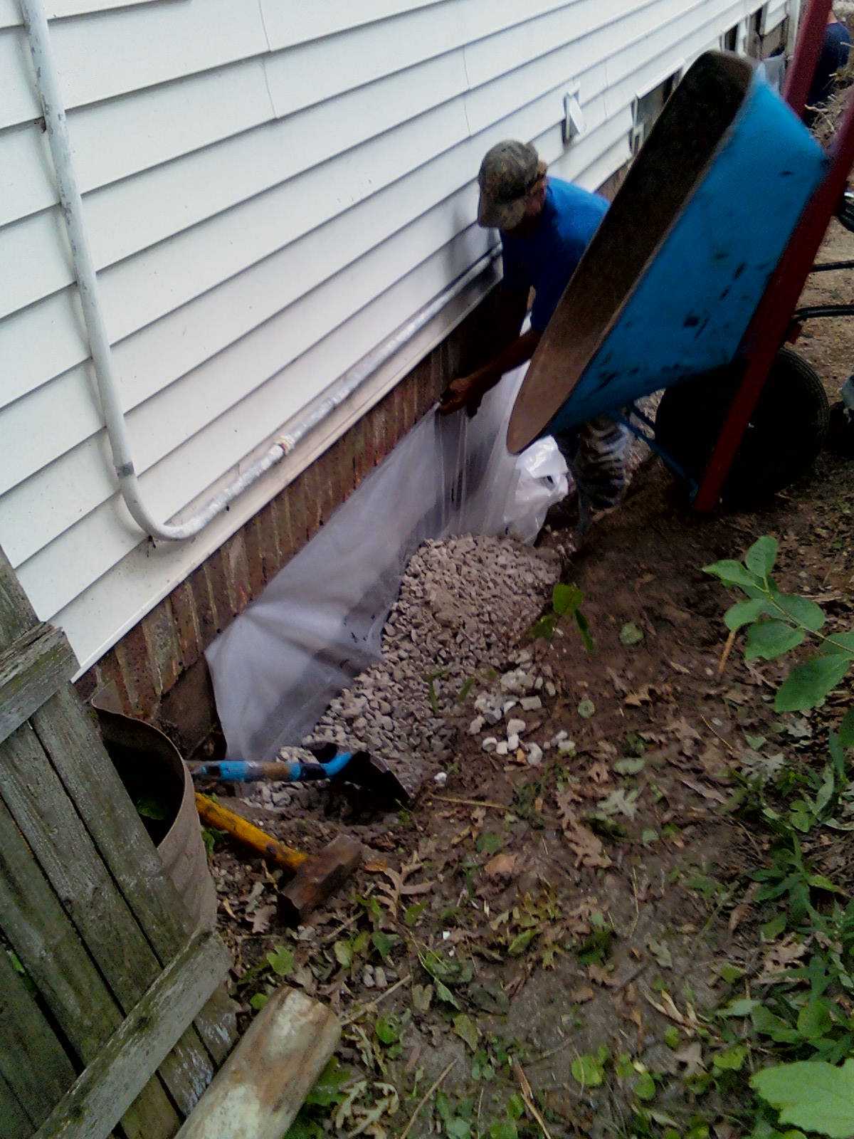

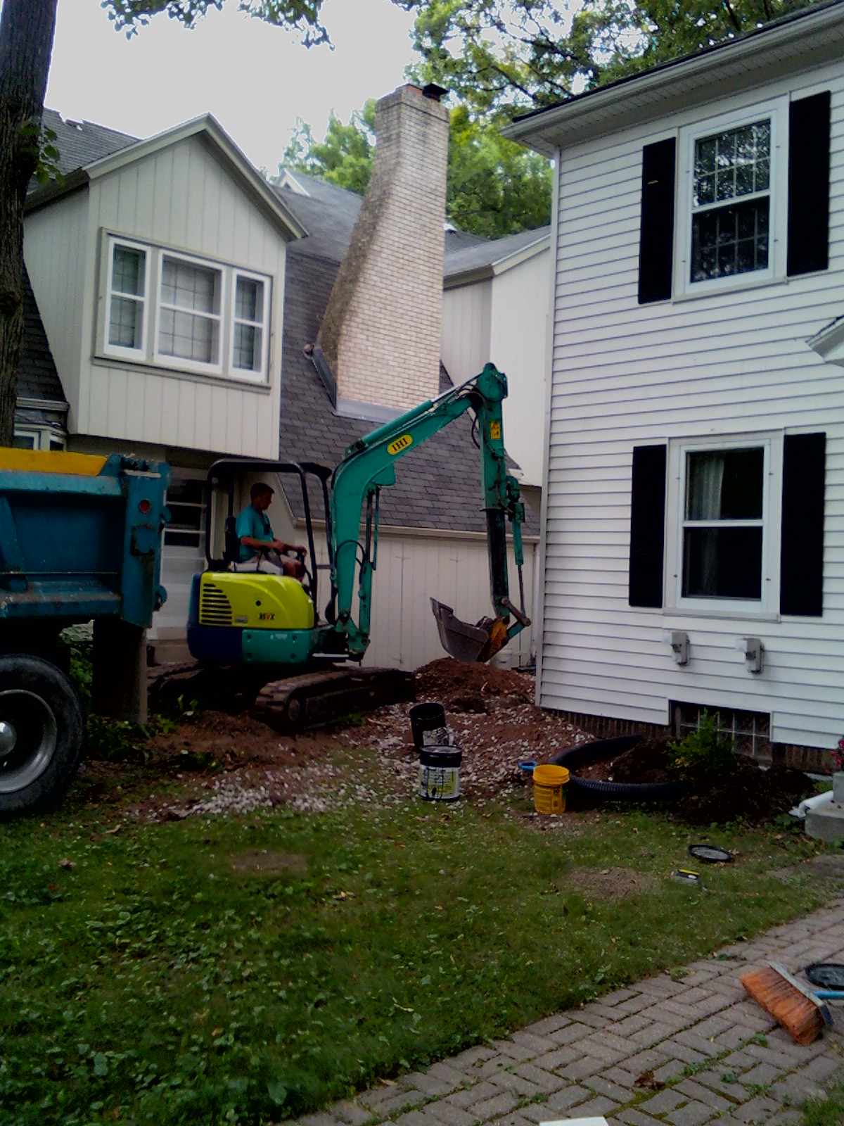

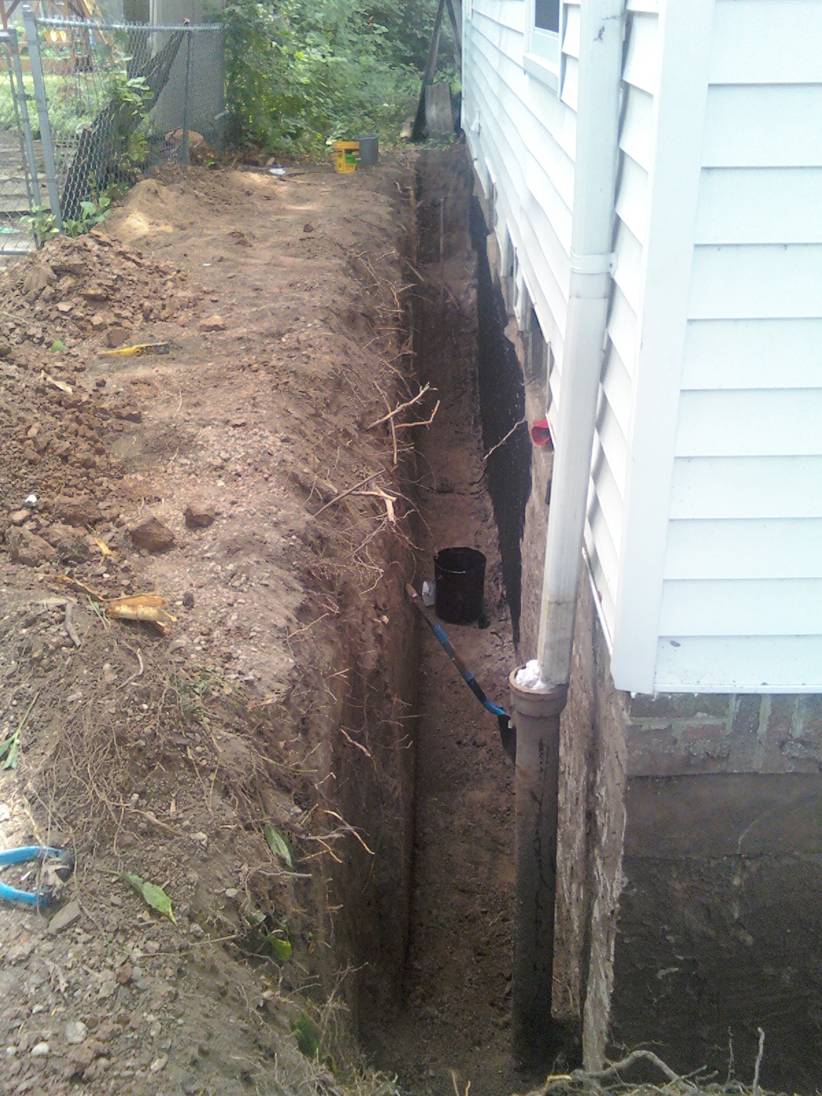

Here's a few pictures of exactly what you are talking about in your first post (I think). This was a house with a basement I owned in clay country in SE Wisconsin. The excavator came in with a mini digger and mini truck (small lot) and dug it out, laid the pipe, waterproofed the wall's exterior, installed a vapor barrier, filled with stone and did the final topsoil finishing all in a day and a half. $4500. **** cheap for the work they did.
Regards,
Jim
