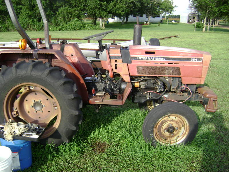

The 3ph hydraulics on my compact IH 254 stopped working the other day after a weekend of shredding. No warning or nothing. I shredded, parked the tractor, and the next time I fired it up: nothing. No 3ph movement at all.
The only hydraulics on the tractor is the 3ph. I have some water in the oil and was gonna change it. I'm getting fluid moving through the system and some pressure from the pump.
Can someone help me troubleshoot this? I have very little experience with hydraulics but I have worked on other parts of the tractor and on various vehicles. The folks over at yesterdaystractors didn't offer much help. I think their threads get buried pretty fast, or something.

Well, start with the mechanicals. Is there a valve lockout (twist knob)?. Are the arms up or down? Oil level up, filter plugged. hissing sound from a stuck poppet valve, bent control rod, rock or branch stuck in mechanism. Have at it tonight. call us in the morning.

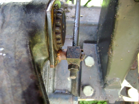

Norm, I have an '83 Mitsubishi MTE 2000D which is the grey version of your tractor. My 3 point quit functioning several years ago and it was caused by a roll pin that had worked itself out of the rockshaft that passes through the top of the 3 point hydraulic housing. The pin is located on the right side and is in the end of the shaft by the top lift arm of the 3 point. The pin holds the position control sensing rod. The rod runs to the lift control and is part of its linkage system. Unless the pin is loose and sticking out it is hard to see. I originally found this to be the problem by looking under the seat and you will be able to see the rod I am referring to, it is threaded with a spring on the end. With the tractor running, try using a screw driver or short pry bar and where the rod passes through that part of the control, move the control back and forth and see if the 3 point functions. You will probably need to have the 3 point lift control in the "up" position. If the 3 point works by doing this it is either the pin or the linkage is out of adjustment.
The 3 point on a larger Mitsubishi I owned quit suddenly and I found that the hydraulic control valve for the 3 point had a tiny piece of RTV sealant in one of the orifices inside. It was a pain to figure that one out but it saved buying a $900 valve.

I have the seat and the other body parts above the hitch cover off already. I've seen the spring-loaded arm you're talkin' about. I'll look at it better in the morning and get back with ya. Thanks for the idea and link.

@Darryl,
I checked this morning and I don't think my linkage has slipped as you described. I attached an image for you to look at. Hit me I misunderstood you.

Norm, The lock out valve that was referred to is described as the "flow control knob" under the "hydraulic lift system"/troubleshooting section of my I&T manual, it is the adjustment for the speed at which the 3 point lowers. If it is turned all the way open ( open should be all the way counterclockwise while looking at it) it lowers the hitch fast, turned all the way closed-it locks the 3 point on the down stroke) On my tractor it under and between your legs while seated, on yours it is probably on the trans housing behind the shift lever.
In the first picture you posted, I cant see if the pin is there or not. It is there to keep the plate on the rock shaft in a fixed position to push/pull the sensing rod as the rockshaft turns (if that makes sense to you) if the plate that the sensing rod attaches to moves freely (swivels) on the rckshaft- the pin has fallen out or sheared off, if it doesn't, it is probably not your problem. Have you tried to function the 3 point manually as I described? A better way to do that might be to take the sensing rod off at the rockshaft end by removing the cotter pin on the pivot. With the tractor running and the 3 point's lever in the fully or half "raised" position, manually push/pull the sensing rod and/or use a screw driver to push/pull the piece that the sensing rod goes through under the seat area. If the hitch works that will tell you if it is in the linkage system. If the hitch doesn't raise after doing this it could be a worn o ring in your pump, a worn control valve o ring, an obstruction in the control valve,bad o ring on the 3 points hydraulic piston etc.

The rockshaft pin is still in place, unsheared. With the engine running at 1,300rpm, the 3ph lever in the up position, I was able to move the lever on the other end of the sensing rod with no affect. Nothing happened.
