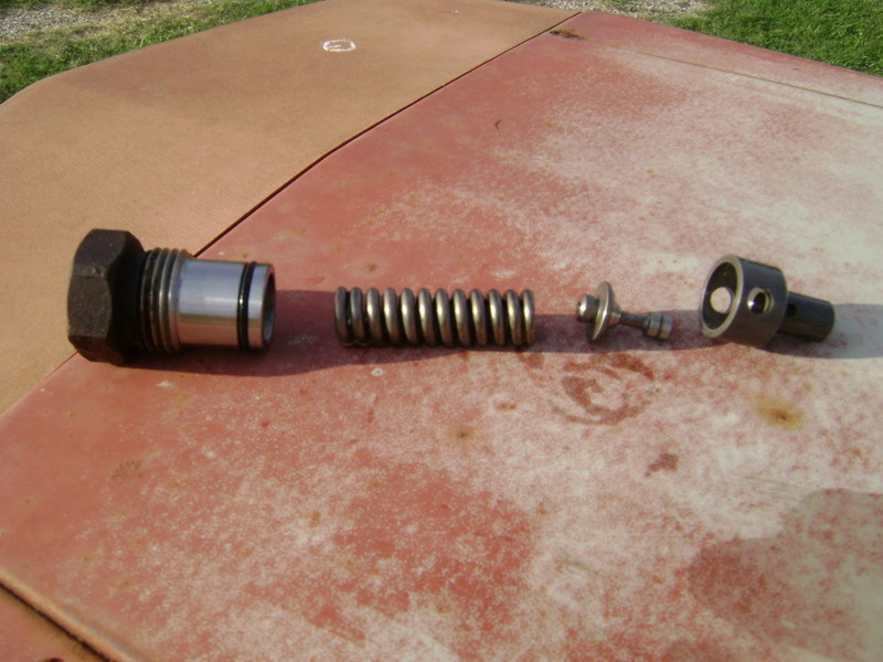

I tried the gauge in the pipe port next to the drop speed control valve, just under the front of the seat. I had the sensing rod disconnected and I had the position lever in the "raise" position at RPMs from 900-2,400. The gauge didn't move:(
So I removed the relief valve for inspection. I did find a couple of rusty looking bits deep in the housing. They looked large enough to be a problem. However, I saw no rust on the inside of the housing. I cleaned the housing, reassembled the innards, replaced the whole apparatus, and fired the engine up. No luck; still no 3ph movement.
The counter guy at our NAPA said he suspected the pump to be the problem. However, I'm still unsure about the pressure.

Well, your knocking the list down, and that's good. It's not the relief valve or the control linkage. That pretty much leaves the pump or control valve. The pump may be moving fluid but what seems like a lot of psi can be really deceiving. To rule out the pump its going to HAVE TO BE tested with an accurate gauge and I'm not sure just how to do that. I know what you mean by one hydraulic line, etc. The only thing I could recommend to do without hooking the gauge to the end hydraulic line where it enters the hydro housing which would dead head the pump and probably hard to do because of the type of fitting on the end is to cut the hard line and put a "T" in it for the gauge....that's easy for me to say though because I've already had to cut mine and plumb it for my front end loader. Discount hydraulics has 1/2" compression fittings for the hard line, if you want to go that route and you could just cap off the "t" when the gauge isn't connected (or even just leave the gauge but it might be in harms way because of the line routing.) Flareless Compression Hydraulic Tube Fittings (My line was actually 12mm but I used the 1/2" and cranked it down HARD and it has worked fine. If yours are 12mm, "EFC"- a member on this forum carries 12 mm fittings and can be reached at 509-374-3398 ext 2 for service).
Something else to think about is maybe you aren't getting a pressure reading because the problem IS the control valve. It's a 50/50 proposition at this point which way you want to go. Maybe it is easier/makes more sense to check the control valve next and if you don't find anything there go back to testing the pump. Just my 2 cents.

I'm going to query the Case/IH dealer Monday about where to attach the gauge. I think that is easier than removing more bolts or cutting the hard line:p Then I'll know for sure about the pump. Accessing the control valve requires unhooking the shredder, and removing the hitch cover with the lift arms; not looking forward to that. And I'm still concerned about where that relief valve trash came from.
