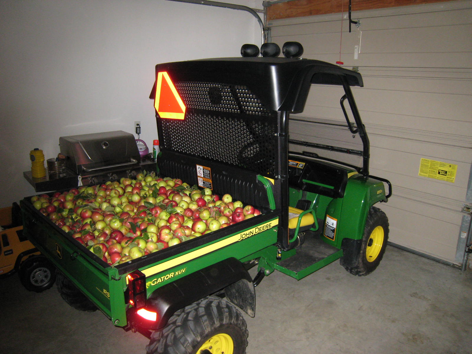

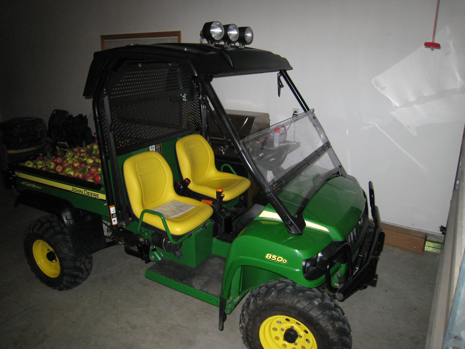

Gentlemen,
I need some help with a new to me Gator XUV. Its a 2007 Diesel that seems to have many options on it. This was an odd deal since my father picked this up for me and he did not do what I asked. Instead of looking things over and asking questions, then calling me about buying it, he just bought it.
So, I paid 9,000 for this with 50 hours, includes a plow, hydro bed, taillights, offroad lights, bush guard, and some other stuff. Pretty fair deal.. BUT..
This has never had the oil changed. I will do that ASAP. Nothing has been lubed, and nothing has been taken care of. At least not to my standards
So, could you guys clue me in on things I should look for. I have the brake recall, and I dont think I am in that. I heard about a clunking noise, dont hear that... What else should I look for, or change.
Also, when it is at idle, it has a sort of rattle to it, sounds like it could be the clutch? It actually sounds like the muffler insides are loose, but they are not. Also, it seems to need a lot of rpms to move. Might just be me not used to it...
Thanks for any and all help!
