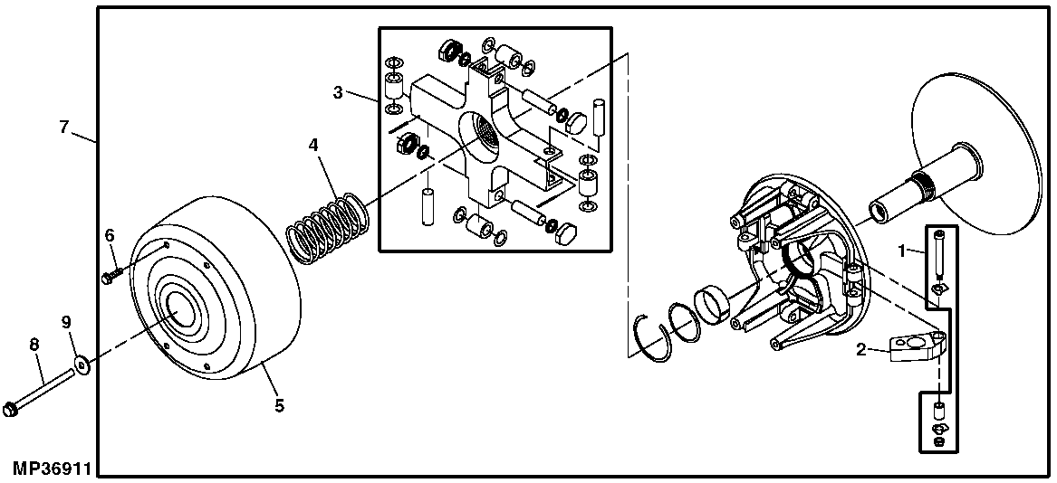

I have an 07 XUV Diesel that makes a noise as described. At first I thought it was just the engine. Coming from the clutch area. I didn't recall it being there when new. Notice it most at idle or low RPMs and goes away as you raise RPMs and speed. Almost sounds like a bunch of steel balls loose inside the clutch cover.

I am going to take it apart this weekend. Just to see. It might be normal... It might not.
Some of the noise i was getting was from a loose linkage and the parking brake. i added an extra washer to each, and it quited down drastically. I just have the little clutch noise. We will see.

Yeah, the sound is most apparent as a kind of clang, clang, clang... and sort of sounds link the thin metal of the drive clutch rubbing or touching something. it does go away under acceleration, but it there at different speeds. I figured it was normal, but when buying used at a steal, i have been working to make sure everything is perfect. i am still going to take it apart to see whats going on for a little more understanding.
   / Need Some help with new to me XUV Gator #18
I attached a pic of the clutch from Deere online parts page for XUV. Be interesting if you find anything loose in there.
Craig

LOL.. Tommy, this is not my first BBQ. I have mine narrowed down, and hope to have a fix for it today. Its not complicated. I was getting very little noise from the driven clutch. That was solved with some dry lube on the ears and a little cleaning.
The drive clutch is where I get some of the rattles. After taking it apart, I can see why these units last forever. BUT, the tolerances are not tight, so you get some rattling... I will put a few hours on it today and see.
