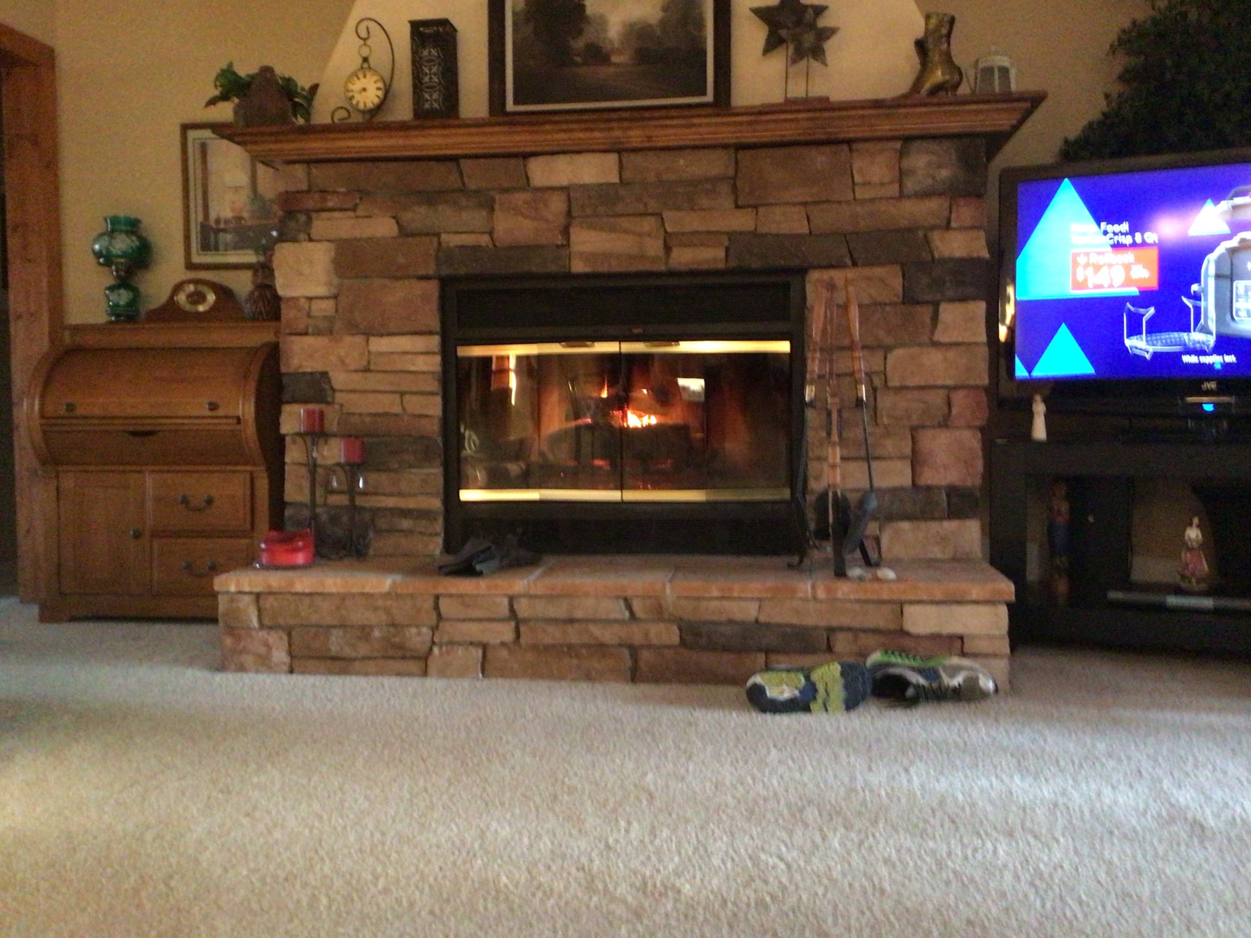

A picture of my setup. No way around it, if I knew than what I knew now. My setup isn’t bad for efficiency, it has an outside air source, it has a fan that pulls air around the box, so it’s not bad. What I regret is not getting air tight doors. It will do a decent job of heating the house until it starts getting down to single digits.
There is some value to the atmosphere and looks of a fireplace, it’s sort of the centerpiece in our living room.
/ Need some home heating feedback: Wood boiler or fireplace insert? #43
Our old fireplace looked similar but did not have outside air, so maybe it was older and not as good. It would make the house colder since it pulled lots of air from inside the house and cold air would leak in to replace it. Not much heat produced either. I stopped using it because it was so bad.
We replaced it five years ago with an EPA zero-clearance fireplace (basically a wood stove in a box that can touch the framing) and that is far more efficient and useful. We go through about 2.5 cords a year.
