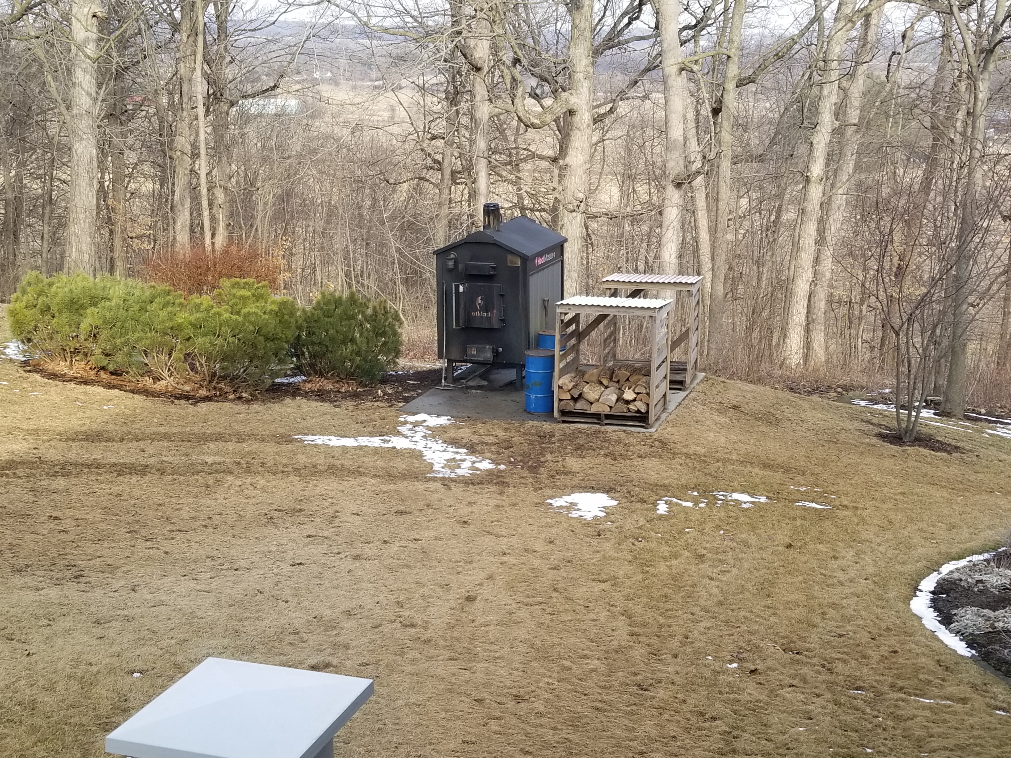

We built in 2016 and designed for an outdoor woodburner. I'm retired and still fit so the decision was pretty easy. We have woods, trees go down anyway that need to be removed. I used to give them to friends and coordinated that work; now we just process them ourselves.
The insurance company was particularly interested in the details of our system. Once they saw pictures, things relaxed. Later, our agent mentioned indoor burning with a central mounted or basement stove would have raised issues (like higher rates or even cancel). I'm in the country; my neighbors have all retrofitted inside wood stoves years ago. Guessing that never got mentioned to their agents.
I have a Heatmaster dealer in the area; he gave me names of local customers I could talk to before building. What I learned was that the installation is everything! MANY systems I saw were installed by techs that clearly had no clue; each customer raved about the unit but had a laundry list of issues in the house (pm me if you ever want to know what NOT to do). My contractor found a specialist that had done many outdoor burner installs. After 8 years of use... the kid really did know his stuff. Find the right guy!
Our wood burner heats the basement floor, forced air, hot water, and the garage floor of our 2100 sq ft home. There are different quality levels of the lines that run from the burner. The lines recommended to us were $1k just for a 100' run! That made the decision NOT to feed our shed (500' away) pretty easy. A friend added radiant heat coils under the 1st floor of his new home just the year before our build. That alone added $20k to his costs. No need. The basement heated to 68 makes the 1st floor warm and the space comfy... the forced air takes it from there.
The first few years.... we moved wood to the burner and restacked. That got old fast. About year 3, I built 'pods' that allowed me to bring wood from storage to the burner using the tractor.
Built over pallet bases, each pod holds 1/4 cord and is sized so my compact tractor can lift. We use 8 cords in the coldest years. 32 pods were built. They have been a godsend. Each Spring when we process wood, 2 pods are set at a time at the splitter and get loaded ONCE. We also know exactly how much we need to finish. Adding runners to the bottom and laying treated 2x4's at the storage area gets the pallets off the ground and prolongs their life. The pods still look like new after 6 years and have had few repairs.
I could go on and on... hopefully someone will find these ramblings useful! Good luck!

I'm a little confused, do you have some sort of radiant heat or do you just rely on the heat from the basement rising to the living area?
Let me elaborate. First, there is no 'wasted heat' with an outdoor woodburner. It makes so much energy that you point it where you want and use what you can. My point was this: putting coils in concrete is cheap compared to securing under/into the first floor. We have hardwood floors on the main floor as well so heating those areas is particularly sketchy. Yes, our basement is finished. Heated concrete does limit flooring choices. We have commercial vinyl/concrete in my wood shop. Keeping the basement warm very much helps on the main floor. It is heated with forced air (only the furnace fan runs though; a liquid-to-air heat exchanger in the plenum is hot 24/7 from the wood burner.) LP burners in the furnace kick on as backup.
Your "pod" method of transporting/storing firewood is interesting, but looks like a lot of work. Is it safe to assume that it's easy to transfer these pods from where you store them to somewhere easily accessible to the house?
The initial work of building the pods was noteworthy. I built 3/week; 32 in all at a cost of $500. The ability to move them to wherever the splitter is to process is huge. Sometimes that's in the woods if the tree is too big for me to skid. No biggy. We usually process in our front pasture where the log pile is. We also try and have all the pods filled before Easter to burn the following year. Seasoned wood keeps the burner running clean without issue. The pic above shows the pods as staged from the splitter but before being set for storage. That is about 100 yards from the burner. Our system uses two pods/week.
Yes, once a week I fire up the tractor, snag the rear forks, and swap out 2 pods. Compared to handling the wood like we used to.... IT IS EASY! ;<)
