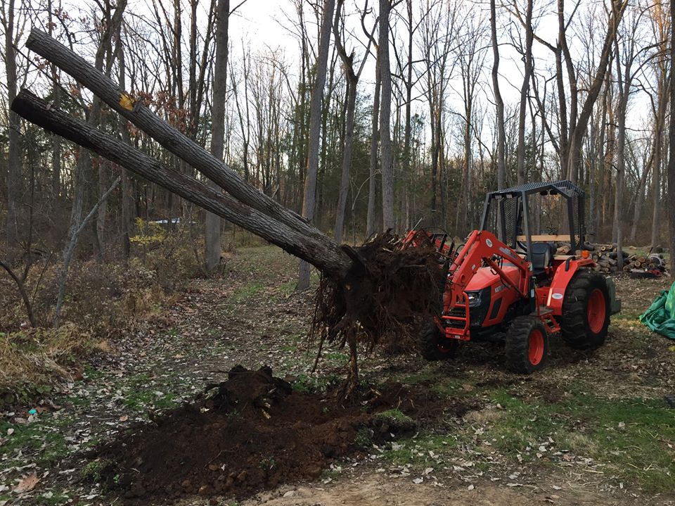

/ Need some input on a new tractor... #16
I also agree that you are better off renting or hiring out for your sump removal and going without the backhoe on the tractor and using those funds to go bigger or get implements that you will use to maintain the property.
I moved onto 2 acres with ~1.5 that needed clearing / landscaping. I chipped away at it for years with a 20 hp tractor that weighed ~4000 pounds with loader, brush cage filled tires and me. It was marginally heavy enough for landscaping with the bucket but did not have enough hydraulic power.
I later went to a 45 hp tractor that is ~6500 pounds but with ~3x the loader lift capacity and ~5x the curl force on the loader. This second tractor seems very appropriate for the landscaping and occasional tree removal / stump removal / rock removal that I do with it.
If you do have an occasional stump to remove, a 40-60 hp tractor with a set of heavy duty forks is actually a decent tool for ripping out trees and forks are useful for lots of other things and are not expensive. A stump bucket is also inexpensive and can dig footers, trenches, and also remove trees / stumps. I wouldn't remove an acre of woods this way but for the occasional stump after the main area is cleared these methods work fine. Below are some pictures of what you can do with forks and a stump bucket. I'm always using them and they aren't a lot of money.
Stump bucket removing tree.jpgdigging with forks.jpgStump bucket footer hole.jpgtractor with tree.jpg
