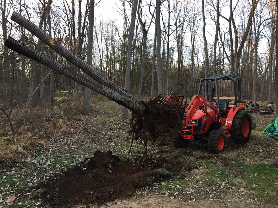

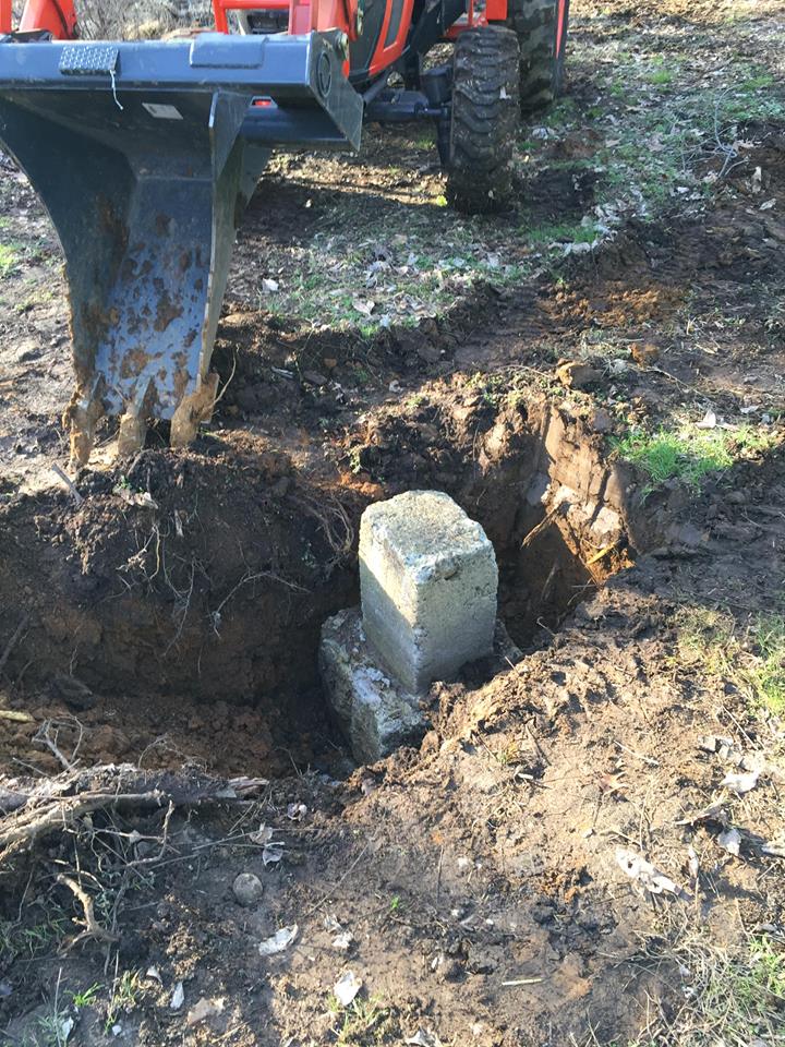

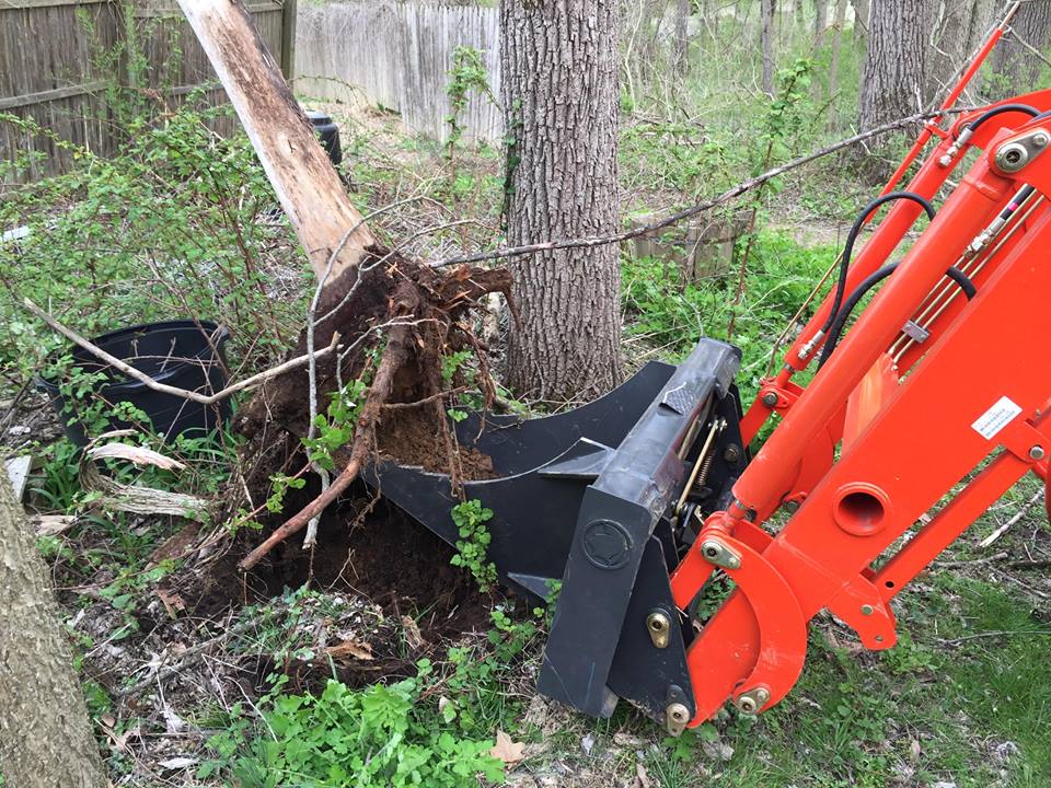

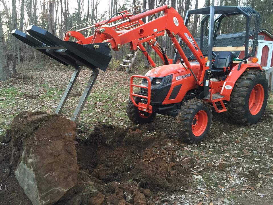

If you do have an occasional stump to remove, a 40-60 hp tractor with a set of heavy duty forks is actually a decent tool for ripping out trees and forks are useful for lots of other things and are not expensive. A stump bucket is also inexpensive and can dig footers, trenches, and also remove trees / stumps. I wouldn't remove an acre of woods this way but for the occasional stump after the main area is cleared these methods work fine. Below are some pictures of what you can do with forks and a stump bucket. I'm always using them and they aren't a lot of money.
