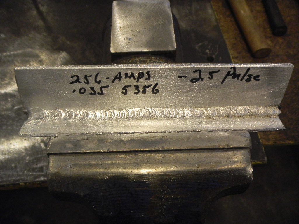

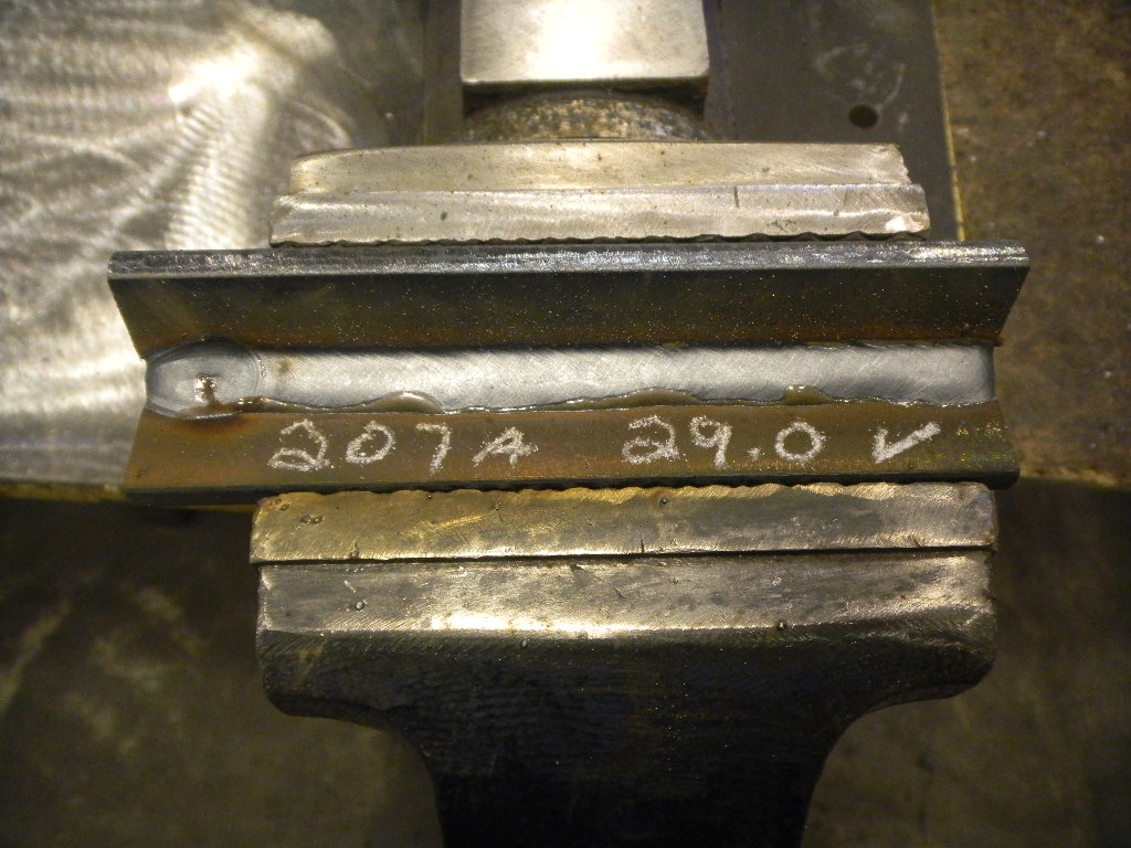

I've heard nothing but good things about Miller's 350P. My Invertec V350-Pro is the pulse version. Here is what it will do with spray, and pulsed Mig aluminum with the spool gun.
