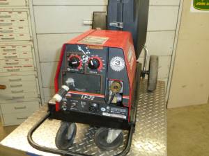

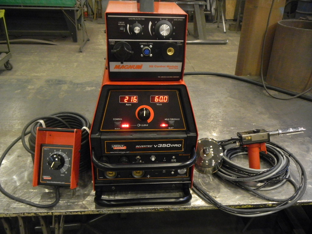

   / Need TIG machine purchase advice #28
