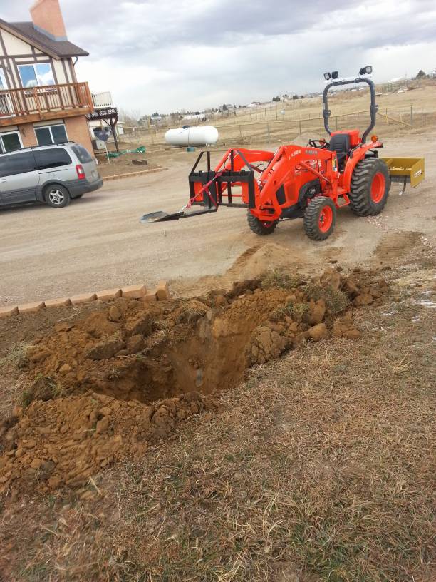

I have the Paulmco one from Northern Tool. Mine is the pallet forks mount one h was under $200 a few years back. It works ok. I've dug a few live Christmas tree holes & a downspout drain trench with it.
The L4060 runs is better than the L3200 did. But that's kind of Duh! 5k lbs vs 2.5k. The L3200 did ok & took 15 minutes or so to dig that hole in the picture in clay. If it's anything more than that small hole I'm borrowing a friends backhoe or $350 a day to rent a mini-ex from Home Depot. Not selling the bucket spade, but dont use it much either.IMG_20131224_130200.jpg
   / Need to build a clamp on blade for my loader for digging short trenches and holes to #16
The L4060 runs is better than the L3200 did. But that's kind of Duh! 5k lbs vs 2.5k. The L3200 did ok & took 15 minutes or so to dig that hole in the picture in clay. If it's anything more than that small hole I'm borrowing a friends backhoe or $350 a day to rent a mini-ex from Home Depot. Not selling the bucket spade, but dont use it much either.View attachment 615682
That one out there on those forks will dig quite a bit deeper than mine on the bucket. Of course it all depends on what you have for "dirt". I don't have any.. :)
