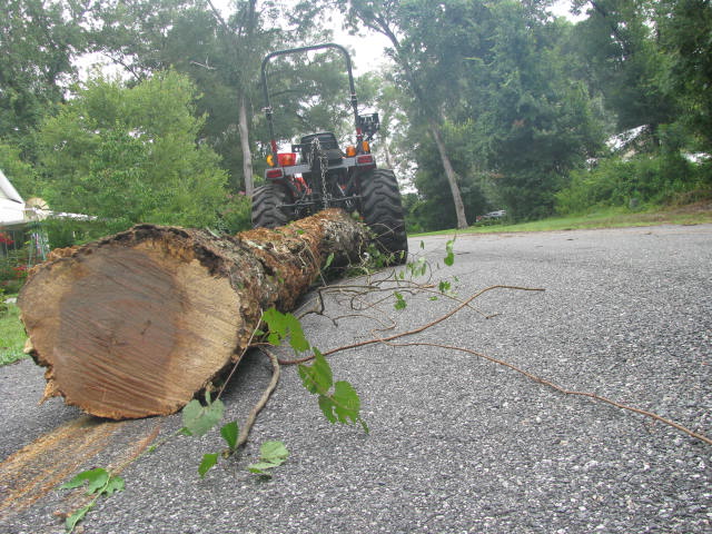

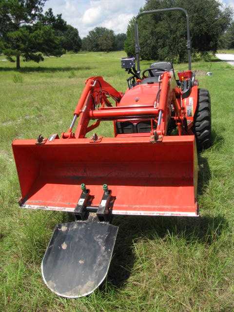

   / Need to buy a tractor, am newbie #6

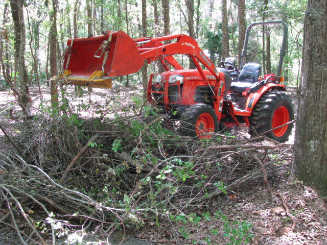

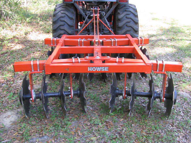

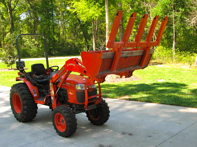

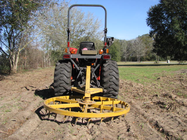

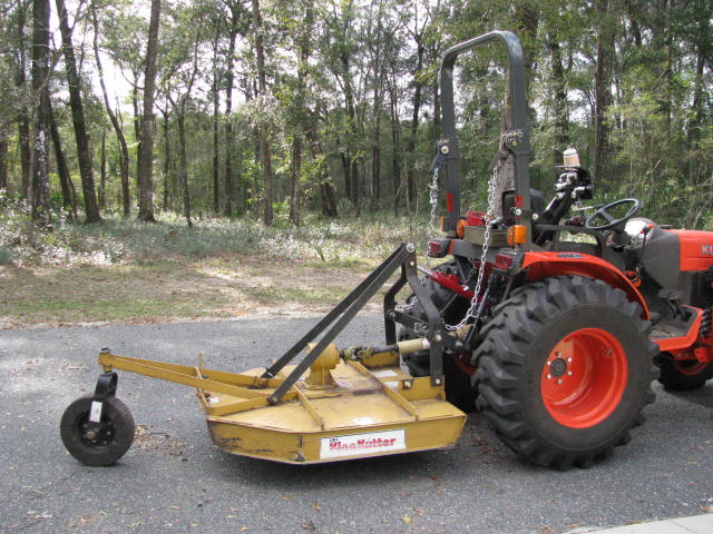

Your basic tractor is a prime mover with a 3-Point Hitch on the rear, an INDUSTRY STANDARDIZED attachment point for pulled implements. The 3-Pt. Hitch is what makes tractors so versatile. Bush Hog is one example of an implement that mounts on the 3-Pt. Hitch. The 3-Pt. Hitch is hydraulically operated. It lifts implements. Gravity lets them down. The 3-Pt. Hitch has a Power Take Off (PTO), which powers some implements, such as the Bush Hog's rotating blade.
The most useful single tractor option is a front end loader (FEL). This is usually ordered with further tractor options: Hydrostatic Transmission (HST), four wheel drive (4-WD) and industrial tires (R4 tires).
Backhoes have a support mount that covers the 3-Pt. Hitch, so backhoe must be removed before 3-Pt. Hitch is available for an implement. Backhoe removal/replacement can be awkward and time consuming. Tractor newbies often feel they need a backhoe but backhoes are specialized equipment. Unless you have a LOT of trenching to do or a LOT of stumps to remove you can do occasional work with a more versatile 3-Pt. implement.
If 85+% of T-B-N writers have FELs, perhaps 10% have backhoes and half of the 10% with backhoes wish they had allocated the backhoe $$$ toward three $ implements.
Both Kubota L3800 and L3940, with optional FELs, are appropriately sized to accomplish real work in reasonable time on 22 acres.
B3300SU in photos is 1,900 pounds. L3800 with FEL 3,100 pounds. L3940 with FEL 3,900 pounds. ((+/-))
Buy all the tractor you can afford, with FEL, but understand tractor/loader won't accomplish much without pulled implements.

Thanks for the pics.
Your basic tractor is a prime mover with a standard 3-Point Hitch on the rear, an INDUSTRY STANDARDIZED attachment point for pulled implements. The 3-Pt. Hitch is what makes tractors so versatile. Bush Hog is one example of an implement that mounts on the 3-Pt. Hitch. The 3-Pt. Hitch is hydraulically operated. It lifts implements. Gravity lets them down. The 3-Pt. Hitch has a Power Take Off (PTO), which powers some implements, such as the Bush Hog's rotating blade.
Backhoes have a framework that cover the 3-Pt. Hitch, so backhoe must be removed before 3-Pt. Hitch is available for an implement. Backhoe removal/replacement can be awkward and time consuming. Tractor newbies often feel they need a backhoe but backhoes are specialized equipment. Unless you have a LOT of trenching to do or a LOT of stumps to remove you likely can do occasional work with a more versatile 3-Pt. implement.
If 85+% of T-B-N writers have FELs, perhaps 10% have backhoes and half of the 10% with backhoes wish they had allocated the money toward an implement(s).
