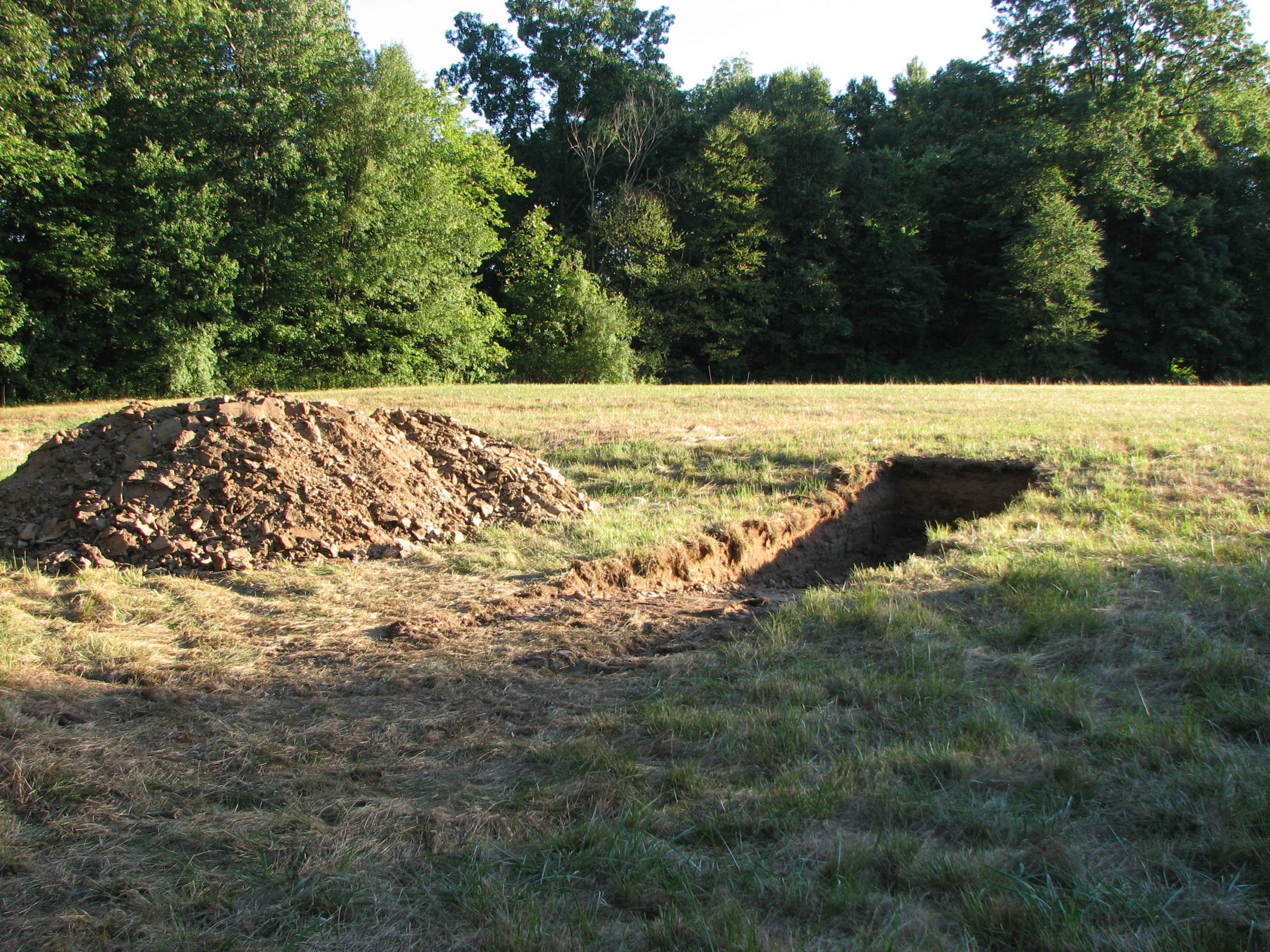

I do a lot of excavating with my the loader on my little B3200, so it's very doable. Generally I'm cutting and filling a spot to make a level building site, but digging a hole isn't much different. I like to peel off thin layers of soil until the bucket is full, then lift the bucket just enough so it quits digging. Then I just continue pushing the soil along the surface (you can push more cu. ft. than your bucket will hold.) until I get where I want to pile it. If it's a long distance then I will pick it up and carry it. Using a box blade in tandem with the FEL will make something like this go much faster, plus the scarifiers are great for loosing the soil, even if you have a tooth bar.
I excavated this round pen using this method:
[/IMG]
Actual excavating took 14hrs, moved about 115 cu. yards.

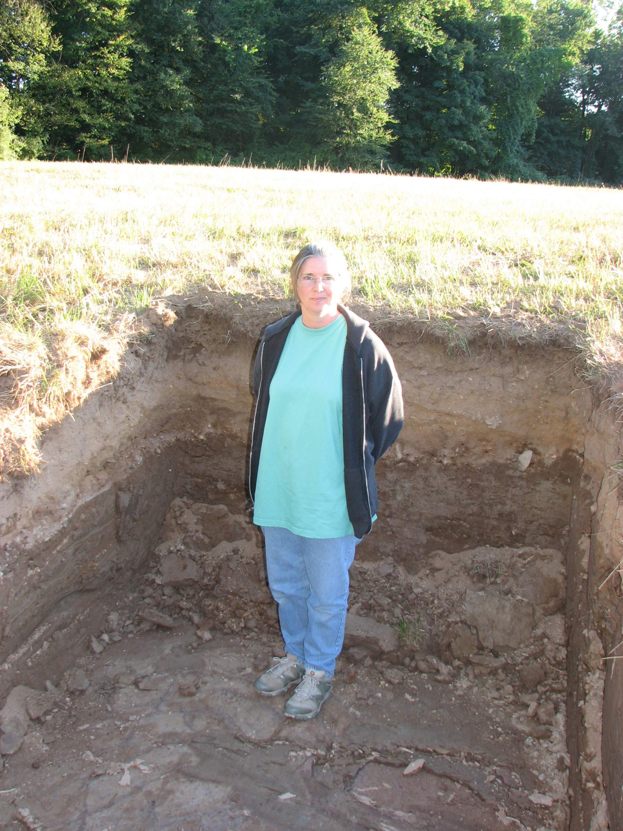

To do this you will want something heavy on the back end that isn't as wide as your FEL or wheels (whichever is wider). This is what a ballast box is made for! I dug this using FEL with cutting edge but no toothbar and my brush hog cutter for ballast. The cutter hung out way too far, which made turning a pain, but I didn't have any better options at the time. As I dug deeper into the clay it got wetter and slicker, so traction to cut with the FEL was greatly reduced - that's why you'll want plenty of ballast. The trench is about 30' long; the Plant Manager is about 5'7" for scale.
-Jim
